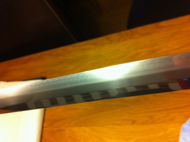

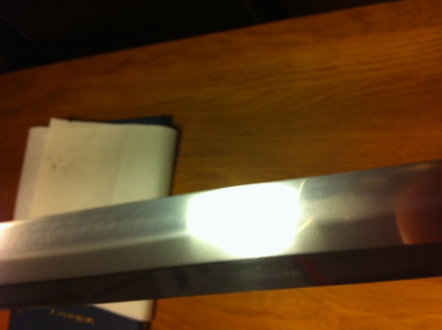

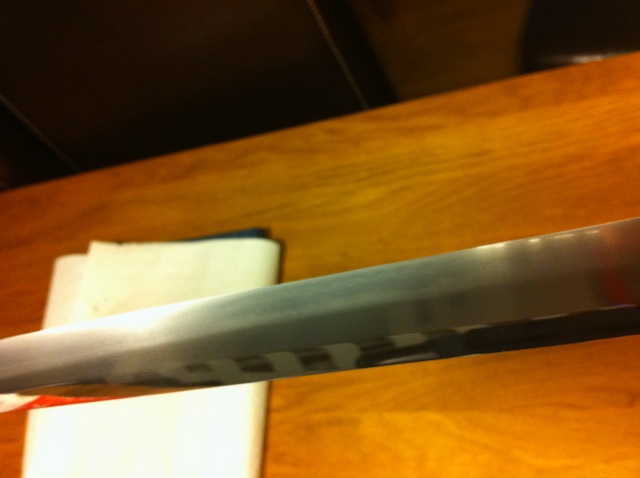

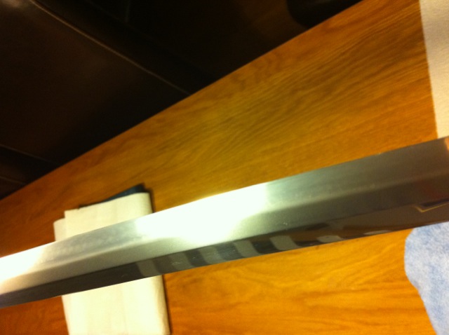

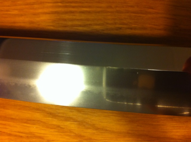

Daniel Posted May 24, 2013 Report Posted May 24, 2013 Hi I have a showato(at least I think it is) with what appears to be hataraki in the Hamon. They look almost like prints from a tyre. What are this kind of Hataraki called and isn´t it unusual with these activities on showato. Excuse my very bad photos, I snapped a few with the sword in one hand and the phone in the other not ideal I know. Kind Regards Daniel Quote

Daniel Posted May 25, 2013 Author Report Posted May 25, 2013 Brian thank you for your generous offer but I think you understand my confusion about what to call it. If it's not showato it has to be gendaito or maybe a shendaito :-) What do you think of the Tyre like hataraki, what is it called? I can understand as Chris said you need better pics but I think you can see the activites in the admittedly bad photos although they show much better in reality. I guess it's time to buy a good camera soon. Regards Daniel Quote
cabowen Posted May 25, 2013 Report Posted May 25, 2013 Based on the info I received, it is most likely made using western steel, which means it is non-traditional. It is possible to get ashi and a thick nioi-guchi with western steel and an oil quench which is what I think I see here. I can't be certain, as I said, because of the quality of the photos. It may be water quenched, but it is still a non-traditionally made blade if it was made with western steel. How much nie do you see? If you see plenty of nie and a clear hada, then it is probably not a showa-to. Quote
