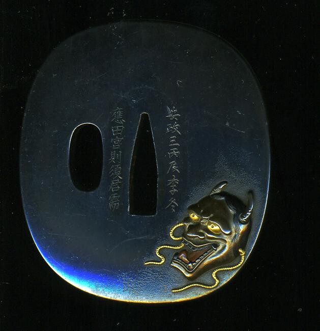

Seem to remember some discussion a few weeks back concerning wood/leather etc. tsubas , but I cannot find the topic .
Hope this is of some interest.
Bob M
Nice tsuba.
I cannot see the signature clearly, but it lookes to be a commissioned piece. Have you the translation, or the name of the maker?
Understand the tsuba to be by Momoe at age 63 in autumn 1860 (Manen 1) - any other info. would be very useful .
I have attached a closer (clearer ? ) image.
Thanks for the interest.
Bob
Dear Bob,
I do not think I can add anything to what you already know about this tsuba. While I can read an acceptable bit of the writing, I cannot recognize the signature yet. I tried looking up Momoe in Haynes and found no match. Could it be a retirement name (taken at the age of 63)? Nice little challenge!
I sold the majority of my tsubas to pay for another purchase. ~I let a few go that I wish I had been able to keep. Anyhow, one of the few I decided to keep was this one . A listmember helped translate it as "Late winter in 1856. Responding to Mr. Tamiya Norimochi’s order" with the tsuba smith's signature on the back of the tsuba.
I've seen a spat of these tsuba signed and dated as commissioned pieces. Nearly all that I have seen do seem to be from 1850<->1865. Yours is the first I've seen done by makie, and the first on which the smith has given his age.
If I can figure anything out, I'll post or email it to you.
Thanks for posting the tsuba you have so far. I look forward to whatever more you choose to share with the list.
CCC

Hi Curran,
Thanks for your interest/help - much appreciated.
I like your posted tsuba very much .The quality of work is really good and that is one of the things that I look for initially in the swords and tsubas that I collect.
My taste is rather eclectic and so I go for anything that I like without regard to age or particular field . Having said that , the 'unusual' is (as you can probably see from the posted tsubas ) always an attraction.
Will try to post a few more items over the coming weeks.....
Bob
The name could be pronounced as "Toko (桃江) or Toukou". :idea:

Hi Everybody ,
I was looking at this piece again the other day , and recalled this thread . Can't believe it's been over six years !!
Just wondered if any of the newer members of the board would have any ideas / input regarding if the tsuba was a commission and if the artist Momoe is recorded .
Thanks !
