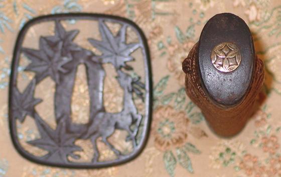

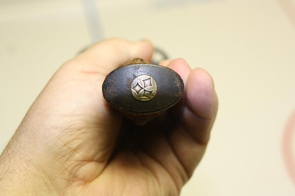

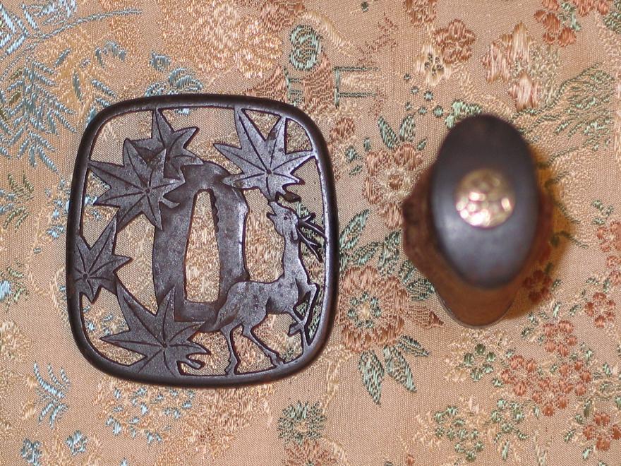

What crest / Mon do you think it is.

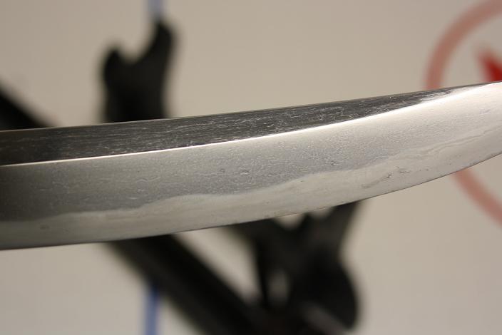

What were you told about it by the seller? My initial reaction looking at the sunagashi and masame running in to the hamon is that it has a lot in common with some Yamato shikkaki pieces I have seen. Taake a close look at the boshi and see if there are lines of nie running through it. You are looking for an effect like"an old mans beard". Hada looks good good. One note of caution is waht looks like an opening in the hamon towards the kissaki.
As always depends what you bought it as and how much it cost you and of course are you pleased with it. but overall I think the blade looks good.
Edit: looked again at the pictures and notice there appears to be a strong turn back on the boshi which is unusual in a naginata naoshi as the turn back is usually lost when the blade is reshaped. Interested in others view but is this possible a wakazashi made to look like a naginata naoshi? if so why would the maker do something so obviously strange as put a return on the boshi?

looking at the hamon is there a lot of nie running through it? I can tell from the images but that would be a significant factor in anty attribution

@ Paul on the boshi, it looks like there are lines of nie running through it, the hada is present throughout the blade and really nice.

I think you did well on this one. I like the shape and the hada. The reason you thought it was a cut down naginata is that the shape Jacques describes was, I think, produced to some extent to imitate just that. I have attached below an image of a Naginata naoshi. This dates from the mid 14th century. You will see the naiginata hi and the fact that the boshi has no return.

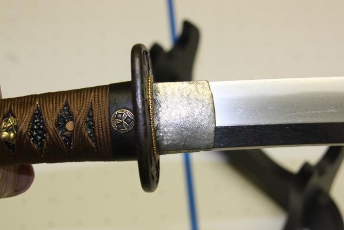

Nice one. Very appealing look, seems to a good strong blade (with a minor opening, nothing serious imo). This is what I see:
- blade has nice hamon, hada, polish and polishers signature. very thick and VERY wide. Great!
- descent koshirae (mounting)
- fuchi/kashira with mon that matches
- nice habaki and tsuba.
From the pictures - I do not think the saya with the handachi style fittings matches tsuka and its fittings - usually f/k will be same style. The kodzuka I dont think matches rest of fittings either, but nice old kodzuka anyways! Wrap and same seems to be new, so does sageo indeed and I have hard telling from the pictures if menuki is of newer date also.
Just to say this way, its very common to find swords and koshirae that is composed with different parts and you should always pay attention and be able to look at a sword and its koshirae and make a statement of this. The more complete, the higher value. Just to give you a good advise on the way :)
About blade, I just had the thought if it could it be a nagamaki blade, rather than a Naginata Naoshi or wakizashi made in naginata style?
With above said, nothing to worry about. I think its a very nice sword you have got there - I like it, the shape and width of blade and like the mon's on f/k - and you have really done improvement in short time. Congratulations Brian.

In fact, the picture does not really shows anything concerning the hamon. the fact that it seems to end after the hamachi is neither complete nor conclusive (All of you Guys, you should really read E.E. Doc Smith's Lensman series), here is a picture of my Tametsugu taken by Darcy, O suriage mumei. As shown in the picture the hamon seems to stop after entering the nakago.

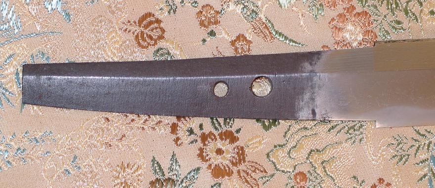

In your books, Jacques, how many sue koto schools or shinto schools have both features: Nakago: Kiri Jiri and Kiri yasurime, these couple with the hada description? Here I play the odds :)
More pics of the Boshi, and the Kissaki, and file marks on the Nakago, and the Hamon running all the way down into it also.
I did notice that the Seppa's are gold foil covered, really nice to know that also.

I think this one will yield some very historical value since it looks like by the MON / crest on it, it has some interesting history , with a great battle lineage.
Unless there is actual documentary evidence to link the Koshirae with the blade, no connection with either the Kamon, its previous owner and the history of the blade can be confirmed.
So whilst it is fine to speculate on the past history of an item, it can only be speculation.
That's where the Gunto with a Kamon on the kabutogane is relatively reasonable to relate to its previous owner.
The rules on the use of Kamon were becoming slightly relaxed by the end of the Bakumatsu.
By the time you get into Meiji Jidai (1868 - 1912) the situation regarding Kamon is quite free.

You are perhaps right about this, Jacques, taking into account these new pictures, but I am very wary as polishers are very good at hadori window dressing.
Edit to add: After discussing the blade by PM with Jacques, there is an other hypothesis which is the following, it could be a shinshinto blade made to look like a koto suriage blade. This is possible as it has been done at this time for a lot of blades, but all blades I have seen generally (at more than 95%) were cut down tachi copy. What will be the interest to do it for wakizashi which were not so much prized? Of course it could have been done for export purposes.

No one has answered your question about the value in relation to the mon. I think unless you have a documented connection with a daimyo family then the use of a mon is not significant, unless the koshirae is of startlingly high quality. (Again, already covered, ah well!)

Jacques is absolutely right. The boshi has a kaeri, while cut down naginata have yakizume boshi.
This boshi does have a fairly normal looking turnback and it does not appear that it might have extended out more at one time.
A second point here is that each individual case must be determined independently as far as cut down naginata ending in a yakizume boshi, as there are exceptions. The same can be said for the shinogi being moved on naginata naoshi.
