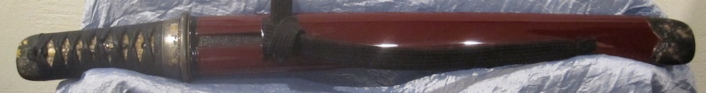

I am posting my family given sword for any knowledge on it. It is unsigned other than the many inscriptions on the Shira Saya, it has a gold foil 2 piece habaki with hi extending from the end of the nakago past the mitsukado. The blade is in old polish and had a bright hamon, mumei, a deep sori and 3 holes in the nakago and the length is 28".
I am working to get the inscriptions translated but have been told that is to old for some of the translators I have spoken to. What I have learned about it is listed above and from a close friend that has way more knowledge than myself. If anyone can help I would greatly appreciate it. I was going to take it to shinsa but the time came on me to soon to plan it. I still will take it when I can but in the mean time any help would be great. I posted the photos in the links below. Thanks in advance.
Steve
At a glance, I believe the saya gaki gives an owner's name and address, the length of the blade, an attribution to Soshu Yukimitsu, and a Showa date for the saya gaki with the name of the person attributing the blade (Honami Koson). I am sure someone else will fill in the blanks.

Thank you for your referenceing, I have friend who studies swords look at it and he placed the time of it's making in possibly the Koto period, it is a very elegant sword and feels very natural to hold. I know that my late uncle brought it back with him after the war but Im not sure of its origins before that. I will try to get better photos if I can. I take all comments and knowledge on this blade....
Steve M.
I don't think there is any doubt that it is a koto sword. It looks, at least as far as the pictures can take one, to be a good one. The blade should be well cared for and put through a shinsa as it may well be something quite valuable. There will be a US shinsa next year.
