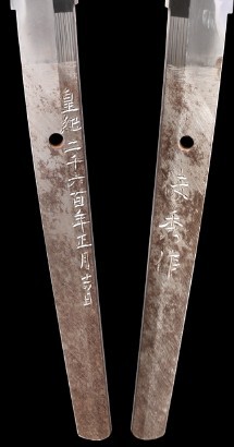

A while ago I couldn't resist to buying this remarkable item, a large yari-like blade which was mounted in an original naginata shaft with nice metal fittings. Obviously this is a later marriage as the shaft was not custom made for this nakago.
The blade machi to tip is 32 cm, at the widest nearly 7 cm and total length 58 cm. Thickness at the spine around 7 mm. As you might expect this thing is Heavy! At the tip the edge is blunt, about 1 mm thick. sides are thinner but still not razor sharp. Hamon is present in nioi, can't tell if there is hada in it's current condition but I wouldn't be surprised if it's there.
Then the inscriptions; on one side above the mekugi ana I see a date. Although the carving seems a bit sloppy/hastily done I think it says "MEIJI SANJU ICHI NEN ICHI GATSU", which should be 1898 first month.
Same side below the ana, province and smith: "OWARI JU XX XX TSUKURU"
Other side above the ana: well, here I'm lost (almost) completely. Very long shots, 2nd maybe Chi, 3rd Go? I don't know what construction to expect here because province, smith and date are already covered on the other side...I bet it won't be a cutting test :rotfl:

Are the readings that I do have right? What does the rest say?
And, ehhrm (this one is slightly embarrasing), what did I buy? Does the species have a name and how would it be mounted originally (naginata shaft looks fine though, that's not the issue)? It seems to be too well made to be an early tourist piece and the colour and yasuri on nakago seems to correspond with the inscribed date.

I have trouble with these choppy signatures, you've done well. Until some better help comes along, the one bit I was working on; 尾張連 ? 列 ? It might be an Association's name rather than smith name. :dunno: John

尾張連虎裂 – Owari no muraji, Koretsu (reading?)
明治卅一年一月 – January in 1898
為雅楽協會 – For Gagaku (=ceremonial court music of Japan) association
“Owari no muraji” seems to be a name of Kabane (姓).
