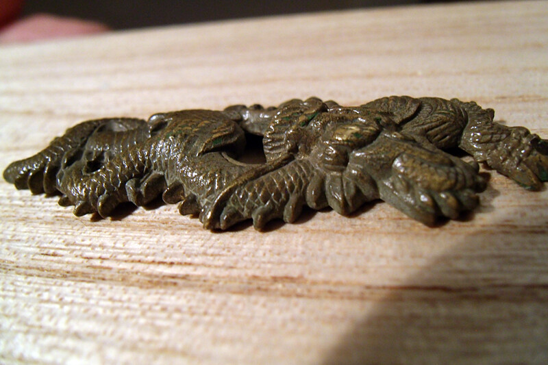

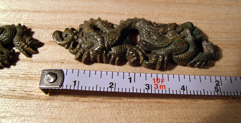

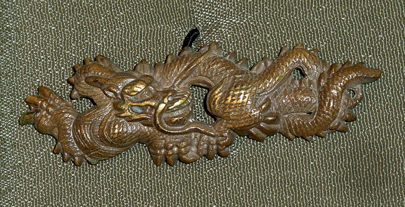

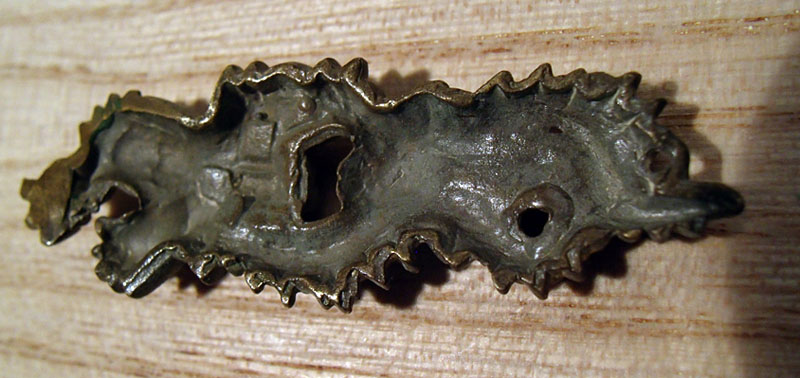

CurtisR Posted December 20, 2011 Report Posted December 20, 2011 I just purchased this pair at a pretty decent price(IMHO) - the seller stated he found them when stationed on Sakhalin Island in far Eastern Russia. I'm thinking they may be late Edo or early Meiji? No tool-marks, very heavy (brass, possibly) and nice detail in the scales, claws, etc. it seems. The second is more worn than the first, but not sure why that would be the case. Any thoughts would be appreciated (as well as critiques!) Thank you in advance, Curtis Quote
Peter Bleed Posted December 20, 2011 Report Posted December 20, 2011 This looks cast to me, but I would like to know more about being in Sakahalin after the War. Please tell us more about that. Peter Quote
CurtisR Posted December 20, 2011 Author Report Posted December 20, 2011 Peter, the seller was a diplomat for the U.S. stationed on the island in the early 70's from what he tells me. The lack of the posts on the back bothers me a bit, but the detail seems better than cast to my (admittedly novice) eye. I know that Japan & the USSR disputed ownership of the island for a long time. Other than that, not much story to go with them. Curt Quote
nagamaki - Franco Posted December 20, 2011 Report Posted December 20, 2011 This looks cast to me Seconded ..... Quote
Grey Doffin Posted December 21, 2011 Report Posted December 21, 2011 I also think cast. Picture 3306, showing the back, what's left of the post attachment appears to be of a piece with the menuki, not separate pieces soldered in place. The detail isn't good enough for carving; looks like a casting. Sorry. Grey Quote
Soshin Posted December 21, 2011 Report Posted December 21, 2011 Hi Curtis, The menuki look like a modern cast set. The overall detail is fairly poor and below even high quality cast sets I have seen more recently. They do have a interesting story attached to them. I would stop buying until you go to the Tampa show. Once you get there and see all of the reasonable and much better antique menuki out their you will quickly lose interest in such a set. Just some friendly advice take it or leave it. This reminds me I need to book my tickets for the show. Yours truly, David Stiles Quote
CurtisR Posted December 21, 2011 Author Report Posted December 21, 2011 Mr. Stiles and all, I agree - no more buying until I learn more. Getting ripped off stinks, even though the story is interesting . I appreciate the input from everyone and hey, if I put a trebble-hook on them they might make great Trout lures?? Thanks again! Curtis Quote
