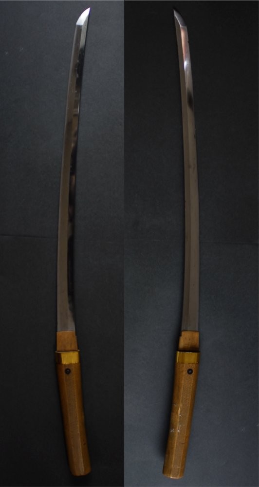

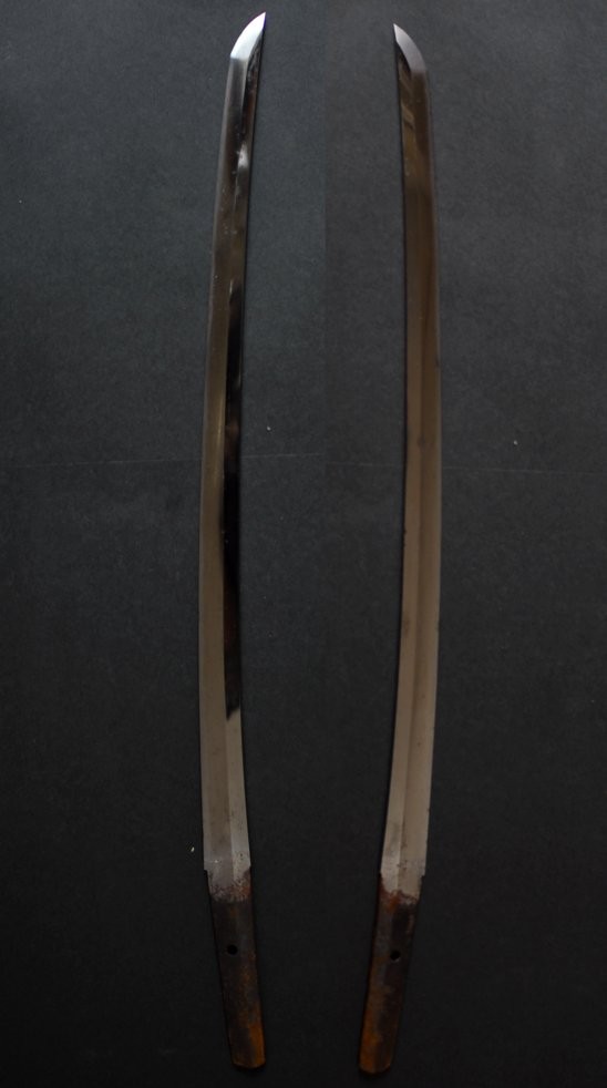

I just picked up this little wak and have a couple of questions. First I can't remember ever seeing active rust on top of old rust but since everything else I collect isn't prone to rust I just want an expert opinion. The second is the length of the nakago in relation to the nagasa. The nakago is 5" and the nagasa 20.75". The sori is 1.1cm. I'm only going to post the one pic here because I don't want to waste the boards bandwidth. I'll post the photobucket link and if it turns out to be worth discussing I'll go ahead and add the pics so they'll be around. http://s43.photobucket.com/albums/e382/ ... Wakizashi/

I think Steve might only be removing (stabilizing?) the active red rust on the nakago. If done carefully and non-abrasively, I don't think it is a huge problem. A bit of oil, maybe some careful ivory, and you can stop that active rust from doing damage. I don't see any active red rust on the blade itself.
Brian
???? Errmm, what Brian said is true. Though I'm not even using ivory but rather a wool cloth with choji oil and that only on the nakago. I'm only using uchiko and choji on the blade of course. I appreciate your concern and your passion though. I promise not to do anything like "polishing" or using a dremel or anything else insane.
In relation to your two questions: first, yes I have seen such rust on top of old rust...probably indicates humidity and resulting moisture in the wood shirasaya...probably hasn't been out and inspected/oiled for quite a while. You are handling it properly IMHO.
Second, the stubby nakago is not rare...see especially the nakago/blade nagasa relationship in the Bizen tradition. Your nakago seems to be an example of this. BTW, your blade has quite strong fumbari so IMHO, it is probably ubu nakago.
I stand to be corrected on all points of course.

Coming back to your questions - I think I see running masame in the blade or is it just the pictures? The hamon runs down to the edge in some places - the sword has seen many polishes.
It looks like a late koto, possibly an uchigatana? This could be a Bizen kazu-uchimono, given its shape, the fact that it is ubu but unsigned. I am, however, sceptical regarding the Bizen attribution - masame does not fit and the hamon seems to show Mino influence in some places. I might be wrong, though :-)
As to the fumbari - could you give us the moto-haba and saki-haba? Also, could you check how the nakago looks below the munemachi - do you see fresh rust and/or naked steel?

To answer one question though... mariuszk: There is active rust below the munemachi. As with most of the rest of the nakago there seems to be old black rust underneath it.
