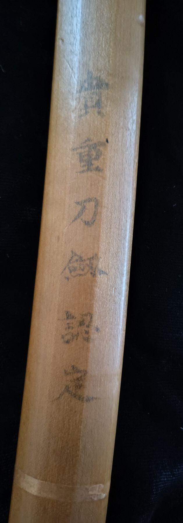

I have a Meiji era tachi by Yamana Tokiyoshi, which will be offered on my site. I need Romaji and translation of one piece of the sayagaki and a paper from, I'm told, Honami Nisshu. Much appreciated, Grey

Grey, I will attempt this. It is my first attempt so please forgive me. Others may correct me.
Scabard: 貴重刀剣認定 - Certified as a valuable sword.

Romagi reading and a little correction,
貴重刀劔認定 (Kicho token nintei)
