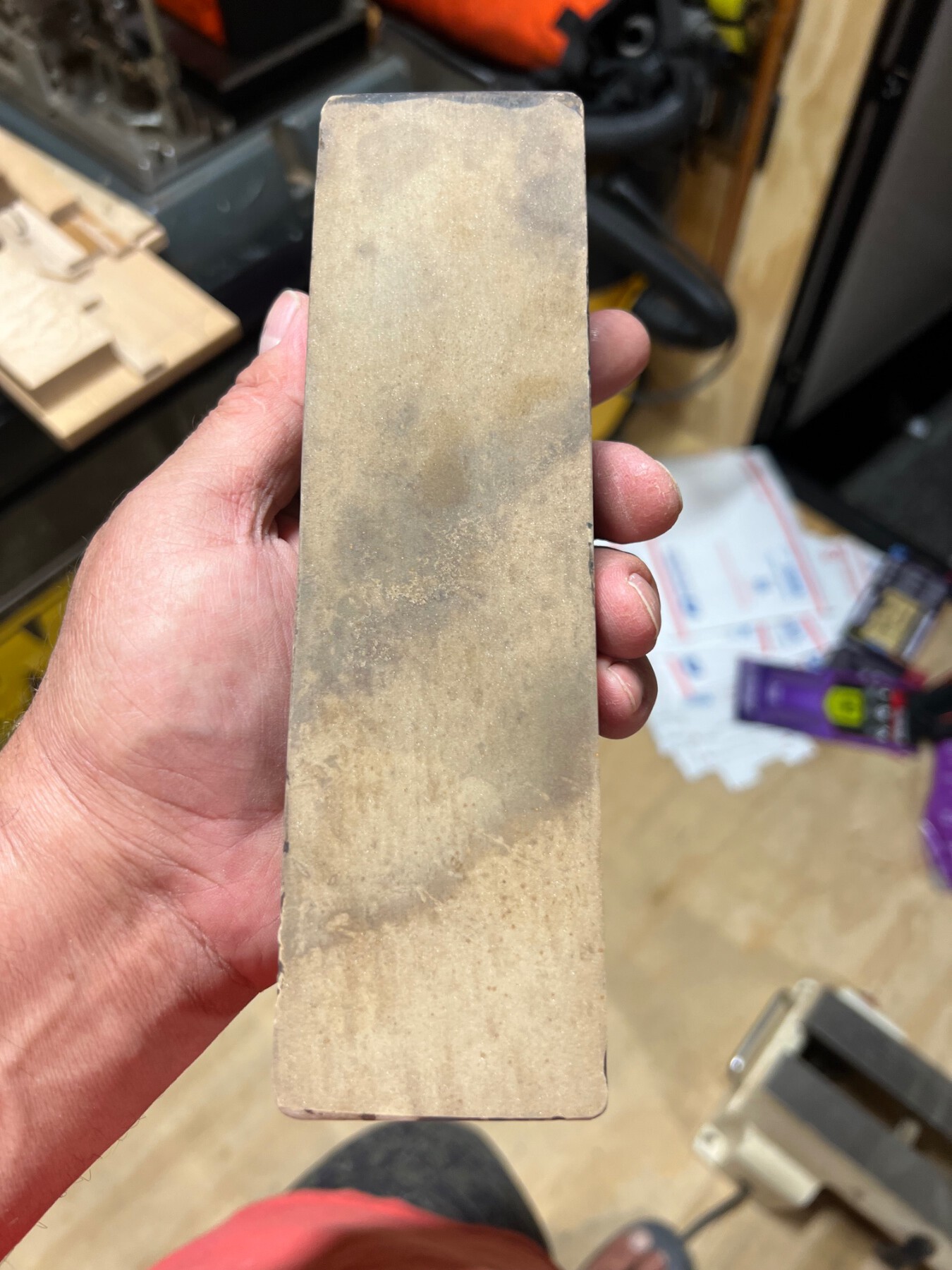

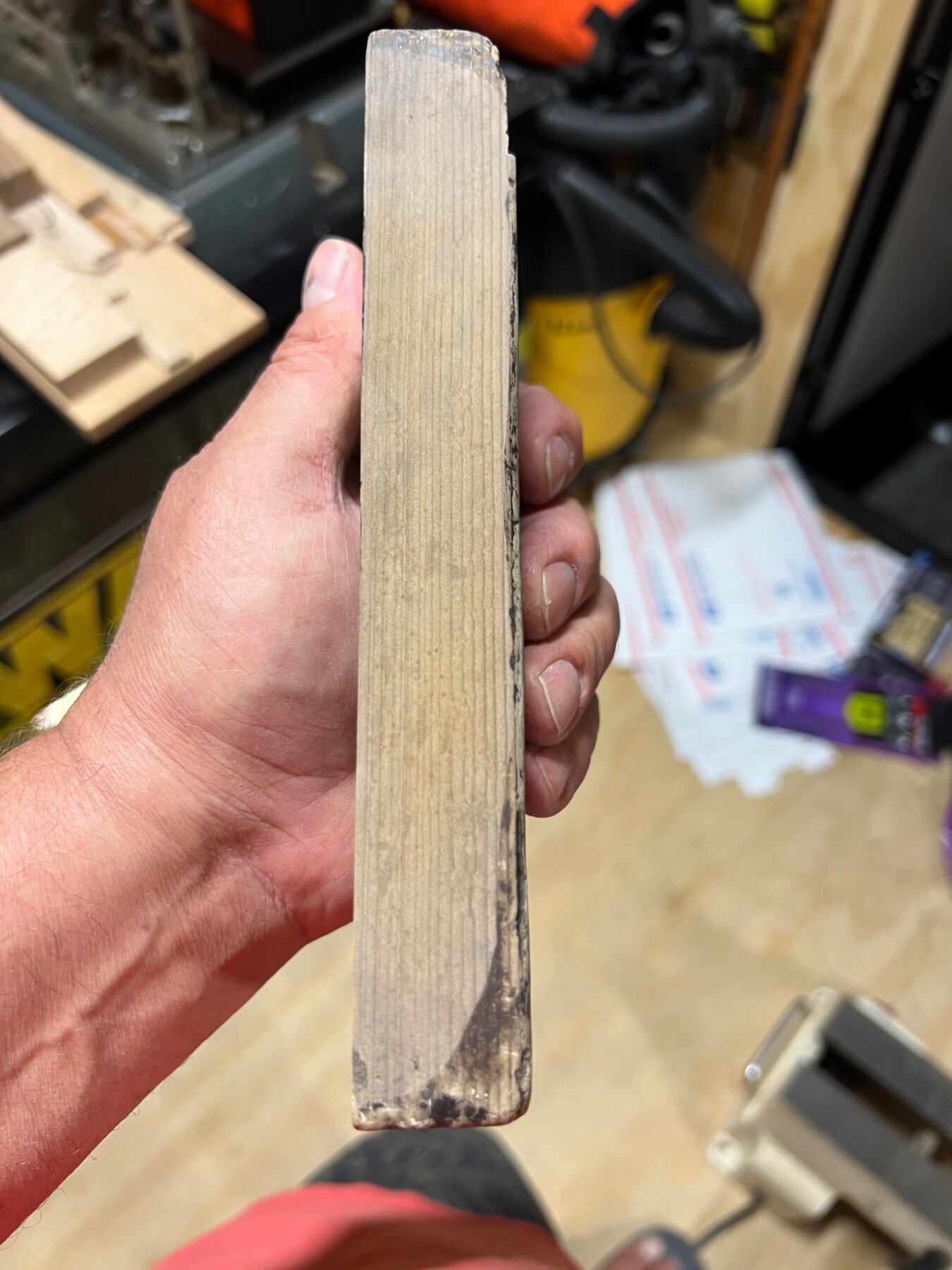

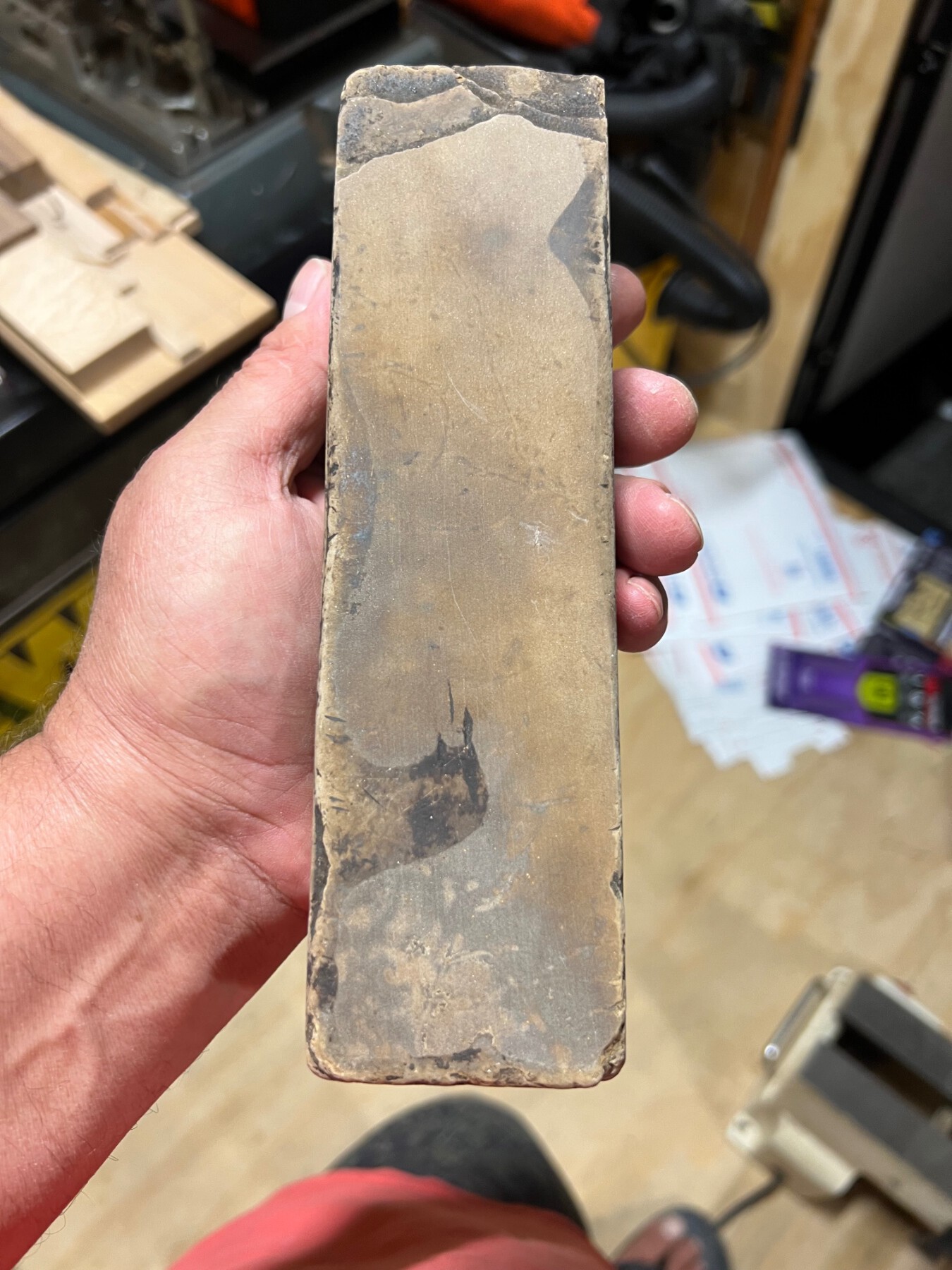

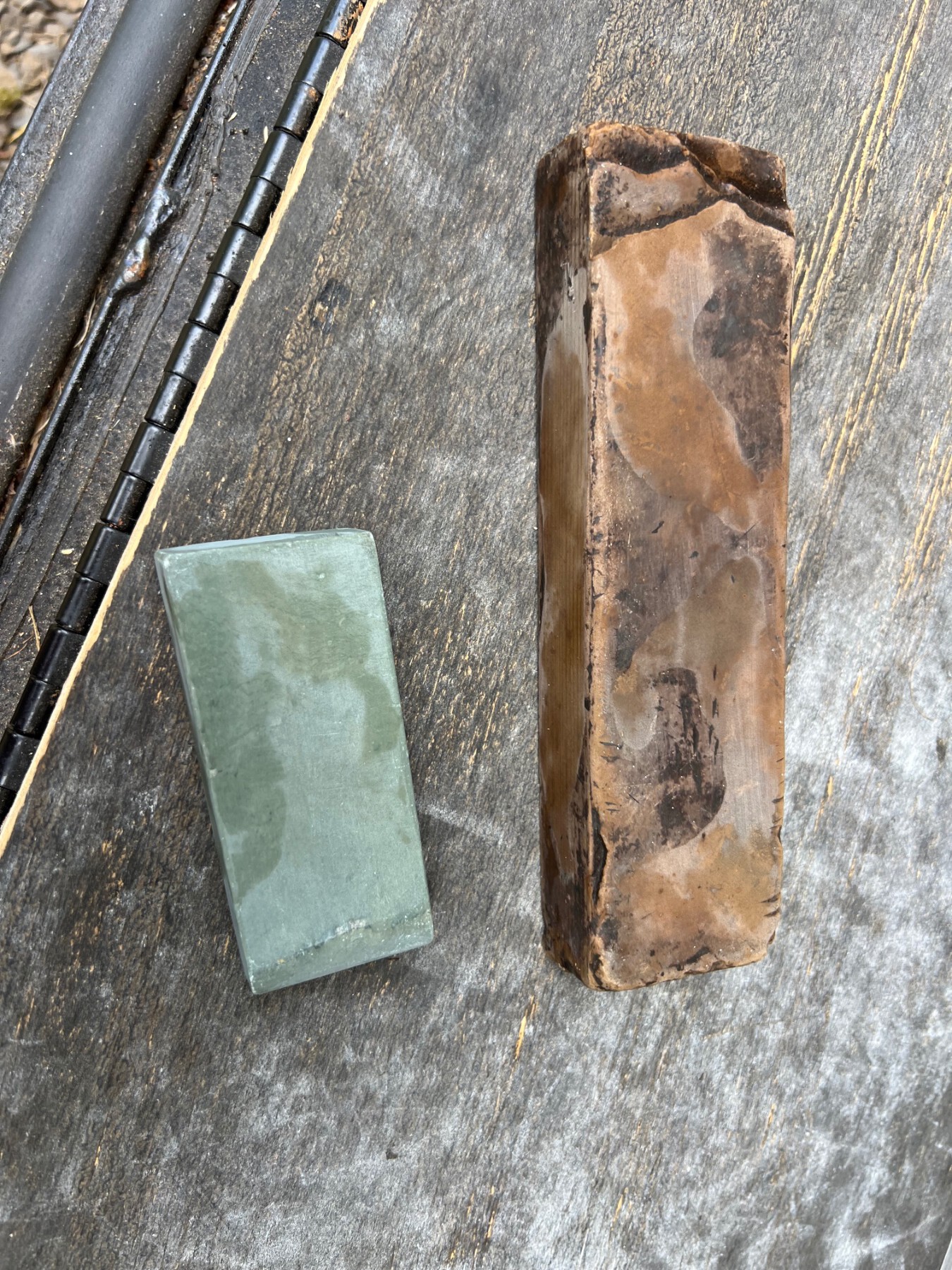

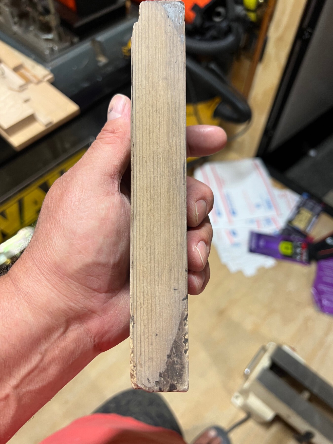

SKF Posted August 24 Report Posted August 24 I recently picked up these two stones and wanted to know if anybody can tell me about them Quote
Grey Doffin Posted August 24 Report Posted August 24 I know that these stones shouldn't be used to polish Japanese swords. Grey 1 1 Quote
ROKUJURO Posted August 24 Report Posted August 24 Steve, where have these stones been quarried? If they are not Japanese, it might be difficult to find out the provenience as grindimg stones are found all over the world. Green ones are a bit rare. In case these stones are not related to Japanese sword polishing, this thread should appear in the IZAKAYA I believe. 1 Quote
Tensho Posted August 25 Report Posted August 25 Not sure about the green one, but the other is a Hindostan. 1 Quote

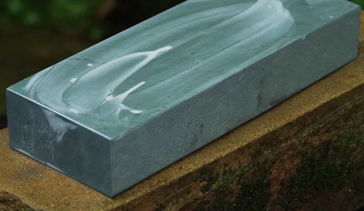

YourBabyBjornBorg Posted Tuesday at 03:06 AM Report Posted Tuesday at 03:06 AM That green one could be artificial or from China. The single largest natural wet stone product is a similar kind of homogeneous green stone at around 800~1000#. 1 Quote

SKF Posted Tuesday at 04:59 PM Author Report Posted Tuesday at 04:59 PM These stones were brought from Japan during World War II pass to my uncle and then to me. I just had hoped someone here had knowledge of their origin. My uncle told me the green one was used to flatten and correct the large one and create a slurry. I don’t mean to mislead or belittle anyone here just looking for info thank you. 2 2 Quote

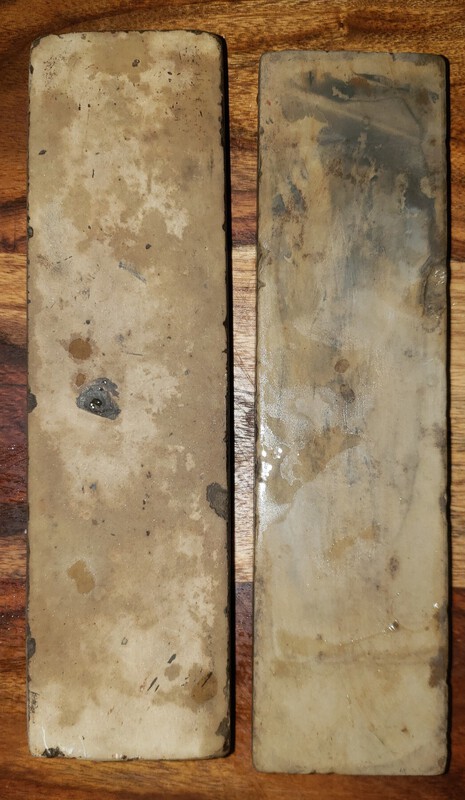

Tensho Posted Tuesday at 06:34 PM Report Posted Tuesday at 06:34 PM 1 hour ago, SKF said: These stones were brought from Japan during World War II pass to my uncle and then to me. I just had hoped someone here had knowledge of their origin. My uncle told me the green one was used to flatten and correct the large one and create a slurry. I don’t mean to mislead or belittle anyone here just looking for info thank you. Here's some of my hindostans. The striations are a classic indicator of them and why I believe it is one. The 2 on the far right and the separate picture haven't been cleaned and still have old oil and grime. It looks like yours has been used with oil as well. What is the size? "Most" American stones fall within the 2x8×1/1.5 inch range. 1 Quote
ROKUJURO Posted Tuesday at 09:21 PM Report Posted Tuesday at 09:21 PM Many old grinding stones have been "killed" by using them with oil. As a general rule, all porous stones should be used with water. Stones that are so dense that water does not penetrate (like fine Arkansas types) should not be used with oil but only with low viscosity petroleum or lamp oil. Grinding stones that have been used with lubricating oil can in many cases be "revived" by cooking them with laundry detergent. Quote
ROKUJURO Posted Tuesday at 09:31 PM Report Posted Tuesday at 09:31 PM 4 hours ago, SKF said: These stones were brought from Japan during World War II, passed to my uncle and then to me. I just had hoped someone here had knowledge of their origin. My uncle told me the green one was used to flatten and correct, the large one to create a slurry. I don’t mean to mislead or belittle anyone here just looking for info. Thank you. Steve, you may well use your stones for woodworking tools or carbon-steel knives. As usual, you have to test them for their effect which depends mostly on the grain size. Generally, natural Japanese stones are soft and are best used for flat grinding. Never use them with oil! Quote
