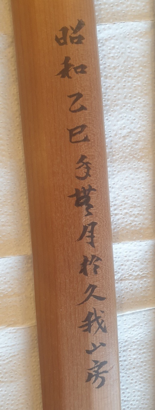

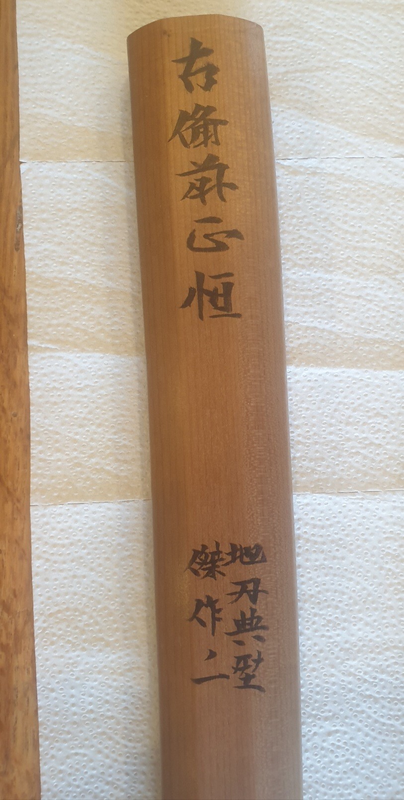

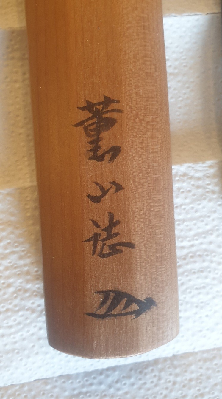

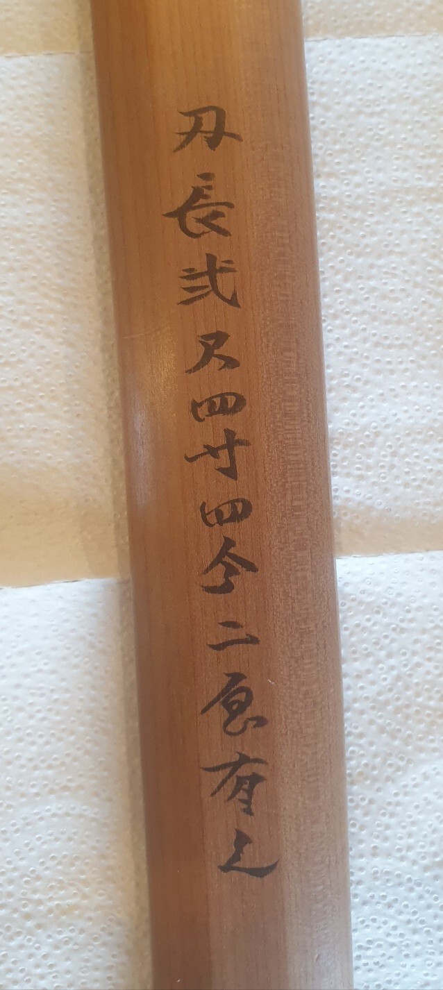

I have a sword in my collection that could be Ko-Bizen but is not papered. I am always a little sceptical about it because of the shallow sori and the weight proportions but at the end it is a good blade. It has a interesting sayagaki so maybe one can help me with the translation.
Thank you 20260816_100543.thumb.jpg.a0c0a86c594929ece189be13d48cb587.jpg20260816_100615.thumb.jpg.267bee37108281db6b342447d2750075.jpg20260816_100640.thumb.jpg.33414e39198f88e584c0c4ab82b3db25.jpg20260816_100700.thumb.jpg.04bac05574e9af805cdcfd1b8a583fb2.jpg
Christian
Hi! I think this is
古備前正恒 地刃典型 傑作ノ一 刃長弐寸四尺四分二厘有之 昭和乙巳年葉(?)月於久我山房 薫山誌(花押)
Ko-Bizen Masatsune, classic/typical Jiba(Jigane and Hamon), one of his masterpieces, Hacho/length at 2 Sun 4 Syaku 4 Fun 2 Rin (70.72cm), 8th(?) month, 1965, at (his) house in Kugayama, recorded by Kunzan (Kao)

1 hour ago, YourBabyBjornBorg said:
I'm not sure if the 8th month is correct...
You are correct for the month.
葉月 (Hazuki) - 8th month
And a little correction,
四分 - Shi (4)-bu (分 reads "bu" in the context.)
  • Like 5
Great, thank you for the fast replies! As the sori is just 0.6cm, could this come from the O-suriage? Or is this a hint that the sword is from a newer age and the sayagaki is not authentic?
