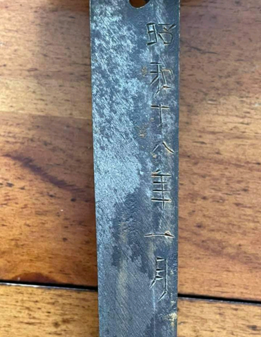

John John Posted August 9 Report Posted August 9 I have this type 3 Shin Gunto, and I am hoping that someone can interpret the marking on the tang please. I beleve it may be from 1945 and made by the railways from spring steel. Quote
Bruce Pennington Posted August 9 Report Posted August 9 Hi Ian, The date says Feb 1944. Maybe @SteveM can give us the smith. Kuni-somone There are poorly struck Seki and Na stamps of the Nagoya Army Arsenal. I have not seen those attempted by fakers, so the blade seems legit. Can you post a clear photo of the writing on the saya (scabbard)? It looks to have started it's life as a Contingency model (Type 3), but someone really re-did the fittings. 1 Quote
Conway Posted August 9 Report Posted August 9 The smith is Kunihiro. Can you post additional photos of the blade? 2 Quote

Bruce Pennington Posted August 9 Report Posted August 9 I have heard it said that many of the late war blades were one-piece steel with artificially applied hamon, but I was skeptical of the theory, until now. Yours seems to fit the description. I was also leary of the writing style of the date, but after checking my files, he really did write his dates that way. Here's another example: @Kiipu or @SteveM or @BANGBANGSAN - Care to have a go at the saya writing? 1 1 Quote

Conway Posted Tuesday at 11:35 PM Report Posted Tuesday at 11:35 PM Ian, Sorry for the delayed response. I am not 100% sure, but I did find that the following smith, who was registered in Seki. Please see the below reference from Markus Sesko’s Swordsmiths of Japan: KUNIHIRO (国広), Shōwa (昭和, 1926-1989), Gifu – “Kunihiro” (国広), real name Kataoka Itoshi (片岡愛), born am April 1st 1895, he worked as rikugun-jumei-tōshō and died December 2nd 1965, ryōkō no retsu (Akihide). There were a few smiths who used the swordsmith name Kunihiro during WW2. Quote
