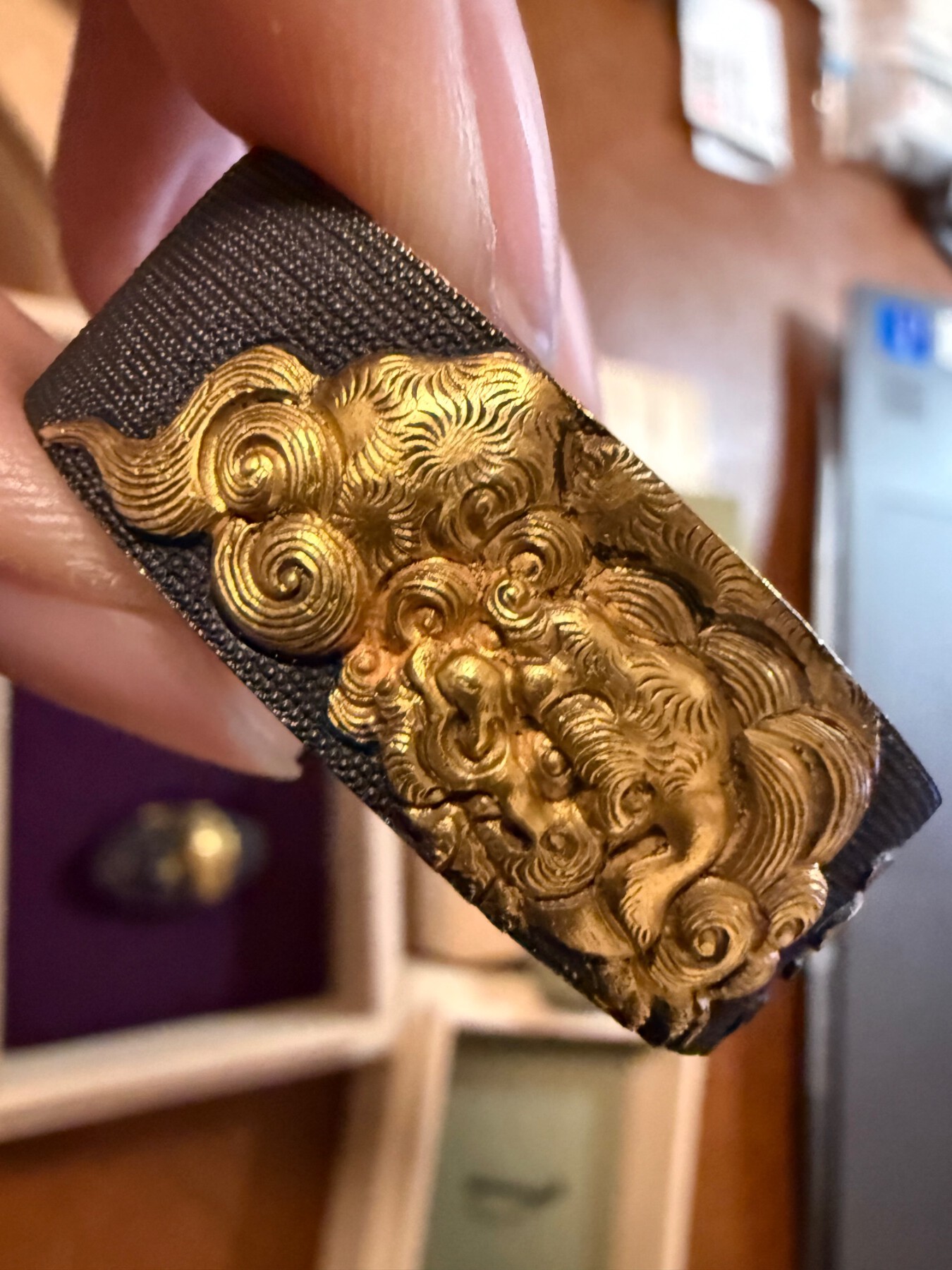

FruitSamurai Posted July 25 Report Posted July 25 Hi everyone, I recently acquired a set of shakudo nanako fuchikashira with a lion motif, signed Eisen (英宣)—a pupil of Omori Eisho (大森英昌弟子). I noticed the last stroke of "Ei" (英) terminates as an inward dot rather than sweeping outward like most Omori school pieces I’ve seen online. Could anyone share reference oshigata or images of Eisen’s work? Does this stroke variant suggest a gimei (false signature), and would you recommend submitting this set to NBTHK for shinsa? Photos of the piece and the mei are attached below. Thanks for your help! 4 Quote
Jake6500 Posted July 25 Report Posted July 25 (edited) Hi Thomas, The overall quality of the work certainly looks quite good... The early Omori masters often produced works of this kind with ground nanako-ji and high relief carving. Shishi lions were a known motif of theirs prior to the Omori-nami (wave) motif that eventually became the symbol of the schools peak works. If the piece is genuine it would be a signed work from a lesser-known second generation student of the founder of the Omori school, a contemporary of the infamous Teruhide. For comparison, the Yanagawa and Omori schools both branched off from the Yokoya school and the founders of both schools were students of Yokoya Somin. I happen to have a fuchigashira set from Yanagawa Naomitsu, the second generation head of the Yanagawa school with a similar motif and if you compare your own fuchigashira to it, you will see the structural similarities. Here's the thread I made at that time (feel free to post your own fuchigashira in this thread too!) What I'm getting at is that the design definitely fits the period of Eisen's activity. Naomitsu, who made my piece and became the head of the Yanagawa school, was active at the same time as Eisen and is part of the same generation of Machibori carvers... The quality, which I would call mid-level school workshop caliber also matches the artist who was skilled, but lacked the mastery of some of his contemporaries like Naomitsu or Teruhide. On the other end of the spectrum, because Eisen was a lesser known artist who did not take over the Omori school (you could say that he worked in Teruhide's shadow) it is hard to find any mei and kao examples or any comparison pieces. The NBTHK have reference examples if you choose to submit to shinsa but I could not find an example anywhere. Joly catalogued an "Eisen" and included an example of the kao in his names and kakihan, but it appears to be a different Eisen from the Bakumatsu Period. The signature on the piece is cut fairly fluidly. The first kanji seems great, the second features mild compression. This second character, as well as the overall simplicity of the kao (despite the fact that it seems well cut) is where my concern lies in submitting for shinsa. The other thing I'm not sure I can adequately judge from the pictures is if there is any divergence in colour where the signature is cut. Have a close look inside the crevices of the mei itself. Is the metal lighter in colour than the rest of the black fuchi base? If so, this is a sign that the signature may have been carved later (gimei). If not, this piece might warrant the shinsa submission to see what the NBTHK think. It is good enough in quality and aligns well enough with expectations that it COULD paper... Be advised that as Eisen is a minor student in the school, NBTHK authentication won't have a significant impact on the value of the piece. Further, you run the risk of the work being flagged as gimei and thereby losing financial value. My advice? If you submit it, do it purely out of curiosity or the desire to study the provenance of the piece, not for financial investment and be willing to lose the submission fee. If you're not willing to lose the financial investment, admire the piece as is. Edited July 25 by Jake6500 6 Quote

FruitSamurai Posted July 25 Author Report Posted July 25 (edited) 3 hours ago, Jake6500 said: Hi Thomas, The overall quality of the work certainly looks quite good... The early Omori masters often produced works of this kind with ground nanako-ji and high relief carving. Shishi lions were a known motif of theirs prior to the Omori-nami (wave) motif that eventually became the symbol of the schools peak works. If the piece is genuine it would be a signed work from a lesser-known second generation student of the founder of the Omori school, a contemporary of the infamous Teruhide. For comparison, the Yanagawa and Omori schools both branched off from the Yokoya school and the founders of both schools were students of Yokoya Somin. I happen to have a fuchigashira set from Yanagawa Naomitsu, the second generation head of the Yanagawa school with a similar motif and if you compare your own fuchigashira to it, you will see the structural similarities. Here's the thread I made at that time (feel free to post your own fuchigashira in this thread too!) What I'm getting at is that the design definitely fits the period of Eisen's activity. Naomitsu, who made my piece and became the head of the Yanagawa school, was active at the same time as Eisen and is part of the same generation of Machibori carvers... The quality, which I would call mid-level school workshop caliber also matches the artist who was skilled, but lacked the mastery of some of his contemporaries like Naomitsu or Teruhide. On the other end of the spectrum, because Eisen was a lesser known artist who did not take over the Omori school (you could say that he worked in Teruhide's shadow) it is hard to find any mei and kao examples or any comparison pieces. The NBTHK have reference examples if you choose to submit to shinsa but I could not find an example anywhere. Joly catalogued an "Eisen" and included an example of the kao in his names and kakihan, but it appears to be a different Eisen from the Bakumatsu Period. The signature on the piece is cut fairly fluidly. The first kanji seems great, the second features mild compression. This second character, as well as the overall simplicity of the kao (despite the fact that it seems well cut) is where my concern lies in submitting for shinsa. The other thing I'm not sure I can adequately judge from the pictures is if there is any divergence in colour where the signature is cut. Have a close look inside the crevices of the mei itself. Is the metal lighter in colour than the rest of the black fuchi base? If so, this is a sign that the signature may have been carved later (gimei). If not, this piece might warrant the shinsa submission to see what the NBTHK think. It is good enough in quality and aligns well enough with expectations that it COULD paper... Be advised that as Eisen is a minor student in the school, NBTHK authentication won't have a significant impact on the value of the piece. Further, you run the risk of the work being flagged as gimei and thereby losing financial value. My advice? If you submit it, do it purely out of curiosity or the desire to study the provenance of the piece, not for financial investment and be willing to lose the submission fee. If you're not willing to lose the financial investment, admire the piece as is. This photo is a close-up shot. It looks like the signature was carved before the patination process back when it was made, but based on the comparison image posted below, it could still be a gimei. Also, the entire tenjo-ita of this fuchi is black. I’ve noticed that most fuchi have an orange/copper tenjo-ita, so is a fully black one common? Or is it possible that it was re-signed and re-patinated later on? Edited July 25 by FruitSamurai 1 Quote
Exclus1ve Posted July 25 Report Posted July 25 I like. 37 minutes ago, FruitSamurai said: Also, the entire tenjo-ita of this fuchi is black. I’ve noticed that most fuchi have an orange/copper tenjo-ita, so is a fully black one common? Or is it possible that it was re-signed and re-patinated later on? The plate is completely black because it is made of the same alloy as the rest. This is less common, but still a common occurrence (in the kinko meikan example as well). I would ask you to take such large photos of the work itself. Quote
Jake6500 Posted July 26 Report Posted July 26 (edited) Re-patination is possible but you can also just get black chemically treated tenjo-ita. The kao on your piece is less complicated, so based on that as well as Mauro's example I would assume the piece is a decent quality gimei piece from during or shortly after Eisen's time (maybe 1790-1800ish) with a false mei and kao to increase sale value. It could well have been made as mumei by a lesser known student of the Omori school or a similar adjacent machibori school from the same Yokoya school lineage then signed and re-patinated at a later date. At this point I would not suggest submission for shinsa. If you were to submit it, you'd likely need to have the mei professionally removed and apply for school attribution. If you did have the mei removed it likely would paper, however I personally don't like the practice of removing signatures even if they are false... Personally I'd just keep it in my collection as is for its artistic qualities. The cost would also outweigh the financial benefit. Edited July 26 by Jake6500 2 Quote

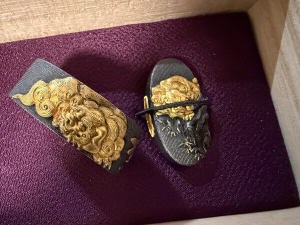

Exclus1ve Posted Tuesday at 07:48 PM Report Posted Tuesday at 07:48 PM I think we often focus too much on Mei instead of looking at the work itself) Thomas, is it possible to take large photos of the object itself? 1 Quote

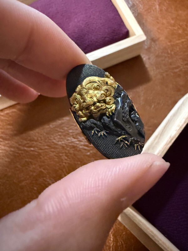

FruitSamurai Posted Thursday at 08:29 AM Author Report Posted Thursday at 08:29 AM On 7/29/2026 at 3:48 AM, Exclus1ve said: I think we often focus too much on Mei instead of looking at the work itself) Thomas, is it possible to take large photos of the object itself? Here are some additional close-up photos 1 Quote

Exclus1ve Posted Thursday at 07:41 PM Report Posted Thursday at 07:41 PM According to the new photos, the quality seems to be more ordinary, which is typical of school work. The signature itself is well written, the first kanji is different in spelling, perhaps it makes sense to have another artist.… 1 Quote
