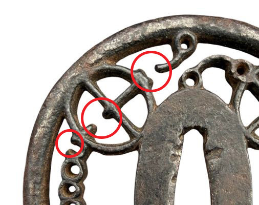

Openwork wrought-iron tsuba maru-gata with horse bits - Edo period (1603-1868).    Openwork wrought-iron tsuba maru-gata with horse bits - Edo period (1603-1868).
https://www.proantic.com/en/1763527-openwork-wrought-iron-tsuba-maru-gata-with-horse-bits-edo-period-1603-1868.html     https://www.antikeo.com/en/catalog/militaria/swords-bladed-weapons/openwork-wrought-iron-tsuba-maru-gata-with-horse-bits-edo-period-1603-1868-156512
This screams cast to me - just concentrate on the top left of the guard to start with, then check the right hand chain section with no openings all the way through.
img_x1920_156512_6a11c74be97233-61207963-34567767.jpg another view shows a crack through the mimi - not even close to the value they are trying to achieve 380 €

Dale,
I think you are correct. If one looks carefully, many small defects - probably from casting - are detectable, and the crack in the MIMI is not even the only one.
Even among cast TSUBA, this is not a prime one.....:(
