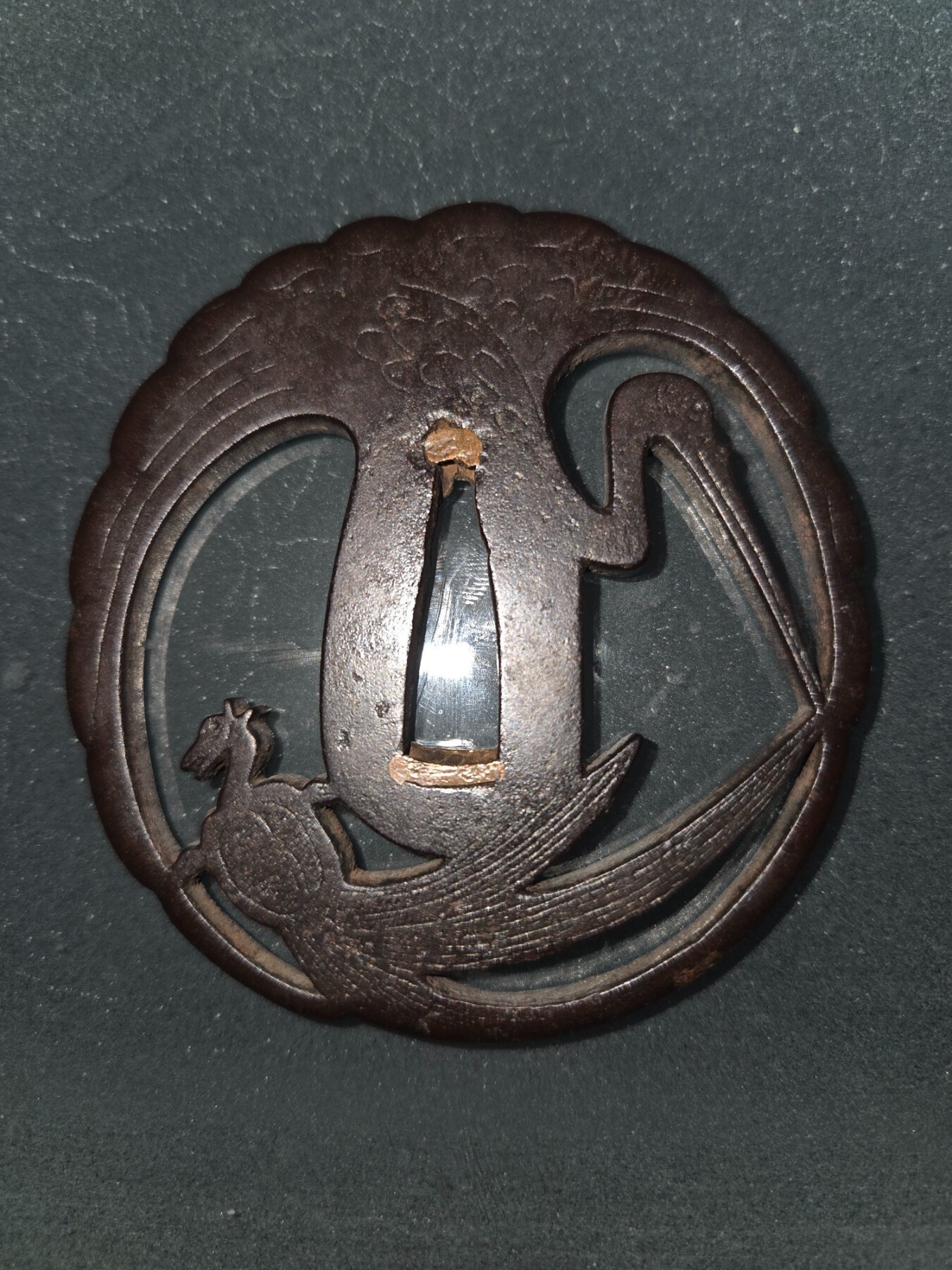

Lou V Posted July 2 Report Posted July 2 . Have had this one in my collection and the note that came with it said Akaska. Just over 6mm at the center and about 5.2mm at the rim. 80mm x 76.8mm I'm torn as it could be either school to my eyes. Let me know what you think 2 Quote
Curran Posted July 3 Report Posted July 3 It is a roll of the dice. Nihonto Koza list this as a separate group having something to do with Kashu (Kaga)? One shinsa might say Higo and another shinsa might say Akasaka. Flip a coin. 1 1 Quote
Spartancrest Posted Friday at 08:16 AM Report Posted Friday at 08:16 AM http://aoijapan.com/img/fittings/2012/F12449.jpg Akasaka https://www.aoijapan.net/tsuba-mumei-unsigned-akasaka-school-tsuru-kame-sukashi/ Bushu ju Akasaka https://www.choshuya.co.jp/senrigan/鶴亀図透鐔 銘 武州住赤坂彦十郎忠時/鍔/忠時 https://eirakudo.shop/tosogu/tsuba/detail/481005 Higo papered as Higo https://wakeidou.com/pages/365/ indeterminate https://rafuju.jp/products/detail.php?product_id=829120 2 3 Quote
Lou V Posted Friday at 10:13 AM Author Report Posted Friday at 10:13 AM Dale you must have one hell of a filing system to find all these similar pieces for everyone. I had seen the choshuya.co piece before. There are some similarities in the wakeidou piece. Seems it is a crap shoot if I send it for papers someday. Thank you both for the info. Quote
Spartancrest Posted Friday at 12:31 PM Report Posted Friday at 12:31 PM 2 hours ago, Lou V said: must have one hell of a filing system I have a good memory for "faces" - most of my trouble is remembering when and where I saw that "face" 1 Quote
John C Posted Friday at 02:15 PM Report Posted Friday at 02:15 PM 23 hours ago, Lou V said: Let me know what you think Lou: Here is some information about the two styles. The second paragraph talks just a bit about the differences. John C. 1 1 Quote
