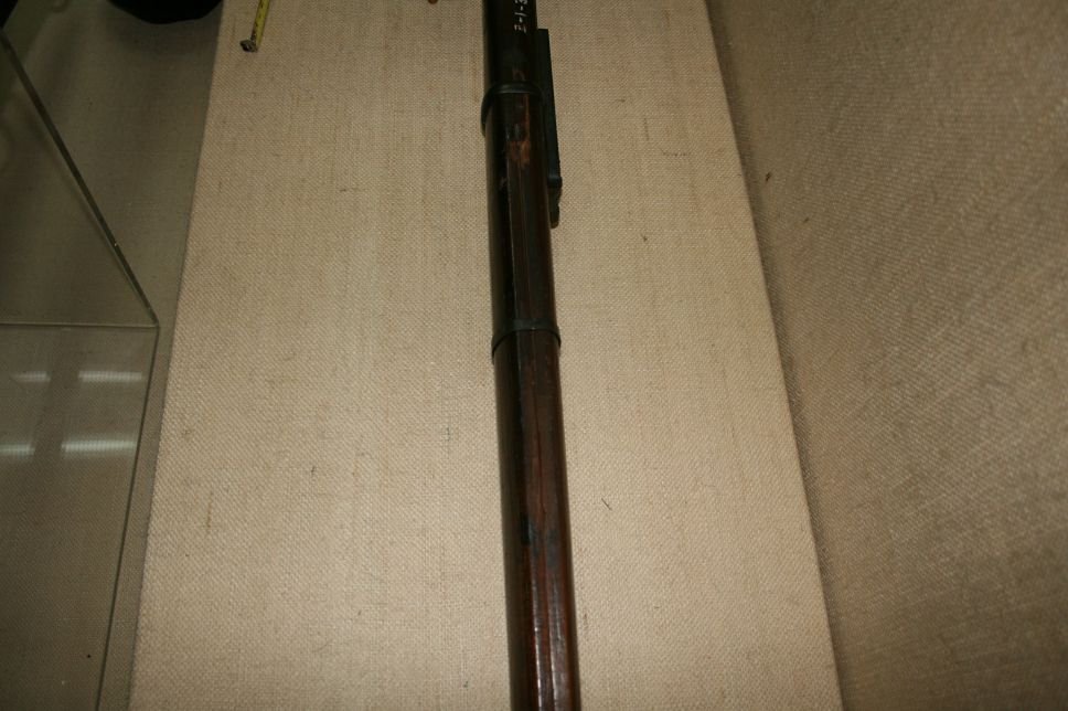

bluelake Posted May 1, 2010 Report Posted May 1, 2010 I asked the following on another board, but had no replies. Maybe someone here has an answer: One thing I noticed regarding both Japanese and Korean matchlocks is a split on the bottom of the stocks, which covers the entire length of the ramrod channel. As the barrel inlet side usually doesn't show a split, I'm wondering if the split had something to do with inletting the ramrod channel. Does anybody know? Korean example (on a wall gun): Quote
watsonmil Posted May 2, 2010 Report Posted May 2, 2010 Dear Thomas, The channel as you say never goes thru the stock to the barrel bed. I believe it has eveything to do with the contracting and expansion of the wooden stock in the moist and sometimes temperature extremes in Japan. This crack allowed for the ramrod to expand and contract without cracking the stock, ... and allowed for it's extraction without ever being binding. It also helped prevent the portion of the stock ( barrel bedding ) not to crack for the same reasons. ...... Ron Watson Quote

Bugyotsuji Posted May 2, 2010 Report Posted May 2, 2010 Other woods were used, but by far the most common is Kashi, particularly Akagashi or red oak. Quercus acuta as Thomas says above. Shiragashi or white oak was also used. Quercus myrsinaefolia See for red oak: http://ja.wikipedia.org/wiki/%E3%82%A2% ... C%E3%82%B7 See for white oak, all oaks: http://ja.wikipedia.org/wiki/%E3%82%AB%E3%82%B7 As to the slit below the ramrod, I have read that the cross-section of the stock acts as a pair of pincers. Removing the ramrod makes it easier to remove the barrel. Conversely, insertion of the barrel widens the top of the stock and at the same time narrows the ramrod hole below, making for a tighter fit. Quote
