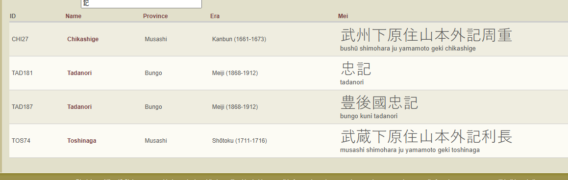

Shugyosha Posted June 6 Report Posted June 6 Someone with the electronic version of Sesko's meikan could do a search on the nori character and that would perhaps give a list of smiths whose name contains that character? The same could apply to the Nihontoclub database if anyone still has access. In Sesko's compendium the only entry is for the character itself so we can presume that he wasn't one of the titled smiths or one rated wazamono etc. Quote
eternal_newbie Posted June 6 Report Posted June 6 41 minutes ago, Shugyosha said: Someone with the electronic version of Sesko's meikan could do a search on the nori character and that would perhaps give a list of smiths whose name contains that character? The same could apply to the Nihontoclub database if anyone still has access. In Sesko's compendium the only entry is for the character itself so we can presume that he wasn't one of the titled smiths or one rated wazamono etc. Some possibilities for 記 based on the rough appearance of the kanji surrounding it: 南記重国 Nanki Shigekuni 英記直宗 Hideki Naomune 武州住内記康重 Bushu [Shitahara] ju Naiki Yasushige 2 1 Quote
Geraint Posted June 6 Author Report Posted June 6 Rohan, thank you. I really think you are onto something with that last one! The kanji just after ju looks remarkably like the one for Naiki. I'll do some digging. Thank you all very much for your help with this. All the best. 1 1 Quote
Toki Posted June 7 Report Posted June 7 On 6/6/2026 at 7:57 PM, Shugyosha said: The same could apply to the Nihontoclub database if anyone still has access. I did search for the 記 Character, unless I did something wrong there are not many listed. 2 1 Quote
Geraint Posted June 7 Author Report Posted June 7 Dera Erik. Thank you so much for checking this out. You are right, that kanji is not common. Rohan has nailed it with, 武州住内記康重 Bushu [Shitahara] ju Naiki Yasushige and indeed I have found one other jumonji yari by the same smith. It was a very long shot but the combined good will and ability of the NMB has won out once again. When we get some light here I will post a photograph of the yari just for interest. Thank you all for your help. All the best. 3 Quote
