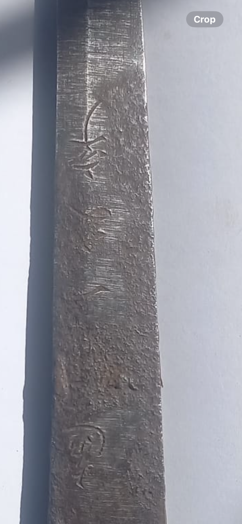

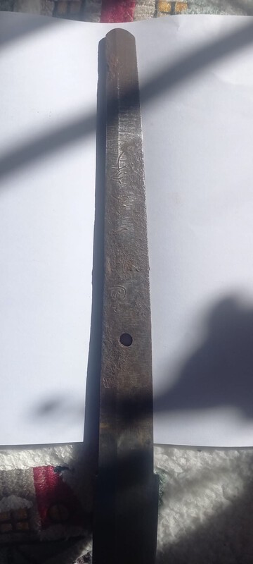

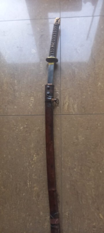

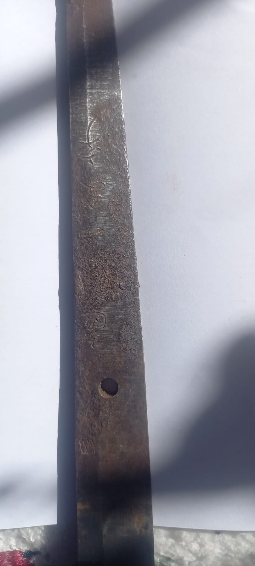

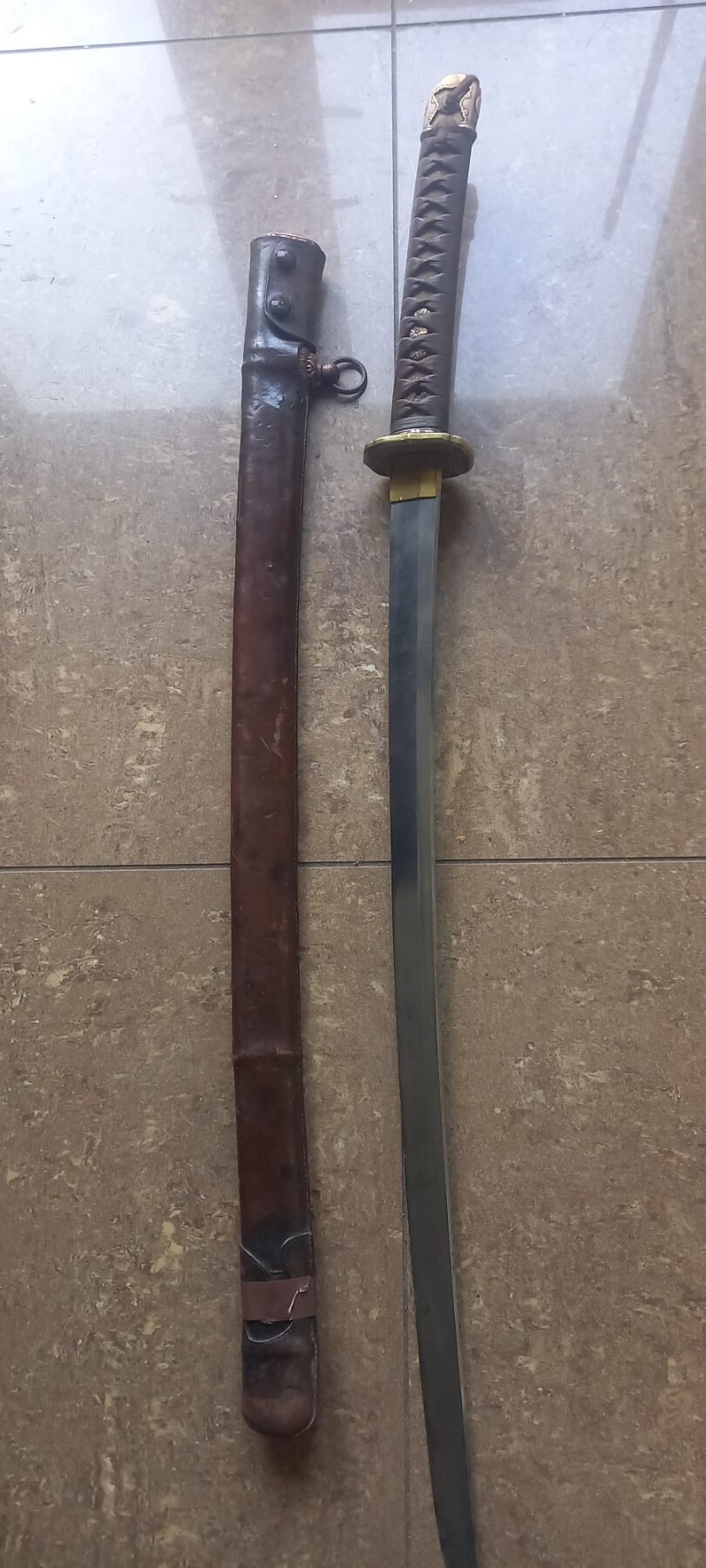

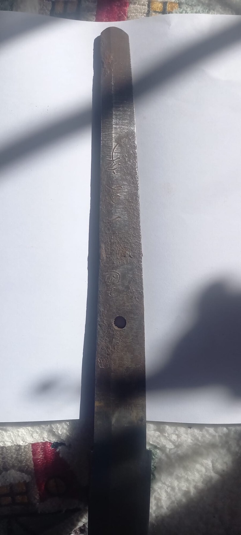

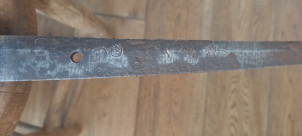

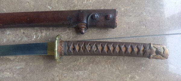

Swordjoe Posted April 5 Report Posted April 5 I’m trying to see if anyone can identify this signature, here’s what I know: Japanese military sword (guntō), specifically consistent with an Army Type 98 shin-guntō. It was made in Seki, which was a major center for sword production. Signature (mei) The signature reads: 兼〇作 (Kane–? saku), meaning “Made by Kane[smith].” The exact smith’s name is unclear due to wear, but it belongs to a large group of Seki swordsmiths who used the character “兼 (Kane).” Stamp The blade has the 関 (Seki) stamp. This indicates it was factory or semi-traditionally produced and was inspected by the government during wartime. Age / Year Based on the stamp, fittings (Type 98), and the style of the signature, the sword was made during World War II, most likely between 1935 and 1945. A more typical production range would be around 1940–1944. Quote
Nobody Posted April 6 Report Posted April 6 □ 一文字 – Something + Ichimonji I am unsure about the first kanji. And there might be one more character erased just after the first kanji. The signature does not include 兼〇作 (Kane–? saku). 1 1 Quote
Bugyotsuji Posted April 6 Report Posted April 6 The nakago shots are all upside down. (The end of the nakago tang should point towards you.) 天秀? 遠藤? 1 Quote
Joseph P. Posted April 6 Report Posted April 6 It is possible the signature may read "Endo Ichimonji". 5 Quote
Bugyotsuji Posted April 6 Report Posted April 6 Swordjoe, (you forgot to add your real name) you have just downgraded me for suggesting 遠藤 Endo above. Quote
Swordjoe Posted April 6 Author Report Posted April 6 Apologies Bugyotsuji, getting used to the system, same in error 2 1 Quote
Bruce Pennington Posted April 8 Report Posted April 8 Hi Dave, Here is your guy: "ICHINONJI (一文字), Shōwa (昭和, 1926-1989), Gifu – “Ichimonji” (一文字), real name Endō Masayuki (遠藤公之), born October 23rd 1890, he worked as a guntō smith." The stamp is the Showa stamp, used by the civilian Seki Cutlery Manufacturers Association between 1935 and 1942. Most dated blades with the stamp were made in 1940-41. 2 Quote
