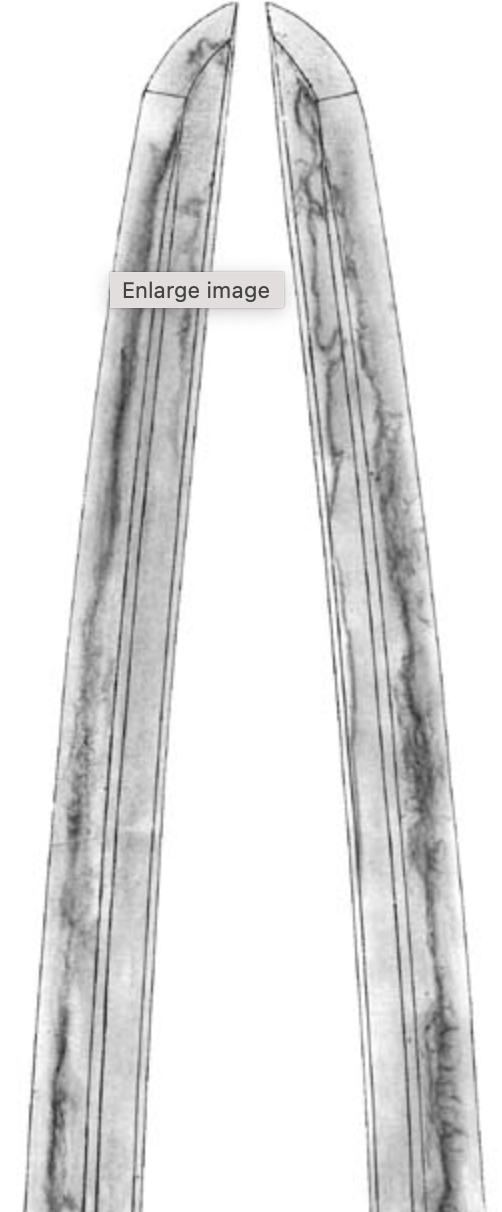

CSM101 Posted March 12 Report Posted March 12 (edited) Sometimes they are equal... Edited March 12 by CSM101 A 1 Quote

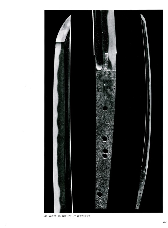

CSM101 Posted March 12 Author Report Posted March 12 ...and sometimes they are not. Aizu Shintogo and Kosetsu Sa Monji. 2 Quote

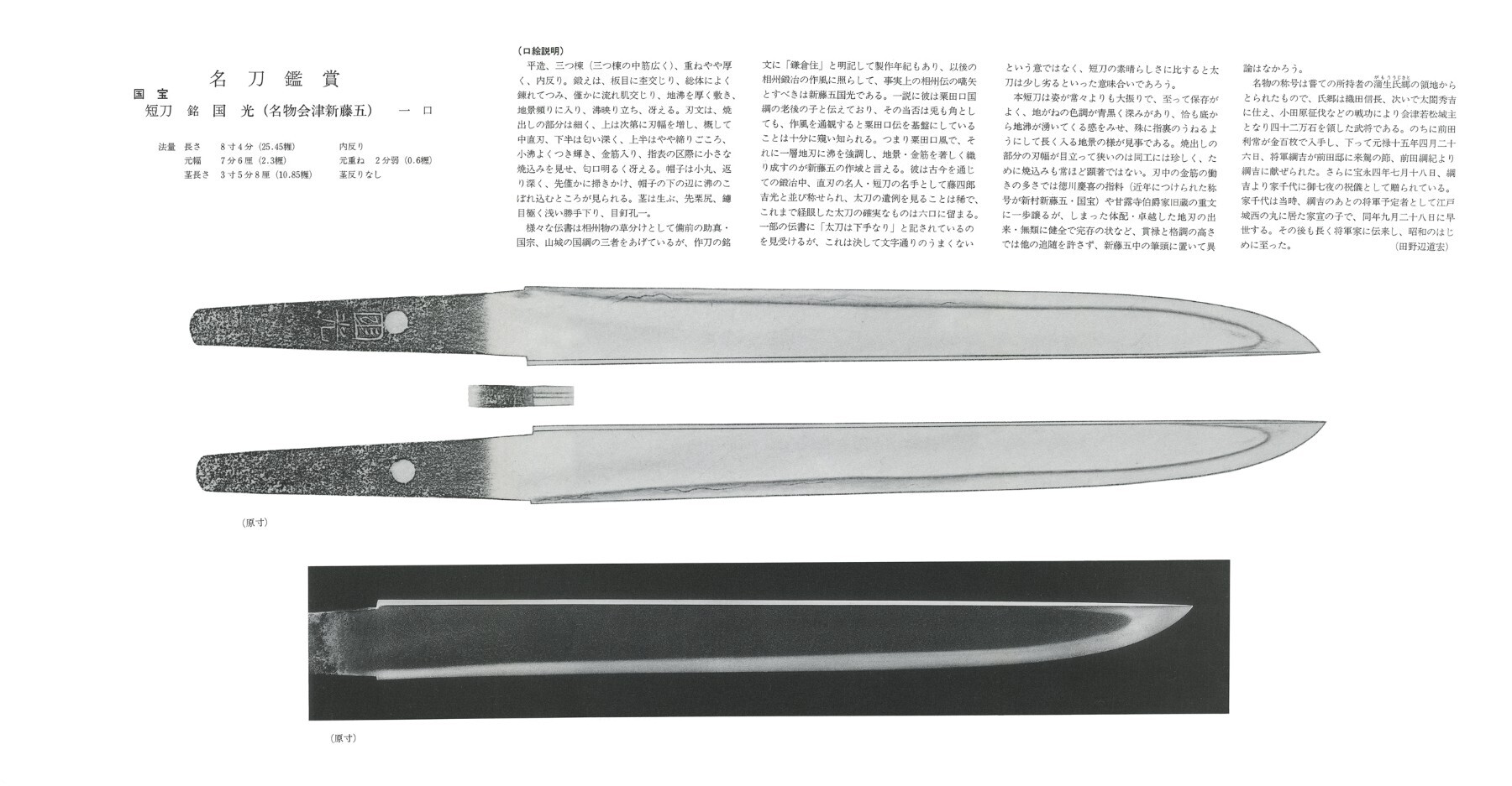

nulldevice Posted March 12 Report Posted March 12 Just for fun, 2 more oshigata of the Kosetsu Samonji 1 1 Quote

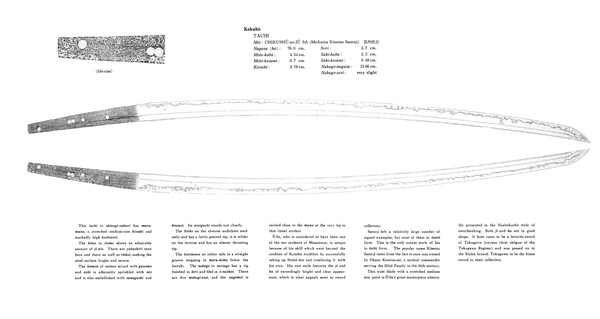

Lewis B Posted March 12 Report Posted March 12 I'll play. This is a bit of the curve ball though. The Kaikuni Go has 2 quite different oshigata although the 1st one was probably drawn after it sustained fire damage and 2nd after an unsympathetic saiha. Echo's of this sorry workmanship 4 Quote

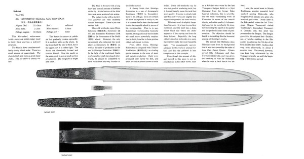

Brano Posted March 13 Report Posted March 13 Kosetsu Samonji was published twice in Token Bijutsu and also twice in the En version of Token Bijutsu Here is the better En version 3 1 Quote

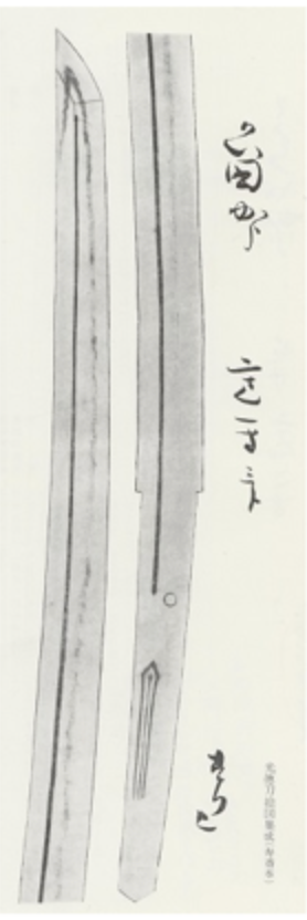

Brano Posted March 13 Report Posted March 13 And one of the best photographs available - the 1961 Masamune no Sono Ichimon exhibition 1 1 1 Quote
