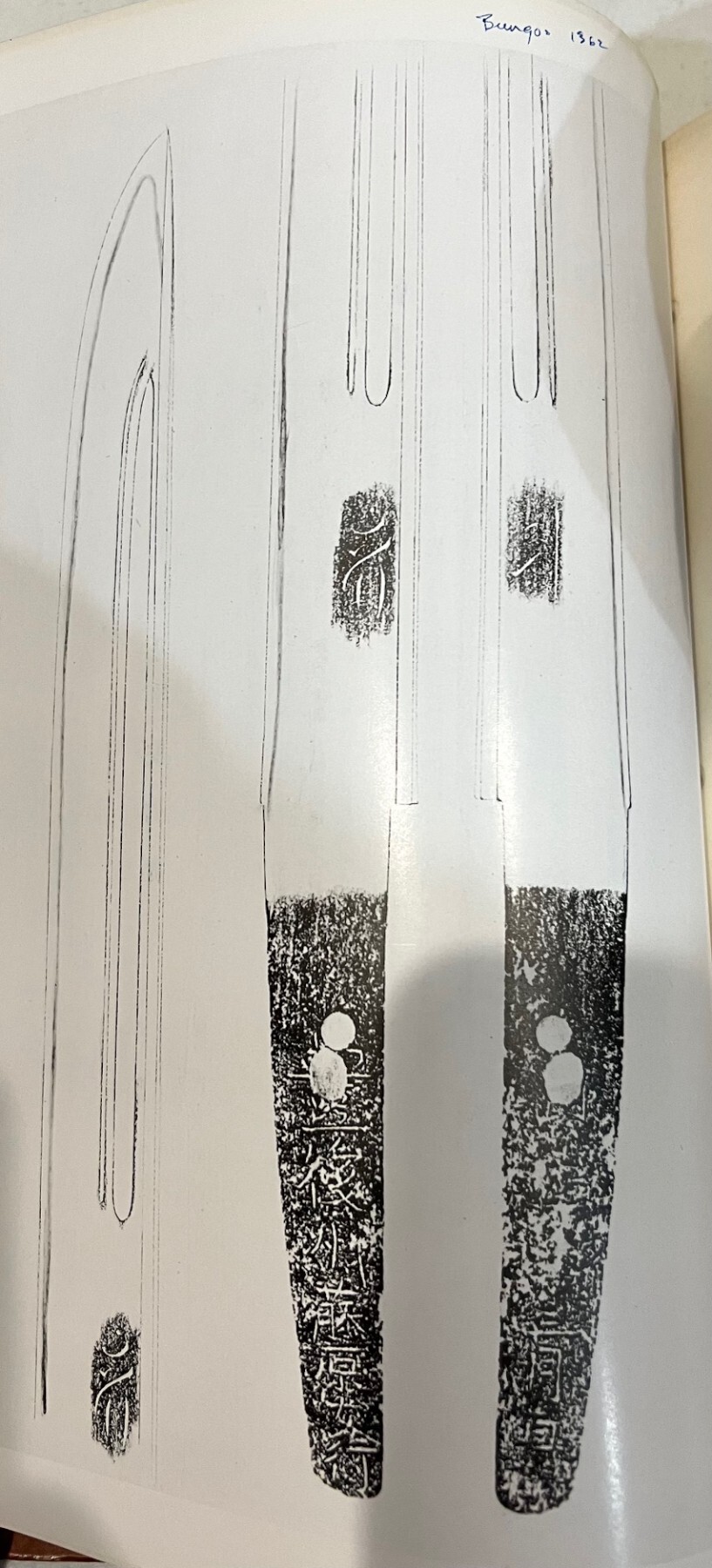

Mikaveli Posted December 16, 2025 Report Posted December 16, 2025 4 hours ago, Ed said: There is no research regarding the authenticity of the mei, but the measurements have to be correct, not superficial by law. It you are checked by the Japanese police and the measurements do not match the torokusho, the trouble you will incur will be far from superficial. ~~~ snip ~~~ Yes, there are Juyo Tanto with nagasa slightly over 1 shaku that were papered some years ago. Honestly, not sure if that is still the case today. If you have evidence of modern papers which state "Tanto" with nagasa over 1 shaku, I would like to see them. Apologies if English isn't your first language, but superficial doesn't mean inaccurate, just that in this case it's a visual analysis, of the obvious features on the surface. Literally its outward appearance, as presented. The mei will be recorded as written, even if obviously gimei, and the physical measurements are taken too. These are superficial details. As for modern papers, after a casual search I found an example from Reiwa 4 (2022), that I'd consider modern. Admittedly, of the current generation papers I see, most do record the blade as wakizashi above 1 shaku, but there are exceptions. Quote
