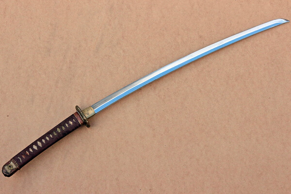

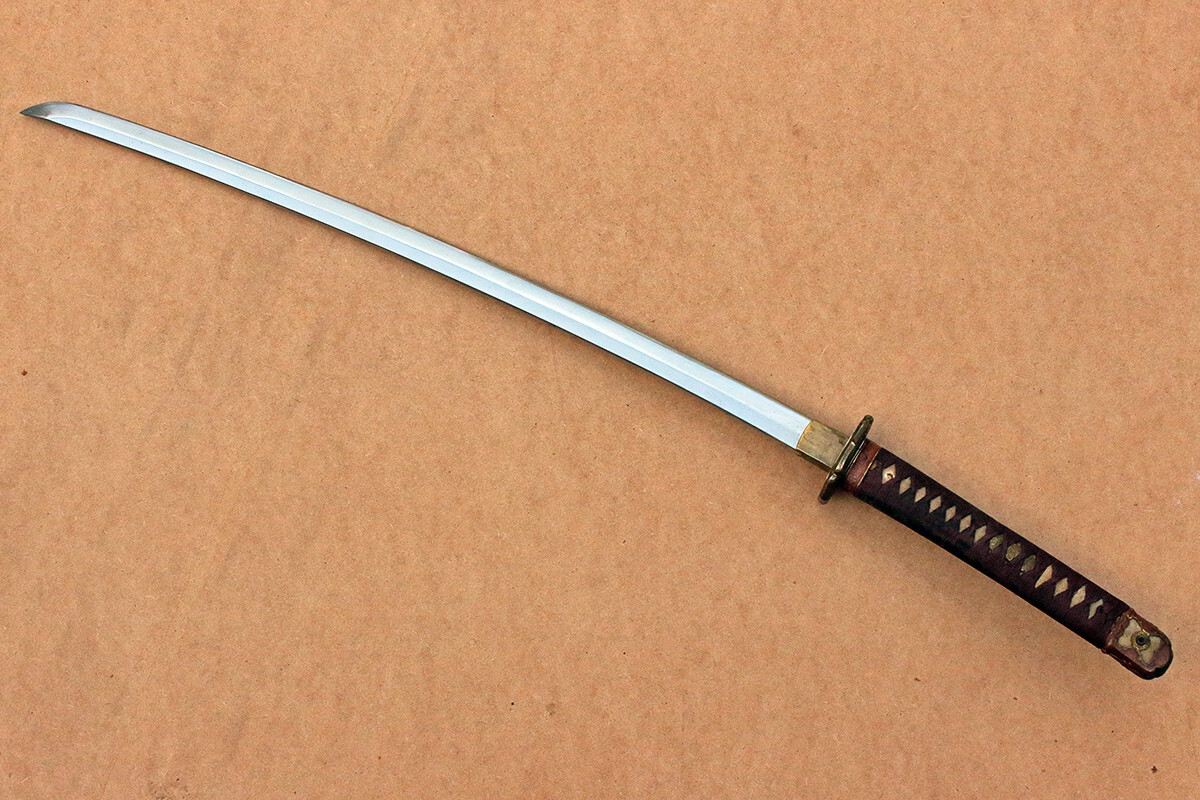

The third sword (and second known to me at that moment) was this shin-gunto:  https://www.militaria.co.za/nmb/topic/46565-shin-gunto/
It might be a pretty decent showato if not for tsuka. It might have been rewrapped at some stage as Ito looked too new and clean. Yet the main no-go were fuchi and kabuto-gane. Even in pictures from the topic one may notice that they look too blurry, especially kabuto-gane. With sword in hands they looked like someone made the molds from original parts and re-cast them. It was a strange contrast with the brass fittings on saya that looked pretty normal. Now if one took into account these details and the fact that there are two mekugi ana in nakago, one may come to the conclusion that the tsuka is not original and was a later addition to this sword. Considering this, I decided to pass on this sword too.

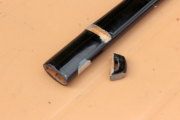

The greatest  loss is the original saya. I asked the seller about it. He told me he knew nothing about its whereabouts. So  I contacted his partner, Den through the private messages here. Alas, no answer so far. Hope he will answer soon. The saya that came with the sword, well, dunno what to say... I believe it has nothing to do with the Japanese swords at all. The grey stuff seems to be automotive putty. The kurigata is crude and was held in place by sheer power of super glue.

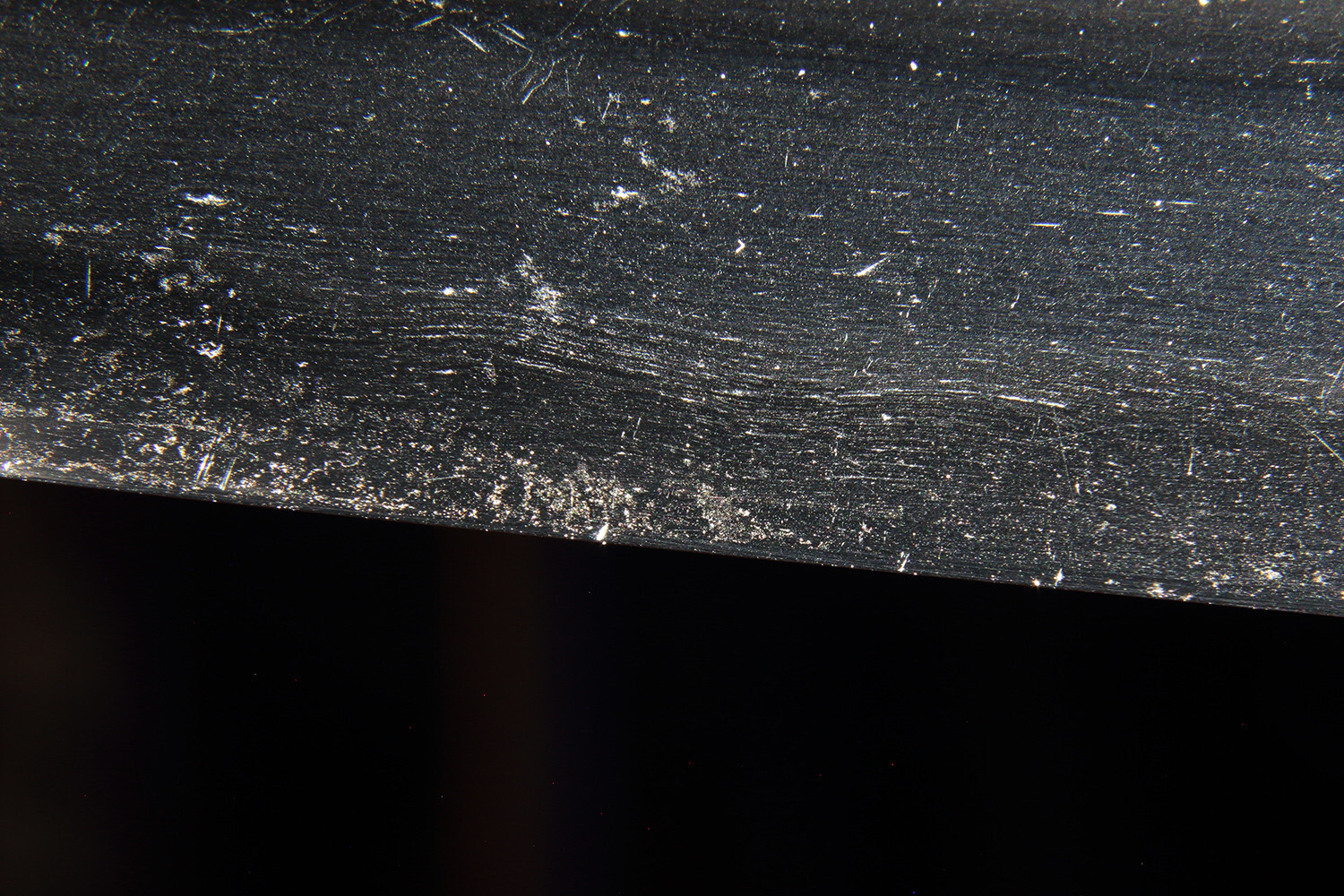

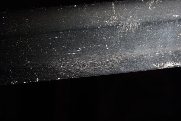

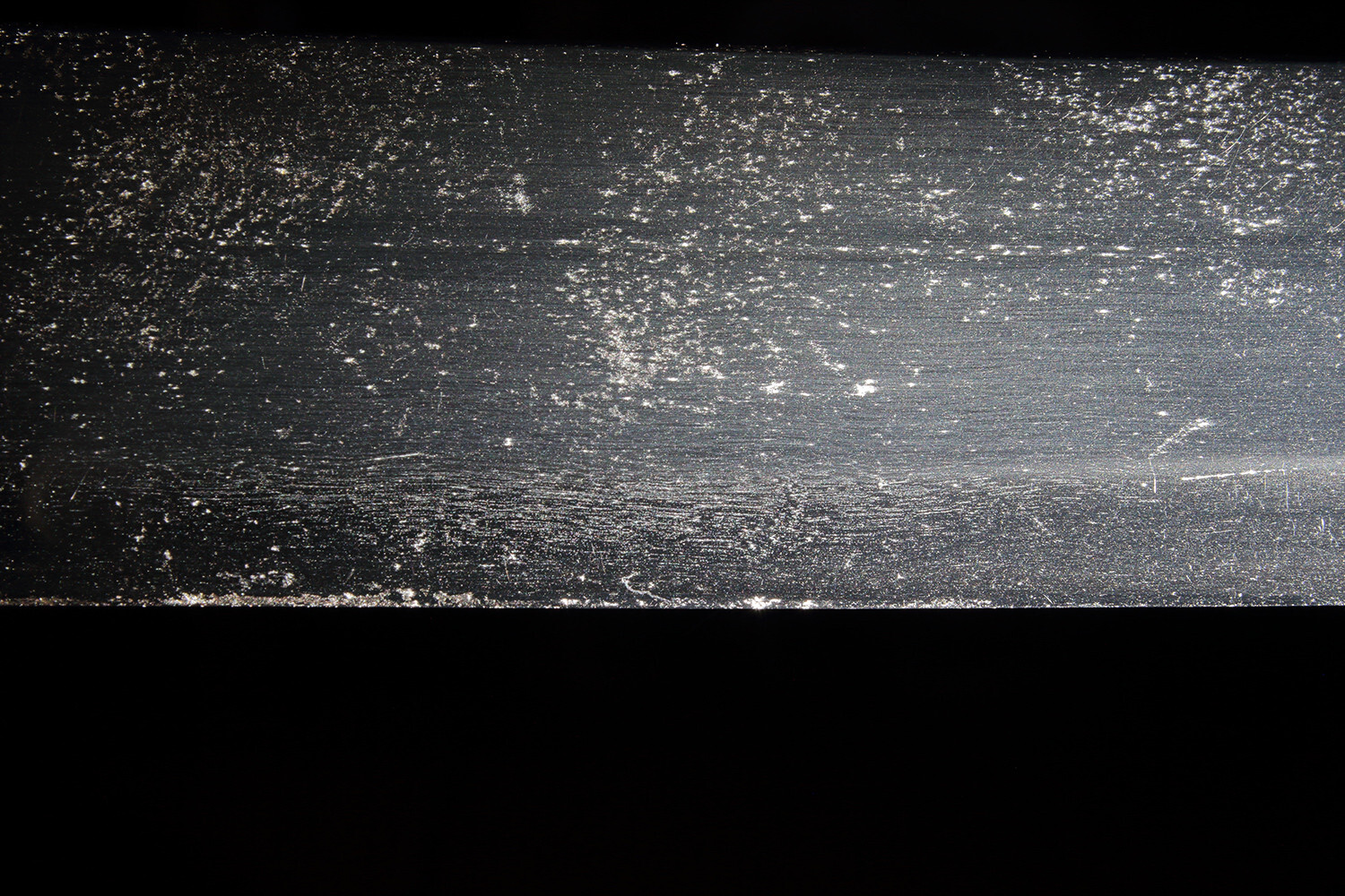

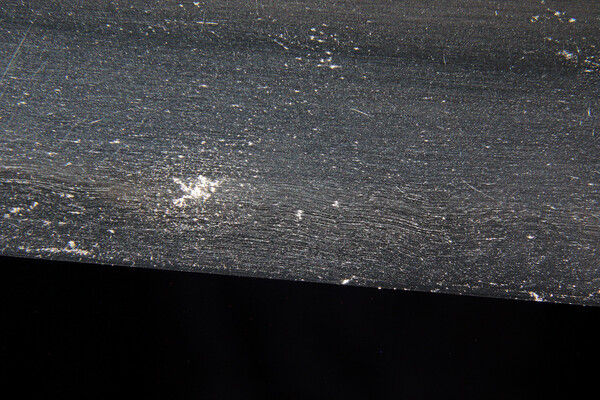

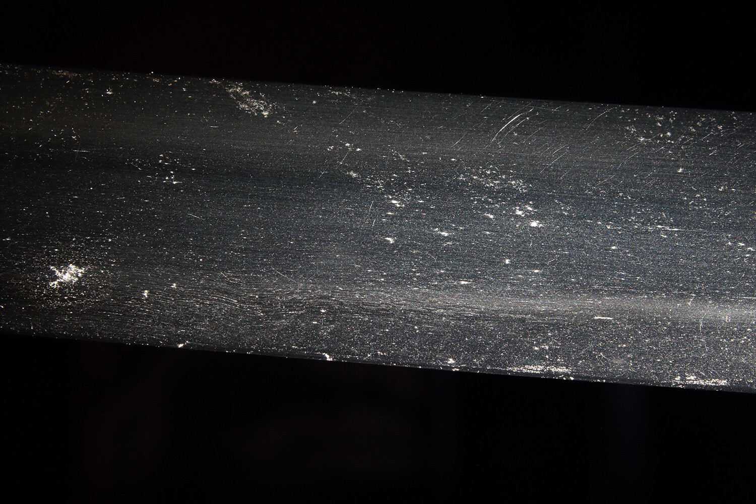

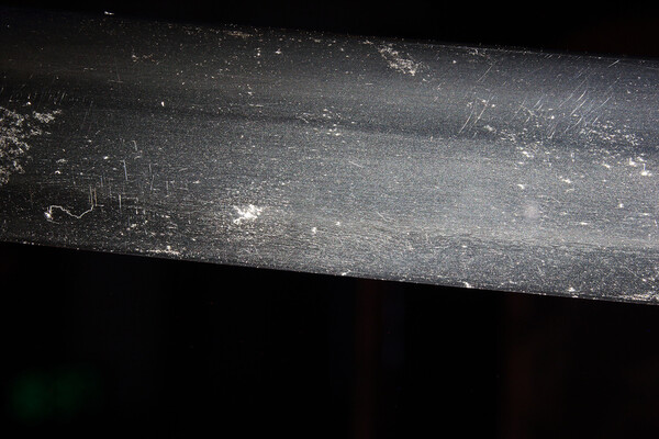

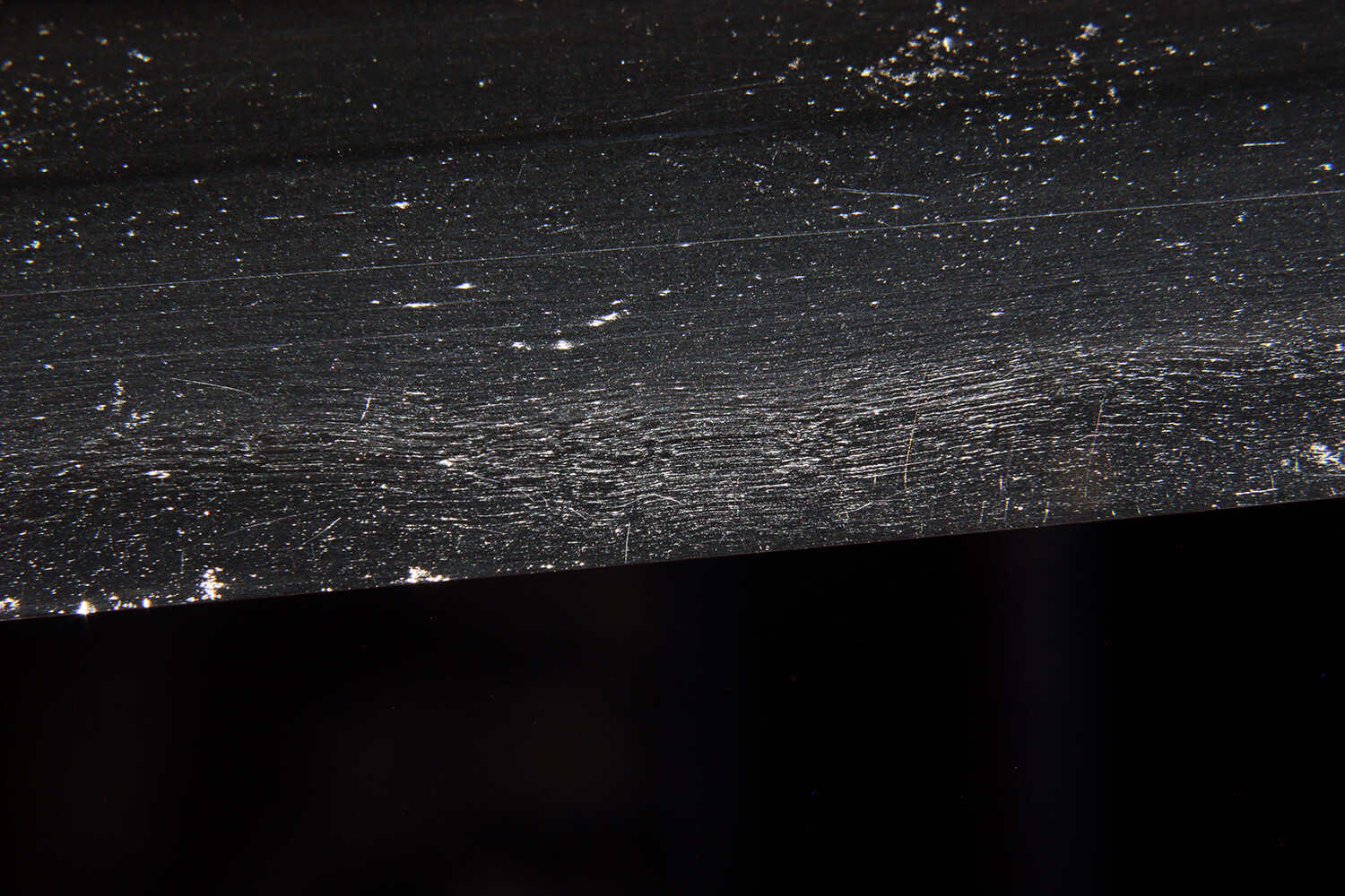

The blade was out of polish and had some spots of rust and fingerprints that became permanent. This is clearly visible in the photos of the previous  topic on this sword. Then the blade was buffed. I also found  some scratches made across the blade. They indicate that some abrasive media like sandpaper or Scotch Brite was applied before buffing.  The buffing made the process of shooting photos of hataraki mostly impossible. Also, unevenly buffed blade with extra shiny spots took on my nerves.  So I had to do something but not to make things worse. I went through a lot of topics here and stumbled upon the mention of Jim Kurrasch's power uchiko method. I read all that I could find about it and I decided to try. It was a slow process, yet at that time I was able to spare an hour a day to do the uchiko job. After a long time I started to see the result. The hamon line that was broken by buffing  was back. I believe I still am not even halfway through the process and still have a lot to learn about uchikoing. Yet for the time being I stopped uchikoing the blade. Partly because the minimum result was already achieved and partly because I wouldn't  have time for it for some time due to my duties. In this case I had to leave my swords and blades for some time. And it will still be some weeks before I could return to them or bring them with me to a new place.
So I decided to take the first photos of what I think are hataraki while I still had some time.  So far I was able to count four places (four on each side of the blade) where hataraki manifests itself. Three of these places are quite prominent (at least in my opinion). I made several approaches to photoshooting. Instead of laying the blade flat on black canvas, I put it on my 3D printed stand. I used a LED spotlight that has an integrated tripod as a source of light.  In this way I was able to change the position of the light, blade and camera. The spotlight was the only source of light in the room. Thus, the background remained black.  I also used my homemade "Macro" adapter, even as it tends to bring some light artefacts if the setup is not adjusted carefully. Yet, even with this it was hard to make propper shots of hataraki. I believe it is sunagashi. What do you think about it? Is this indeed sunagashi, or am I just a delusional moron? Also sorry for so many photos. Yet it was an interesting exercise for me to shoot them.
Two photos od the same spot:
Two photos of yet one area:
In some photos above you may still see the marks across the blade left by the person who "prepared" the blade for buffing. The only direction I was working uchiko is along the blade.
The line of hamon doesn't overlap ha-machi.

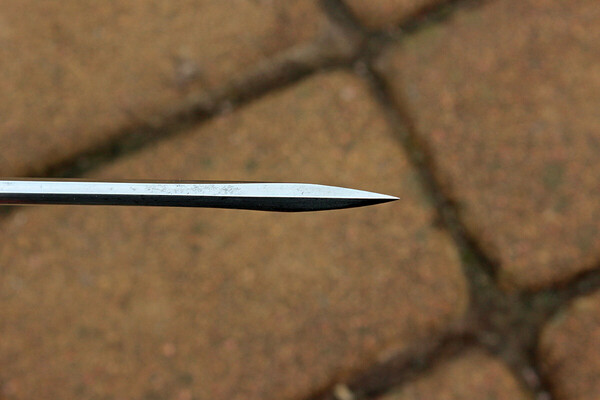

And it was especially hard to catch the boshi.
And just a photo of the hamon line.

Buffing caused a lot of damage. Yet, I suspect that long before the buffing blade was polished and the polisher didn't do his best. The main indications of this are as follows: the line of Koshinogi is more straight on the mei side of the blade while it's more curvy on another. There is also a spot on the blade close to ha-machi (on the mei side ) that looks strange. In my inexperienced opinion it looks like the polisher didn't get the real line of hamon and  tried to create a false hamon line. These occurrences couldn't be explained by buffing only. Later on I'll shoot some photos of these areas. At the moment I am away from my swords and will be away for some weeks.
Alas in cases of even gendai blades made by not very renown smiths like Nagamura Kiyonobu the polishing might be unwise. Also finding a polisher here in Ukraine might be an issue. So for the time being I will go only as far as Uchiko could get me. And even with it I'll be very cautious.

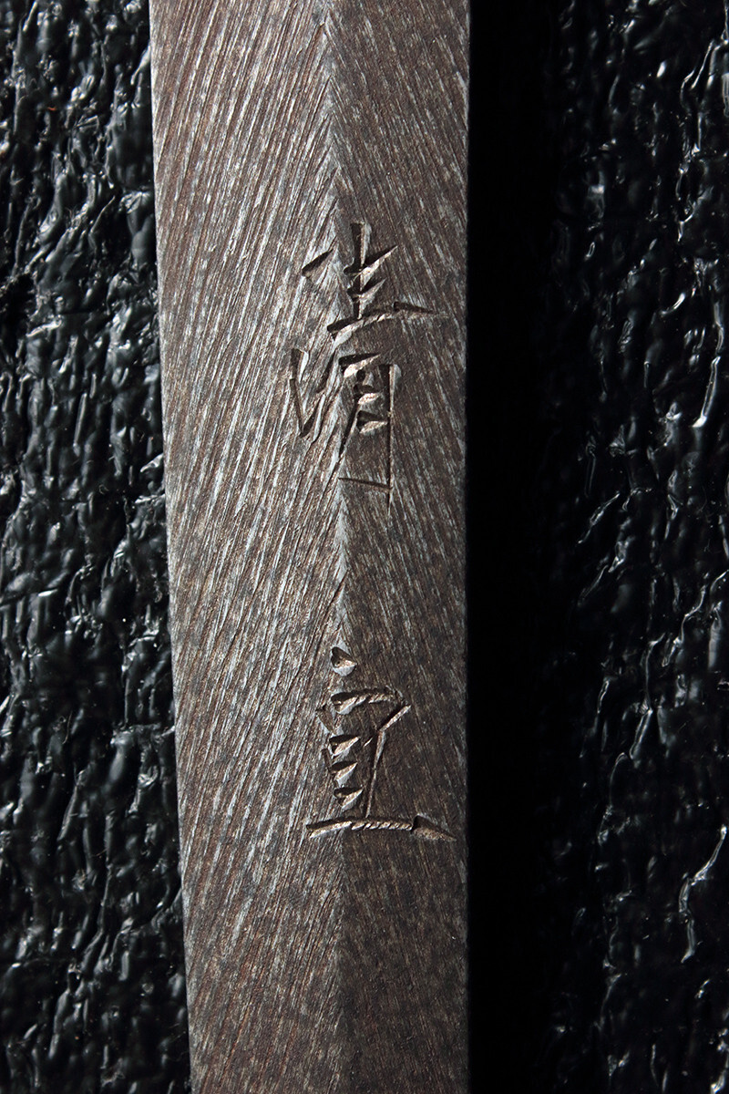

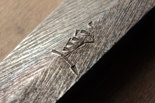

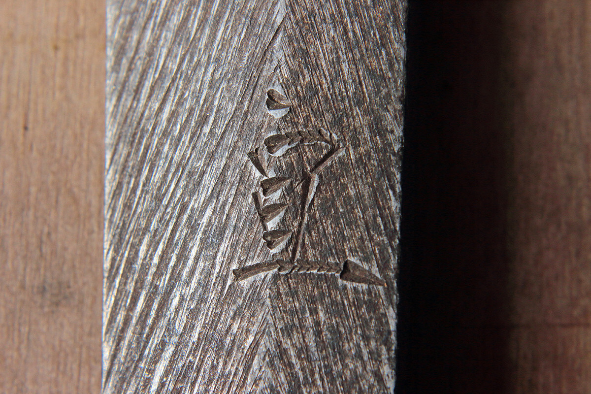

Here are some closer photos of Kanji:

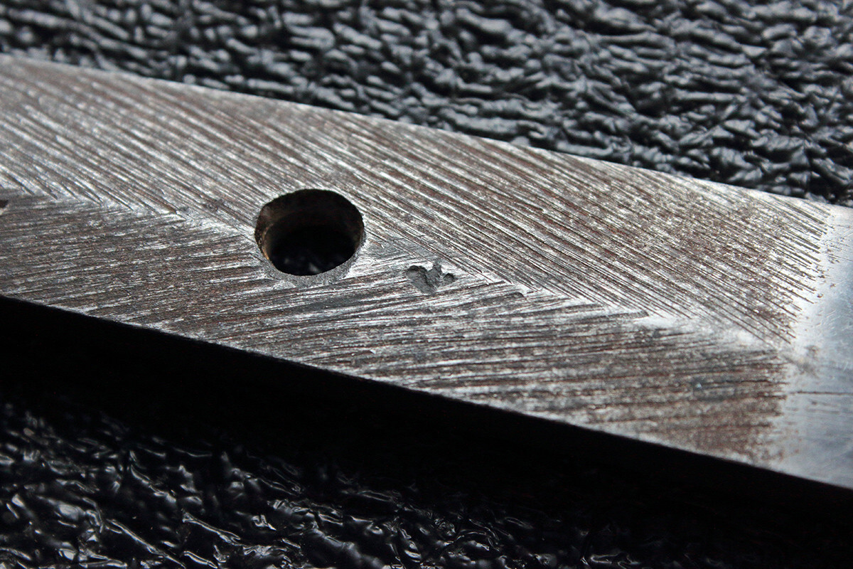

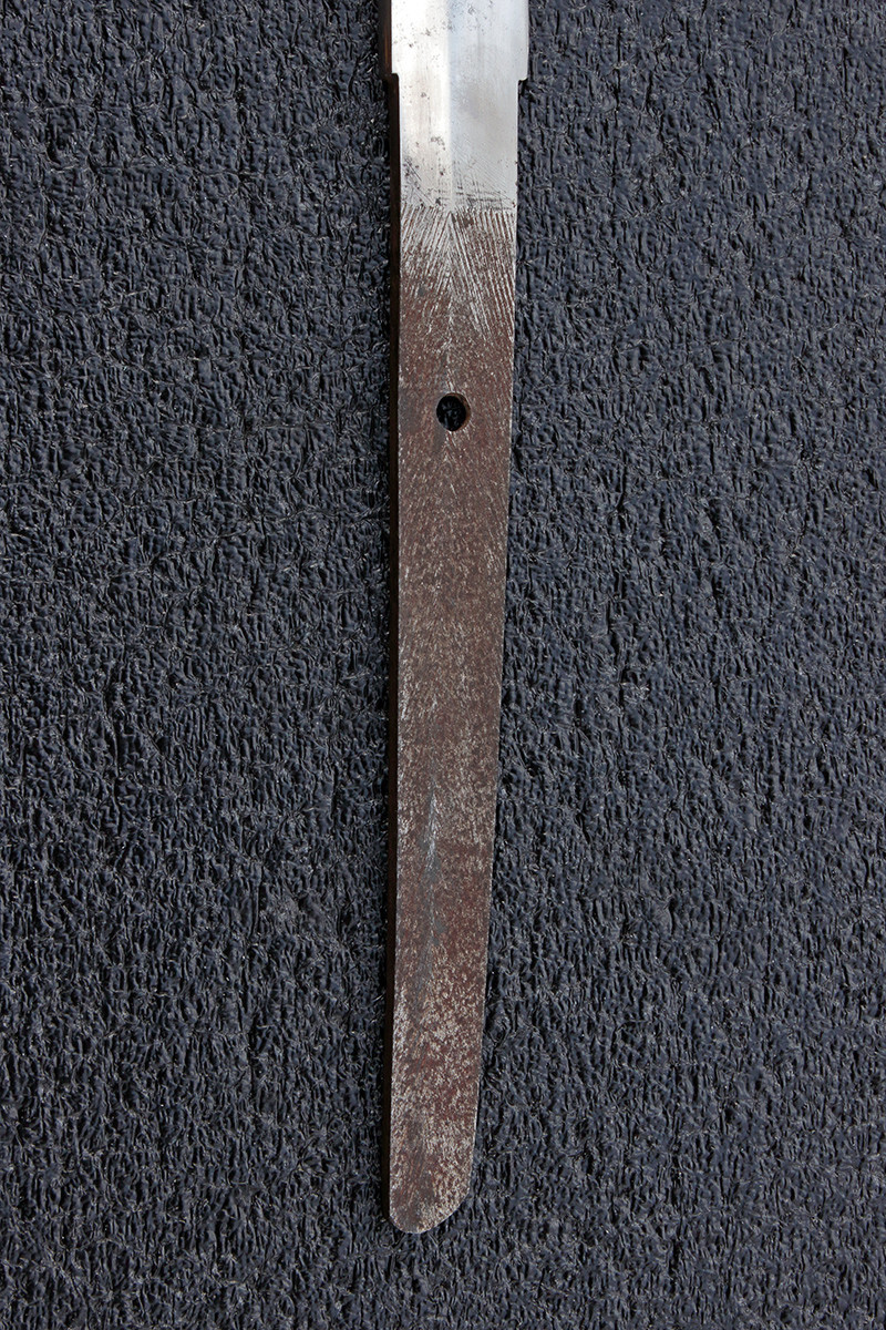

2. The subject of the topic is the sword by Kiyonobu with short signature.The signature features V-shaped strokes in Kiyo Kanji and may be made by the same person who signed my sword.

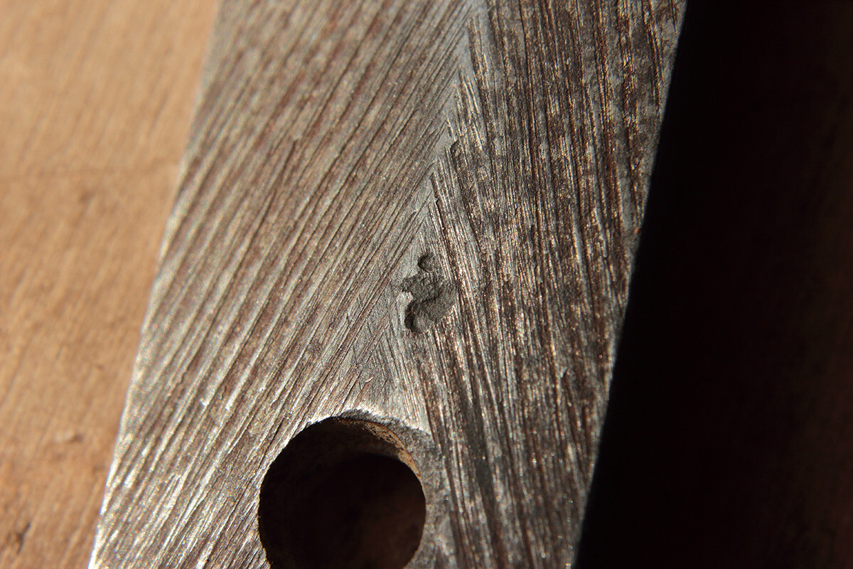

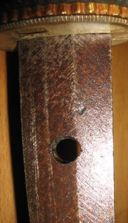

3. The nakago of the subject sword has a curious stamp that is placed on the mei side above the mekugi ana. Here are two pictures from the topic above. Alas, the quality of pictures are low so only the general shape of that stamp is recognizable.
Edited by Nazar
fixed links
Posted (edited)
The thing about that stamp is that I believe the nakago of my sword has the very same stamp too. One may find it in the photos of nakago above.  Out of all cases of Kiyonobu swords I gathered, there are only two nakago that feature this stamp. Both have short two-Kanji signatures with V-shaped strokes in Kiyo. My only guess is that this stamp is some kind of  personal mark.
As for how they were made. I guess that it's three punches in a row with the fourth punch slightly aside.  In the case of the nakago of my sword, it seems that one of three main punches may have chipped a bit of metal.  Yet, I might be wrong. Here are some close photos of the stamp.
Hm.  I had seen the mark earlier and assumed it was simply a flaw in the steel.  But after seeing another one of his with a mark in the same place, I tend to agree with you.  There are many blades with punched dots, but up to now, they are always (there's that word!) near the jiri or on the mune.  This does seem a unique personal practice of some sort.

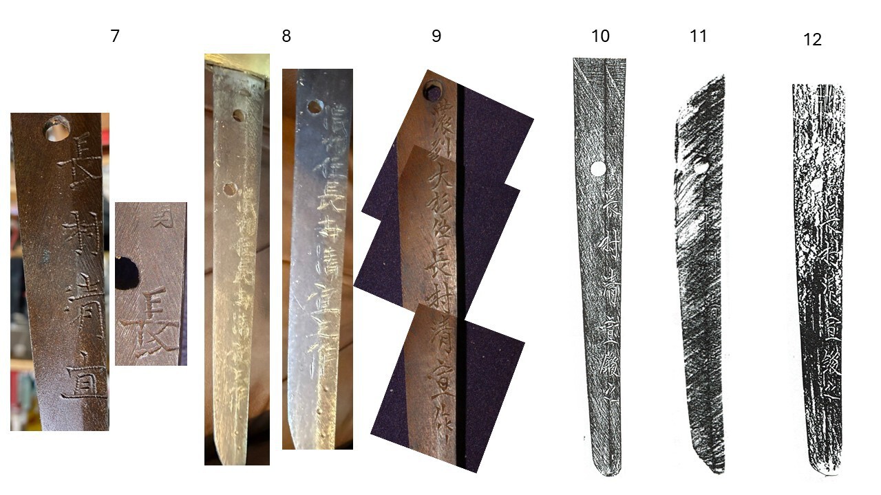

The mei being considered is Kiyonobu”, which can also be read as “Kiyonori”.  There is also nobu and “nori” as .
Reported information on WW2 Kiyonobu:  his real name was Nagamura Matsuichi (長村 松市) and he was born Meiji 34 (1901) April 10.  (Sometimes referred to as “Osamura”).  He was from Gifu Prefecture and registered as a Seki smith on Showa 16 (1941) April 30 (just turned 40) and was living in Kamo-gun, Tahara-mura, Osugi . He is not in the 1940 list of Seki Token Kaji Association.  He is listed as a Rikugun Jumei Tosho, but he is not listed in the 1942 Bazuke of Kurihara Hikosaburo, or in the large commercial Dai Nihon Token Meikan of 1942. Nor is he in the 1941 Shinsakuto Exhibition.  (He is not listed in Sesko).  However, he was relatively productive during the war years.
Of examples found, all blades are katana-mei, most have sujikai filing, but two have taka-no-ha (#1 with small stamp; #7 with small Seki stamp of Nagoya Arsenal 1943-1945).
Other stamps: #4 small unknown stamp; #10 TAN is early war and better steel.
Several mei are cut by specialists (nakirishi-mei) indicating bigger workshop: #6, 9, 10, 12; maybe also 4 and 5.
Very little information on him, and more likely he was a blacksmith/metal worker, without formal training as swordsmith.  Maybe early worked in smaller forges/shop, then later to Nagoya Arsenal.
Some example descriptions of located oshigata
(1)  “Kiyonobu”, small unknown stamp, katana-mei, taka-no-ha yasurime strongly filed.  “Nori” uncommon style.  [Nazar, December, 2025, NMB]
(2)   “Nagamura Kiyonobu tsukuru kore”,  katana-mei, sujikai? yasurime. [JSI, Stein]
(3)   “Kiyonobu”, tachi-mei, sujikai yasurime.  Shingunto.  [Griffin Militaria]
(4)   “Nagamura Kiyonobu”, small stamp, katana-mei, sujikai yasurime. [ikedaart]
(5)   “Nagamura Kiyonobu tsukuru”, katana-mei, sujikai yasurime. [Seiyudo]
(6)   “Noshu ju nin Nagamura Kiyonobu tsukuru kore” , NBTHK Hozon paper 2010 (Japanese seller read as “Kiyonori”).  Katana-mei, sujikai yasurime. No date, no stamp. [e-sword.jp]
(7)   “Nagamura Kiyonobu”, katana-mei, taka-no-ha yasurime, small SEKI stamp of Nagoya Arsenal (1943-1945) [dwp,Dennis, December 2021, NMB]
(8)   “Noshu ju Nagamura Kiyonobu kore saku” very poorly cut, katana-mei, taka-no-ha yasirime roughly filed.  Three punch marks (assembly marks?), later hole drilled (post-war?)
(9)   “Noshu Osugi ju Nagamura Kiyonobu saku” (living in Osugi in Mino/Gifu), well cut mei by specialist, katana-mei, sujikai yasurime. No date or stamp. [Jason Jcremer24, March, 2023, NMB]
(10) “Nagamura Kiyonobu kitau kore”, TAN stamp, katana-mei, sujikai yaskuri-mei with kessho finish. [Slough, 2001, p.85]
(11) “Nagamura  Kiyonobu” SEKI stamp, katana-mei, yasurime not clear.  Arsenal work. [Fuller & Gregory, 1983, #188]
(12) “Nagamura Kiyonobu kitau kore”, katana-mei, sujikai yasurime. Early war. [Fuller & Gregory, 1983, #192]
(13) no image: “Noshu Seki ju Kiyonobu saku”, SEKI stamp, date 1942. [Fuller & Gregory, 1983, #255]

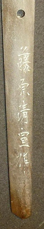

- Case  #11 features the name Fujiwara Kiyonobu while the style of signature suggests  it may be chiseled  by the same person who made signatures in #4, #30, #42, #44 and #45 cases (Same V-shaped strokes in Kiyo).

Case #11:

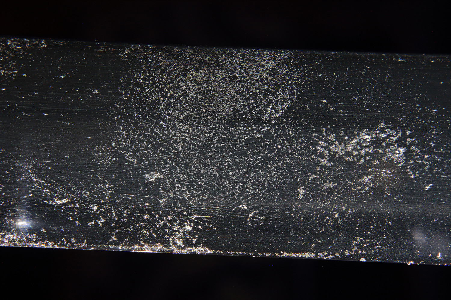

Posted (edited)
Went through my photos of sunagashi and found a picture that could be used as a clear example of fingerprints that became permanent. It doesn't look that bad in daylight, yet under the spotlight it became more prominent than shunagashi themselves.
Another fingerprint (top right corner). And I like this blade with all its flaws anyway. Not only because it's the first gendaito I scored but because it gave me a lot to think about and to search for. I'll try my best so no further harm comes to it.

So, let's proceed to koshirae. Original saya has gone, and the saya that came with the sword is of unacceptable quality. I doubt very much that in the foreseeable future I  will have time to take a swing on crafting new saya on my own.  So the idea is to order saya from a guy dealing in nihonto and swords I met around Christmas. It wouldn't be an original thing, yet at least it would be made to fit this sword.
And here is what left from original koshirae:
