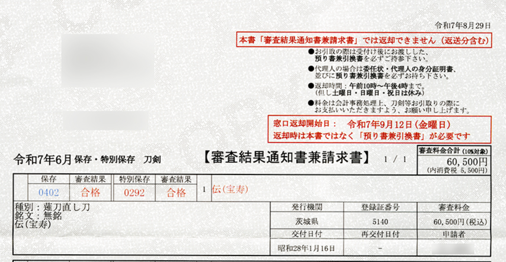

Jussi Ekholm Posted September 25, 2025 Report Posted September 25, 2025 It is right up my alley. NBTHK judged it as den Hōju and awarded Tokubetsu Hozon for it. I am personally a big fan of Hōju but it also tends to be an attribution bucket for items of "rougher" side like this one. Bit similar way how I think about Uda attribution is used. Some of the signed Hōju and Uda swords I have seen in museums feature quite nice workmanship, while some mumei work that gets attributed towards them is on rough side. Here are two similar very big naginata-naoshi attributed to Hōju as reference. I was actually hoping there would be a chance I could buy this one. Unfortunately not... this one is now in Funassyi collection and it was just on display at Osafune Sword Museum. Unfortunately they dont feature this sword at 2nd part of the exhibition that starts next week. https://web.archive.org/web/20220920221746/https://www.aoijapan.com/katana-mumeijudged-as-hojunbthk-tokubetsu-hozon-token/ https://www.city.setouchi.lg.jp/site/token/1315.html Here is a second one, these are not the most beautiful items in general but I like them. https://kako.nipponto.co.jp/swords2/KT218307.htm 2 1 Quote

Gerry Posted September 28, 2025 Author Report Posted September 28, 2025 On 9/25/2025 at 2:47 AM, Shugyosha said: Hi Gerry, To me that doesn't look like natural wear from normal polishing. I'd suggest that it is the product of an acid polish and, given the state it's now in with most of the natural activity obscured and what looks like fake hitatsura, I think it is going to be a futile exercise trying to kantei it. Hi John, Hmmm, I'm not sure if an acid polished blade would pass TH with the NBTHK, such as is the case with this blade? Quote
Shugyosha Posted September 28, 2025 Report Posted September 28, 2025 Sorry Gerry, I didn't know that it had papers as I couldn't access the auction site without a password and was relying on the photos you posted here. Unfortunately, I don't know the answer to your question, instinctively I would say that one would possibly pass Hozon as "being worth of preservation" but probably not TH but then outliers do crop up from time to time. That very open grained look is something that you get with acid polishes as it tends to eat into the grain of the metal and produce a similar effect to what you see in the blade you posted, to a greater or lesser extent. As the blade was on a Japanese auction site, it didn't seem too much of a leap to think that someone had got creative to try to make an ordinary blade more attractive to westerners or had simply used a quick and dirty way to make an out of polish blade more presentable. As an aside, did you know that the blade had papers when you posted? Quote
Lewis B Posted September 28, 2025 Report Posted September 28, 2025 42 minutes ago, Shugyosha said: As an aside, did you know that the blade had papers when you posted? It passed TH 12/09/25. Seller posted the result but not the TH papers. 1953 Torokusho registration. Bidding up to 700k JPY でいますので振るってご入札ください。 「審査結果通知書」を見ていただくと分かる通り、つい先日審査に合格したばかりで、まだ鑑定書は出来上がっておりません。こちらに届き次第、郵送いたします。 1 Quote

Lewis B Posted September 28, 2025 Report Posted September 28, 2025 13 minutes ago, Rawa said: In his other auctions [however shorter blades] certificate is plain visible at main picture. Yes, but they were issued in 2021 and 2022. Seller is still waiting to receive the 09/2025 papers as stated in the listing. Quote
