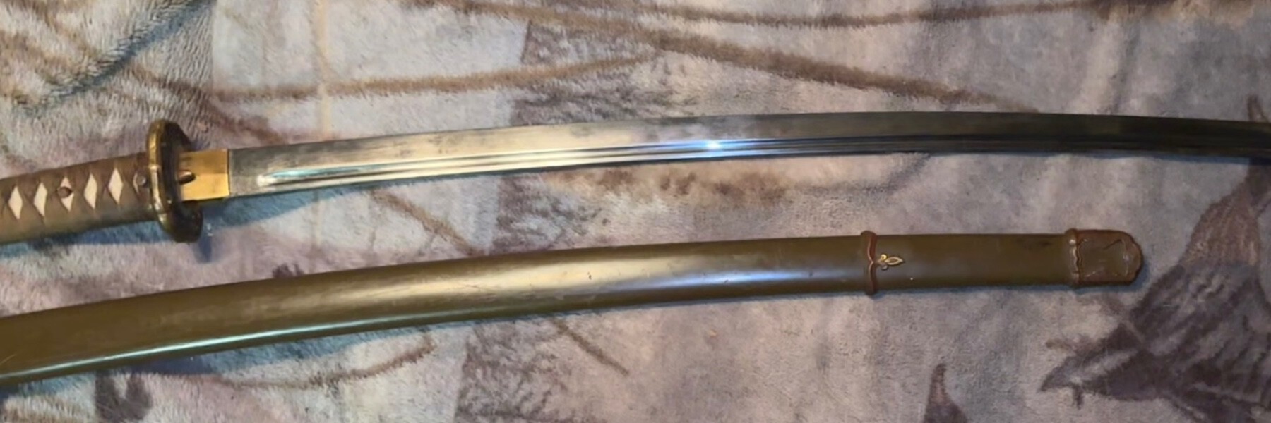

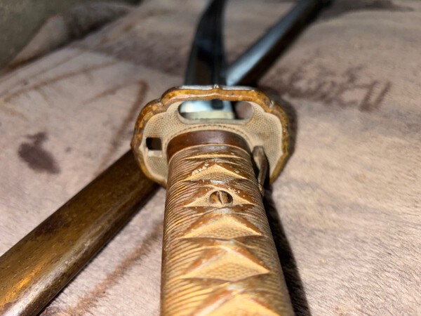

Mike Murphy Posted September 7, 2025 Report Posted September 7, 2025 Just picked up this NCO type 95 and would like some help identifying it. Serial no. 140959 read with blade tip upward. Wont let me unload more pictures Thanks, Mike 1 Quote
Scogg Posted September 7, 2025 Report Posted September 7, 2025 Hi Mike @Mike Murphy, and fellow Oregonian, I'm going to relocate your post here to the Military Swords of Japan section, because I think you'll get more and better feedback there. You have what looks like a genuine Type 95 NCO Shin-Gunto, but I would love to see more photos to confirm. Your specific sword bears the "Sakura Ichi" stamp, the Tokyo First Arsenal supervisory section stamp, and the four cannonball kokura stamp. Your sword was made in ~1942 according to my interpretation of my records. Does the scabbard have a matching serial number? If you have any questions, please let me know. All the best, -Sam Quote

Scogg Posted September 7, 2025 Report Posted September 7, 2025 Yours is the “pattern 2” variant, with aluminum handle and brass tsuba, which is desirable. A mismatched scabbard hurts the value a little, but it is pretty common. I typically see matching sets go for between $750 and $1250, and sometimes more; so I would think around the lower end of that range. They are pretty collectible, and make for great displays. Depending on condition and the motivations of the buyer it could go for more or less. All the best, -Sam Quote

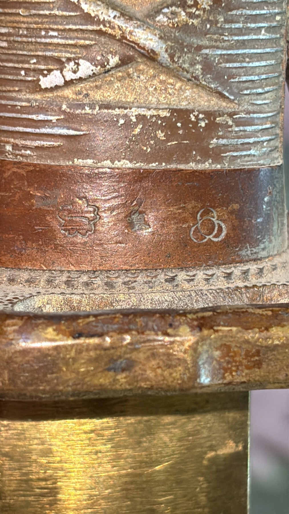

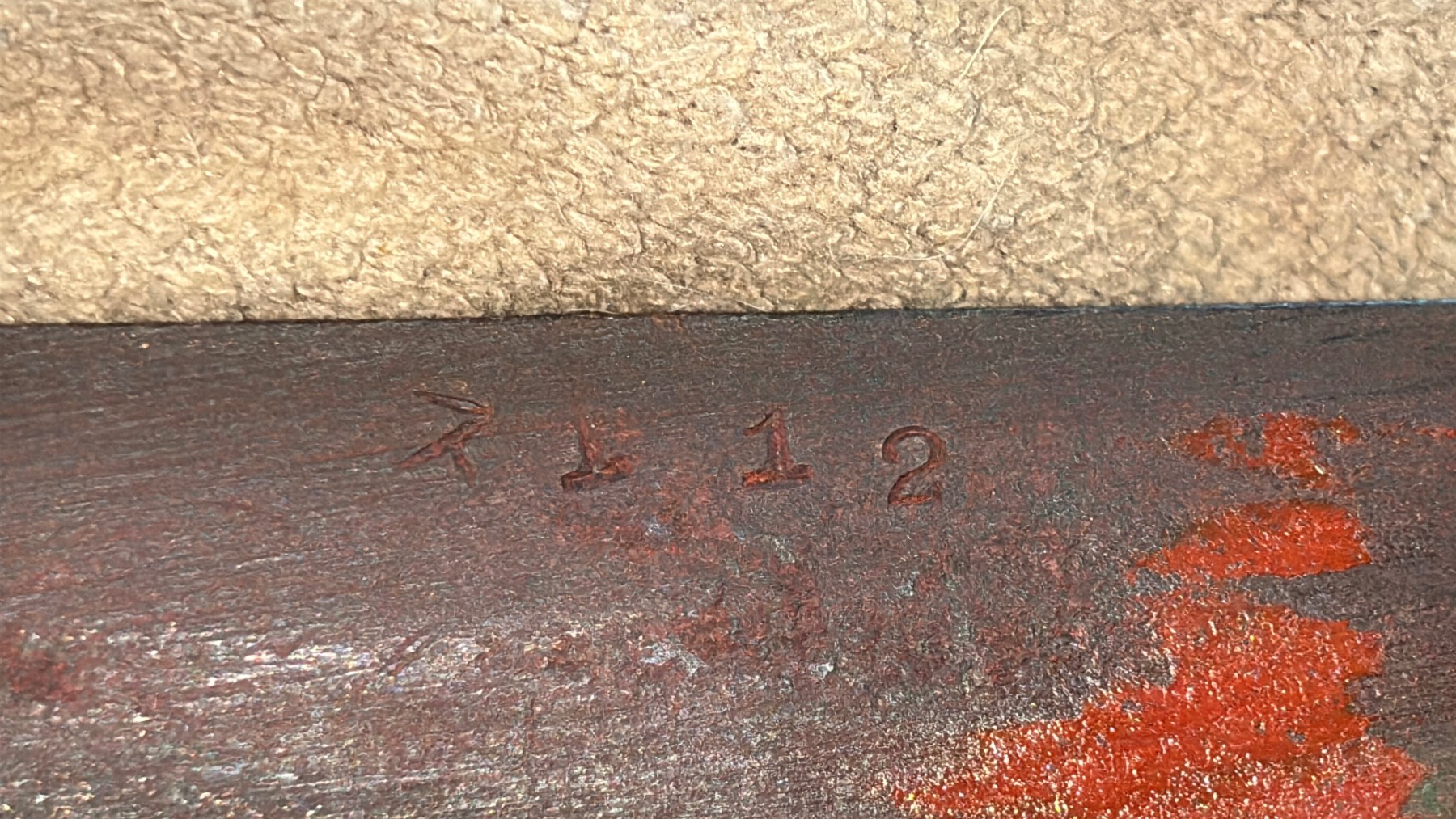

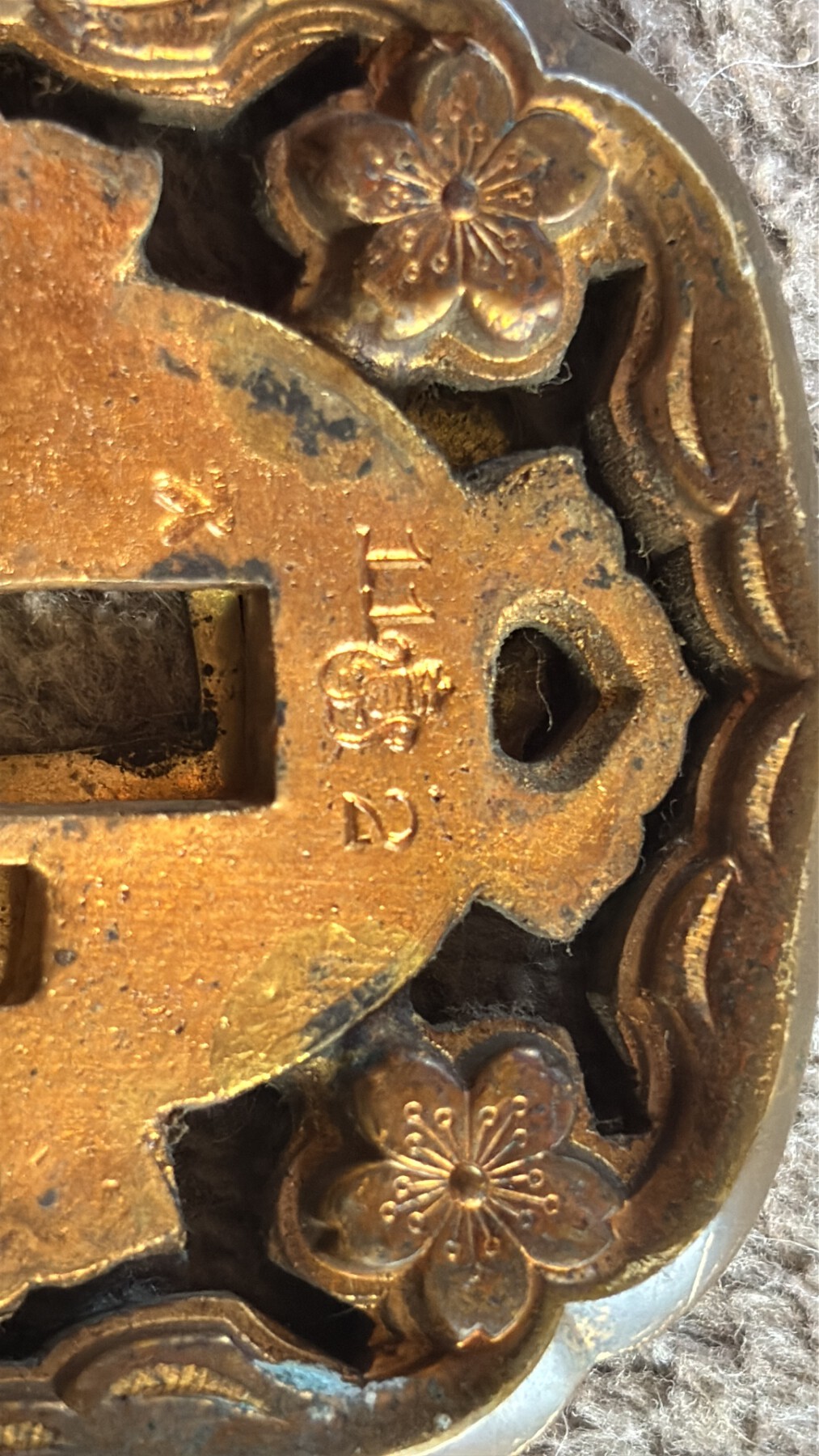

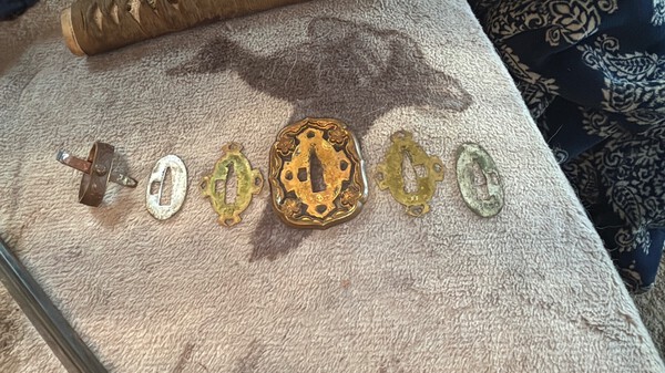

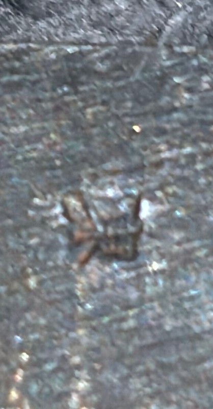

Mike Murphy Posted September 14, 2025 Author Report Posted September 14, 2025 Ok, here is another one. A type 98. Matching serial numbers 112 with figure shown and on the tang a different figure followed by 112. None on the scabbard that I can find. I don’t know why, but all I can do is insert two pictures so here’s 2 showing the markings. Bottom mark is on the tang edges maybe someone can tell me how to reduce the size of my pictures or how to upload more pictures. Thanks, Mike Quote
Conway Posted September 15, 2025 Report Posted September 15, 2025 The mark on the tsuba is the trademark of the company Suya Shoten (listed in figure posted above by Bruce). The second stamp on the tang looks like it could be a “to” stamp 東 for Tokyo First Arsenal. Does this sword by chance have a fullered blade also? A better picture would help in correctly identifying the stamp. 1 Quote
Mike Murphy Posted September 15, 2025 Author Report Posted September 15, 2025 The blade is fullered Quote
Conway Posted September 15, 2025 Report Posted September 15, 2025 The stamp is the katakana ス and is sometimes a production sequence prefix. 112 could be part of the sequence, but it could also just be a number used to keep the koshirae and blade together during assembly. I would like to see more pictures of the whole sword, once you have the photo re-sizing figured out. Quote

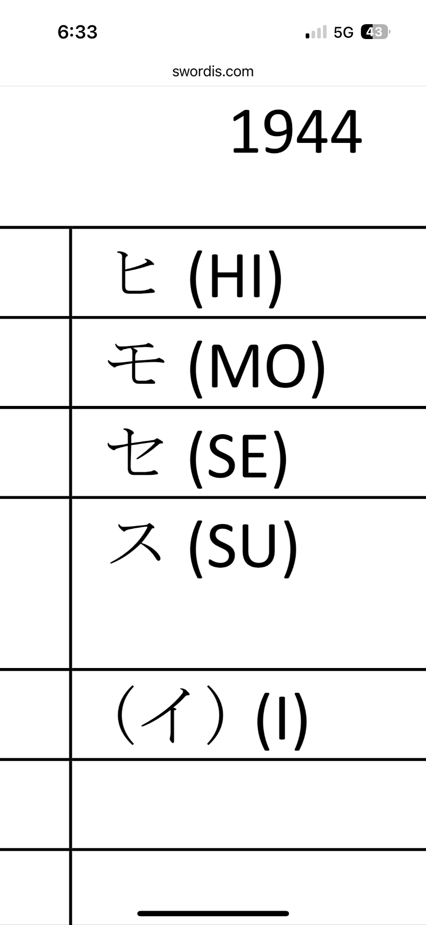

Mike Murphy Posted September 15, 2025 Author Report Posted September 15, 2025 The katakana that looks like a seven with a tail on it I found that designates 1944. The other Mark is the to for the Tokyo first arsenal. Quote

Leen Posted September 15, 2025 Report Posted September 15, 2025 Zoheito, non traditional, mass produced blade (like the type 95) in good quality type 98 (suya shoten) mountings. Also mentioned on ohmura study net 3 Quote

Bruce Pennington Posted September 15, 2025 Report Posted September 15, 2025 13 hours ago, Mike Murphy said: Mike, What is this a photo of? Which part? Also, could you let us know where you found that katakana represented 1944? Here's a couple tips on resizing photos: Here is a search for free online photo resizing: Free online image resizer Quote
Mike Murphy Posted September 15, 2025 Author Report Posted September 15, 2025 That is the upper left side of the tang and the symbol in front of the numbers why with leg indicates 1944. Su symbol Quote
Kiipu Posted September 15, 2025 Report Posted September 15, 2025 That is coming from Bruce's Mantetsu study and does not apply to your sword. 1 Quote
Bruce Pennington Posted September 15, 2025 Report Posted September 15, 2025 Ah, yes, thanks Mike & Thomas! The I RO HA numbering system has been seen in other industries and manufacturing systems, but that particular one tied to the SMR Mantetsu blade operation is specific to their work. Other shops using it would have had completely different cycles as they moved through the katakana. It's like Westerners using "A,B,C's" in a numbering system. A 1-100, B 1-100, C 1-100 for bicycles; whereas a hammer shop might have A 1-2,000; B 1-2,000; C 1-2,000; etc. Hope that makes sense. Quote
