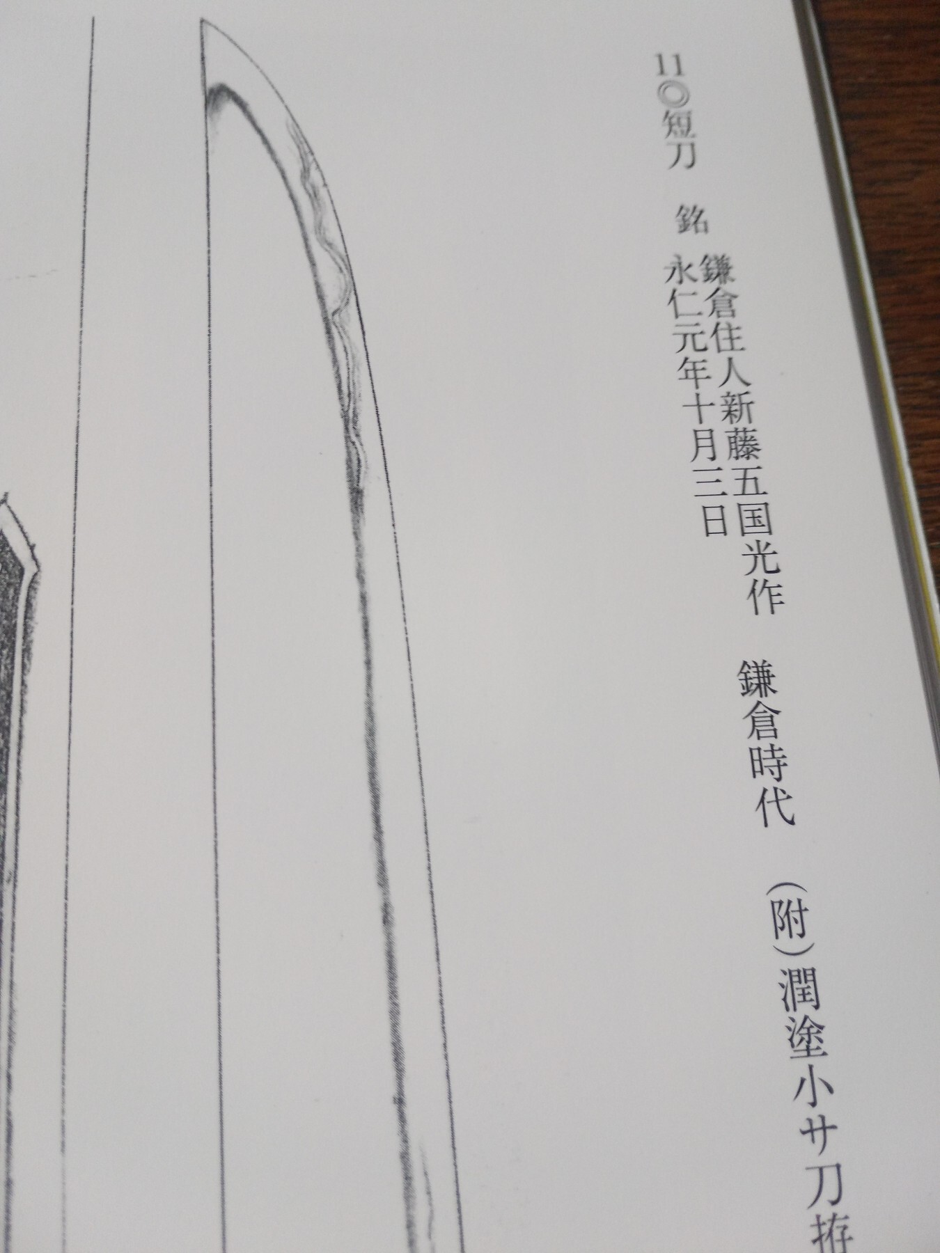

I don't think thats correct. This is the date inscription which I interpret as a year in Showa (Showa 2? [1314]).
Not the same. The one you quoted is dated from Showa 4 not showa 2?.(1315)

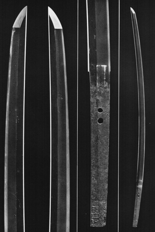

With regard to the zaimei Shintogo Kunimitsu tachi…well, there are more than one. Of course they are a great rarity but I think I have records of 5-6 such zaimei tachi. And
it is very possible that Jussi might have unearthed more with his visits to shrines and temples and perusal of old records.
I attach some of the examples I have records of.
Of these, on a couple of occasions,  I have been privileged to hold and study the last blade (TokuJu, one ana). It is an extremely fine blade, with sophisticated and fine jiba and in no way inferior to his tanto ( I have studied some in hand and various behind glass). So, I am not sure to which [inferior ibid.]  tachi the Koza refers in the excerpt above.

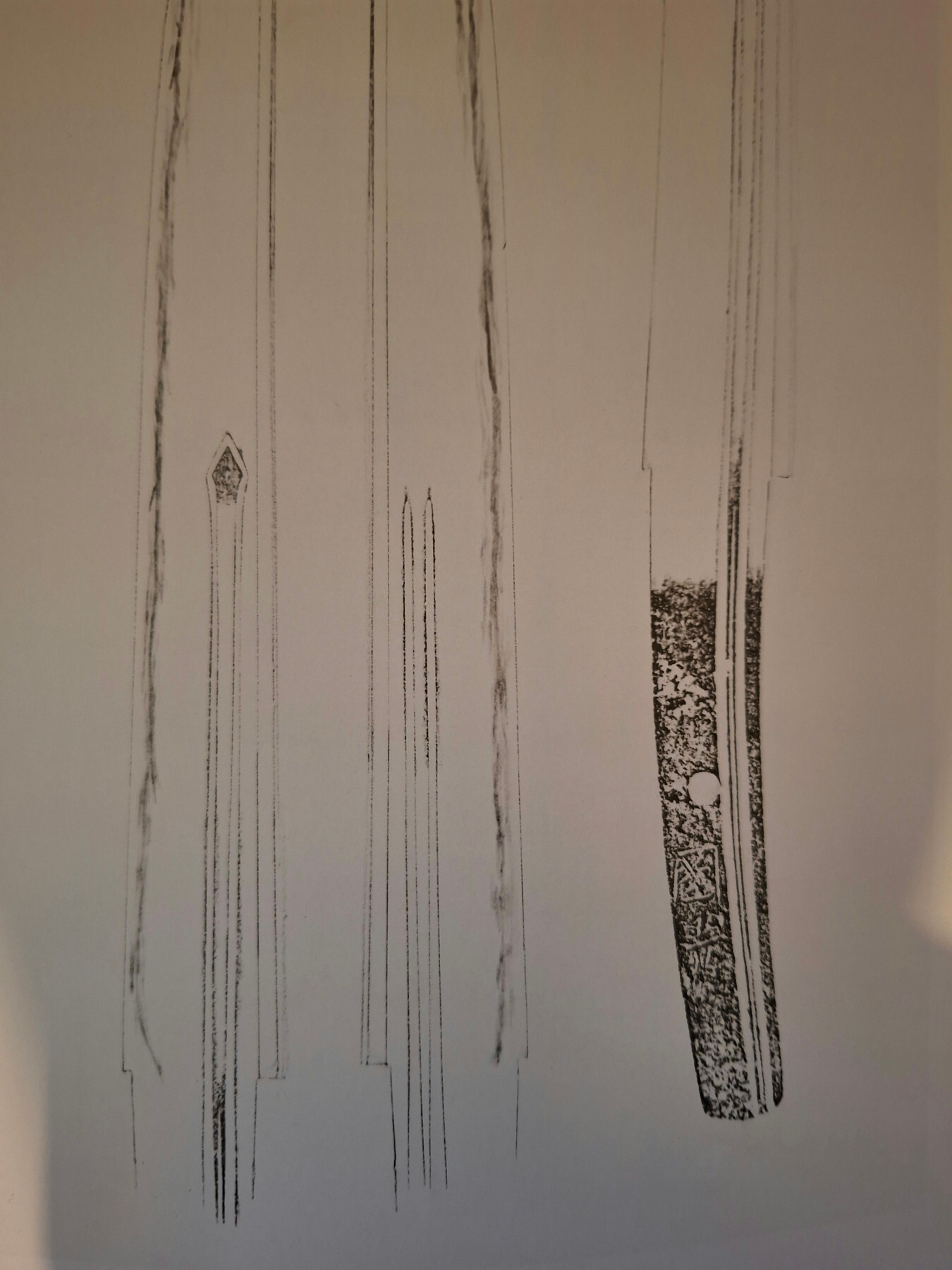

On 20/10/2025 at 22:07, Lewis B said:
I wanted to point out that the two blades on the right are from the Enju school.
