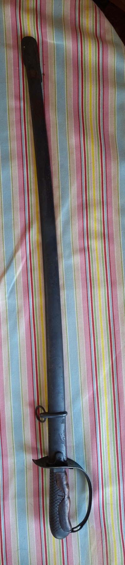

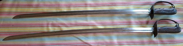

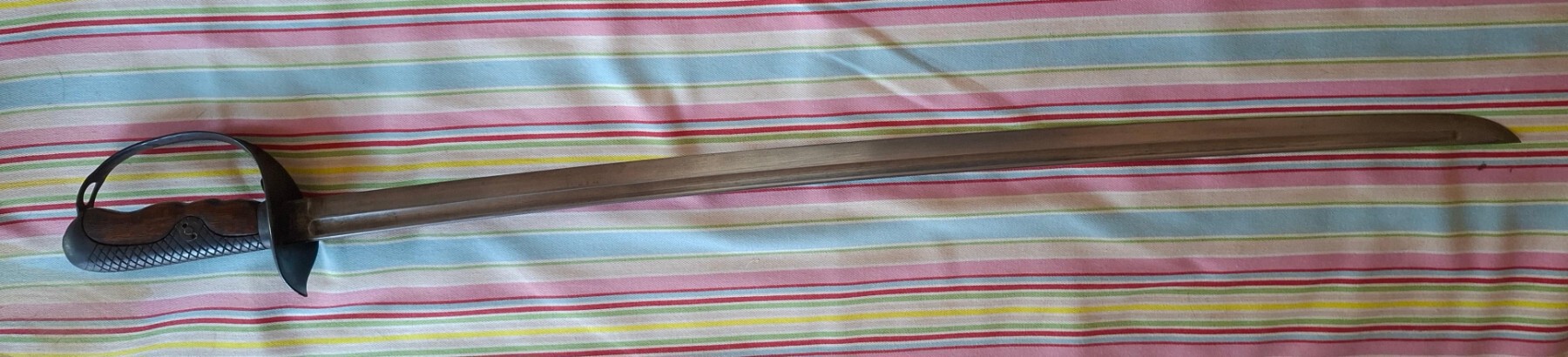

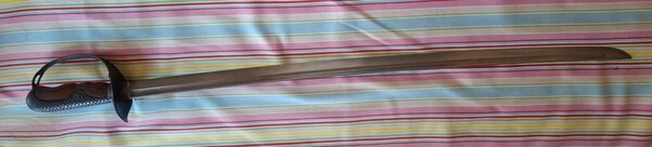

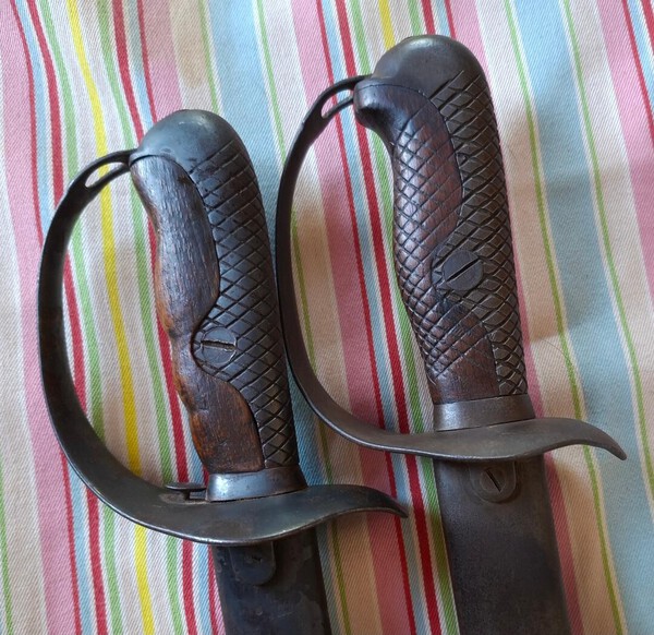

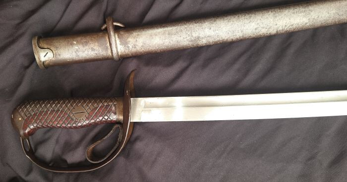

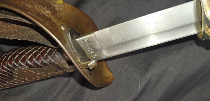

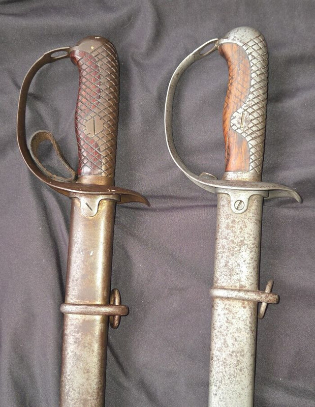

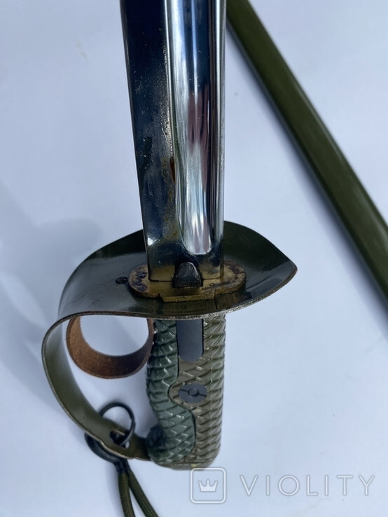

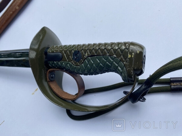

Scogg Posted Saturday at 02:05 PM Report Posted Saturday at 02:05 PM Found this at a militaria show for a great price, and decided to add it to my collection. I know a little bit about these and have read all the ohmura material. Saya number does not match. Can anyone put a date on it based on the stamps and serial number? Otherwise mostly just show and tell! Enjoy! Neat sword. -Sam 3 1 Quote

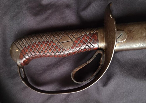

Bruce Pennington Posted Saturday at 02:37 PM Report Posted Saturday at 02:37 PM That's a nice one, Sam! Be careful with putting your finger in the leather loop. I have one that broke on me after doing it a few times. Some of the stamps can be dates, but I don't think yours are, just inspection marks. I could be wrong, though. Best to wait for @Kiipu, or one of the other guys that study these. 1 Quote
Scogg Posted Saturday at 03:57 PM Author Report Posted Saturday at 03:57 PM Thanks Bruce! The first thing I did when I got it home was gently apply a thin layer of antique leather conditioner to the leather loop. Hoping to rehydrate and strengthen it a bit so it lasts another ~100 years. It’s a nice addition to have next to my 95’s. A nice visual aid to help tell the story of the inception of the Type 95 sword. Now I just need a copper that won’t break the bank; and maybe a Ko to keep the Otsu company. I’m sure I can think of more swords that I want too -Sam 1 Quote
Kiipu Posted Saturday at 06:42 PM Report Posted Saturday at 06:42 PM 4 hours ago, Scogg said: Can anyone put a date on it based on the stamps and serial number? The early Otsu Type 32's were undated. Later on, a date was added above the arsenal symbol. The earliest dated 乙 [Otsu] I know of is serial number 66604, dated 明四〇 [1907]. Based upon the serial number of 63703, I would guess it was made sometime during the Russo-Japanese War of 1904-1905. As Bruce already indicated, the "stamps' are final inspection marks. One of which seen is 田. 1 1 Quote

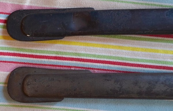

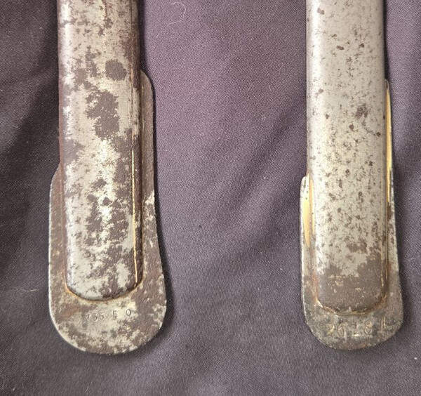

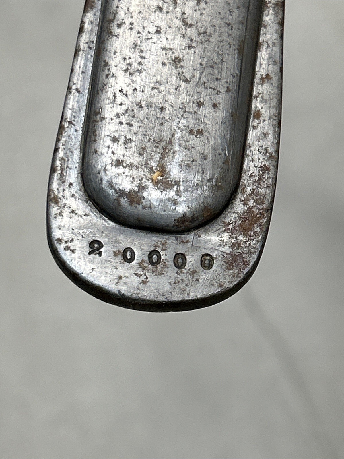

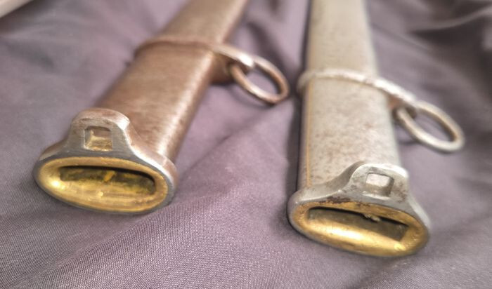

Kiipu Posted Saturday at 07:15 PM Report Posted Saturday at 07:15 PM Can you measure the scabbard drag thickness for me? Also, does the scabbard throat have an extension lug or is it flat? Quote
Scogg Posted Saturday at 07:21 PM Author Report Posted Saturday at 07:21 PM (edited) Thank you so much Thomas! Very cool. You’ve been a huge help. I owe you big time. -Sam edit, just saw your request. Stay tuned Edited Saturday at 07:21 PM by Scogg Quote

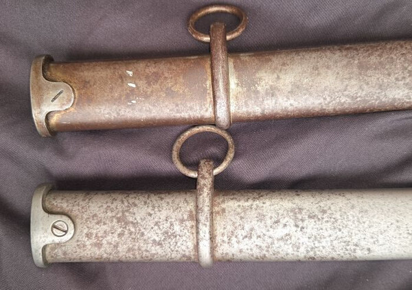

Kiipu Posted Saturday at 07:45 PM Report Posted Saturday at 07:45 PM Thanks Scogg. The drag thickness is 36mm and the scabbard throat is flat (versus having a lug). In my experience, the flat scabbard throat is more uncommon. You will learn more about why I asked these questions when you have a chance to read Nick's threads. As a general rule, the following blade and scabbard information is needed when reporting a Type 32. Blade Length (Version): 甲 Kō or 乙 Otsu. Serial Number: Sequential serial number starting at 1, stamped in Arabic numerals. Fullered: Yes or No. (FYI, all are fullered but I ask anyway.) Finish: White, Blued, Black oxide, Painted black, or ?. (They all started out as white.) Saya Serial Number: Original serial number, rematched SN, mismatch serial number, none, ?. Scabbard Throat: Extension lug, or Flat, or ?. Drag thickness: in millimeters. Finish: White, Blued, Black-oxide, Painted black, Chrome, Textered, or ?. 1 Quote
