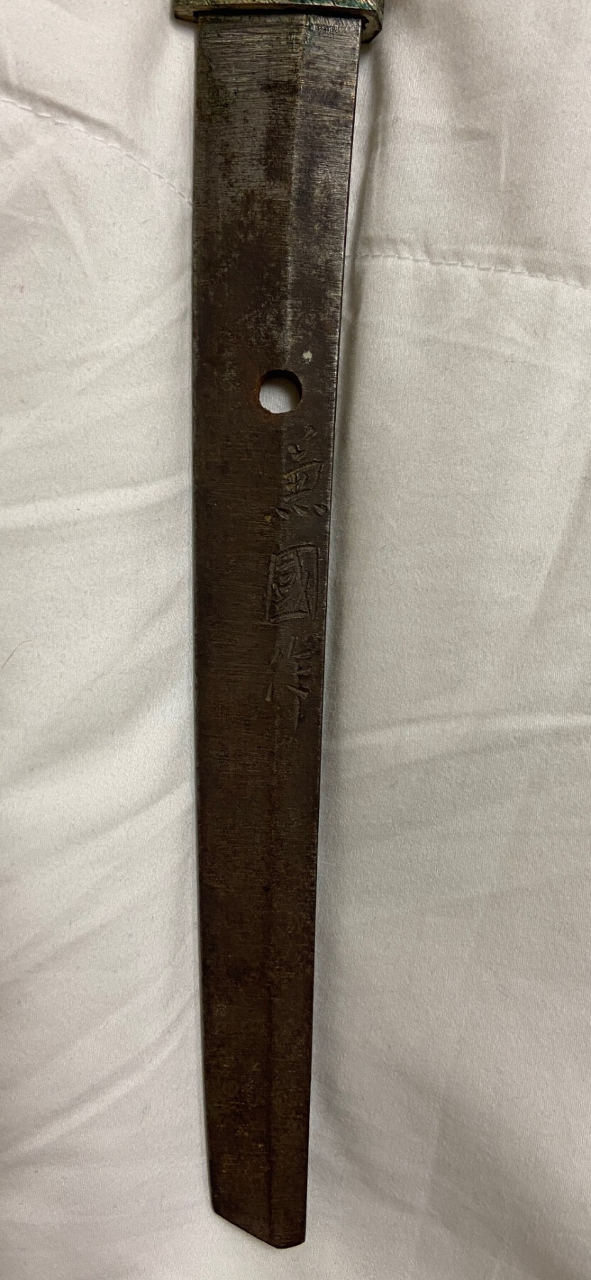

Nicholas Posted May 26 Report Posted May 26 So this would be 2nd gen Kanekuni from the Ogawa line? 1 Quote

mecox Posted May 27 Author Report Posted May 27 Nicholas, your blade looks like Ogawa Sentaro Kanekuni. Quote
Nicholas Posted May 28 Report Posted May 28 4 hours ago, mecox said: Nicholas, your blade looks like Ogawa Sentaro Kanekuni. Sentaro, so that would be the first Kanekuni. Interesting I always thought it was the 2nd gen Ogawa Ichiro who made this sword. I haven’t seen many wartime era swords by Kanekuni. Quote
mecox Posted May 28 Author Report Posted May 28 Well I have not seen your sword, and he did die in 1939, but I was going on the way the Kane-kuni is cut. Looks to me also the one in Slough p. 45. Quote
