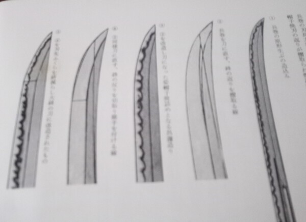

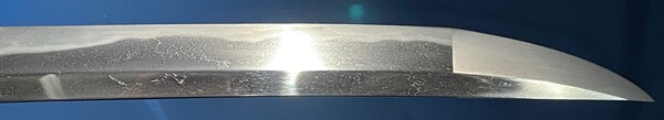

Jacques Posted April 18 Report Posted April 18 Once again, demonstrate to me that it's possible to keep a kaeri on a naginata naoshi (what technique is used) I know of only one exception (picture attached). Having said that, I wonder if NBTHK isn't lumping everything into the same basket : true naoshi and made as if... Quote

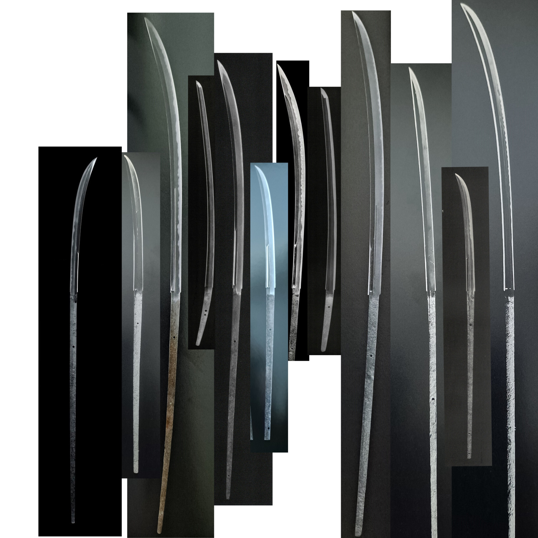

Jussi Ekholm Posted April 19 Report Posted April 19 I do think Jacques does have a good point, and what he says is true in general. Of course I do think Jacques often is very extreme in his views and I tend to think there is a lot of grey area. When talking about naginata I personally include all the bladed single edged polearms into this. I think the more terminology we add in the more complicated it can get. I have followed some discussions about details in blades and it often seems people understand the things differently. Just want to point this out that when I talk and about naginata this is what I mean. Of course it is also very thin line between some ōdachi types and naginata. You can see some very large flaring of the tip on the Tadatsuna naginata Jacques presented and the Sukesada naginata that me & Piers posted. Personally I am not a big fan of that naginata blade style. However it is of course a historical blade style proven to be effective as it has been used for long time. Remodeling naginata of this style would be tricky as Jacques has explained. Now I spent probably close to 2 hours creating this following image. This has 10 different naginata from Kamakura & Nanbokuchō periods, with 1 75 cm tachi by Awataguchi Kuniyoshi and 70 cm katana by Hizen Tadahiro as reference items to show how massive some of these polearms are. I have seen 5 of the naginata in this picture (marked with X) and the true size of the big ones if difficult to explain in picture. The original image I have is about 21MB so I downsized this one. I was counting the scaling roughly by pixels, it is not 100% correct but I would say something like at least 90% accurate. 1. 51,5 cm - Kagemitsu (1322) (Tokyo National Museum) X 2. 52,4 cm - Norishige (1325) (Ōyamazumi Jinja) X 3. 95,7 cm - Katayama Ichimonji (Uesugi Jinja) 4. 75,5 cm - Awataguchi Kuniyoshi tachi (TJ 15) 5. 83,1 cm - Shikkake (TJ 26) (Jacques posted this earlier) 6. 42,8 cm - Ryō Hisanobu (1308) (Tokugawa Art Museum) 7. 80,6 cm - Hōjōji (Ōtaki Castle Museum) [this one actually has 131 cm tang but I have not got a picture anywhere that would show it in full length] 8. 70,5 cm - Hizen Tadahiro Katana (TJ 14) 9. 98,0 cm - Kanemitsu or Yoshimitsu (Futarasan Jinja) X 10. 80,1 cm - By legend Tomoe Gozen naginata, in reality Nanbokuchō naginata (Ōyamazumi Jinja) X [nakago was cut off a bit in photo] 11. 44,2 cm - Nagamitsu (Sano Art Museum) 12. 101,4 cm - By legend Benkei naginata, in reality Kamakura - Nanbokuchō naginata (Ōyamazumi Jinja) X [Nakago was cut off in photo] 1 9 1 Quote
atm Posted April 19 Report Posted April 19 Bravo @Jussi Ekholm. For me as a relative novice, your composite image really puts these sizes into perspective. 1 Quote

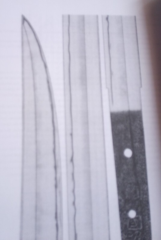

Jacques Posted April 19 Report Posted April 19 Quote I think Jacques is getting fixated on the very deeply curved naginata with large heads which flare out too much. These cannot be reworked without yakitsume. The more modestly curved ones with not much flaring-out clearly can and have been, in the past, reworked with the kaeri remaining. When you have one hundredth of the skills of the author of this drawing and the book from which it is taken, maybe you can talk. Quote
Lewis B Posted April 19 Report Posted April 19 1 hour ago, Jacques said: When you have one hundredth of the skills of the author of this drawing and the book from which it is taken, maybe you can talk. A swing and a miss. Again. You are choosing examples that prove your point. What you refuse to see are the examples above that have different style of boshi such that if the blade was modified to naginata-naoshi, a small kaeri could be retained. Quote
Jacques Posted April 19 Report Posted April 19 I already quoted it. Have a look at the location of the boshi, i guess before naoshi the boshi was almost ichimai. Nothing to do with your examples... Quote

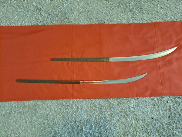

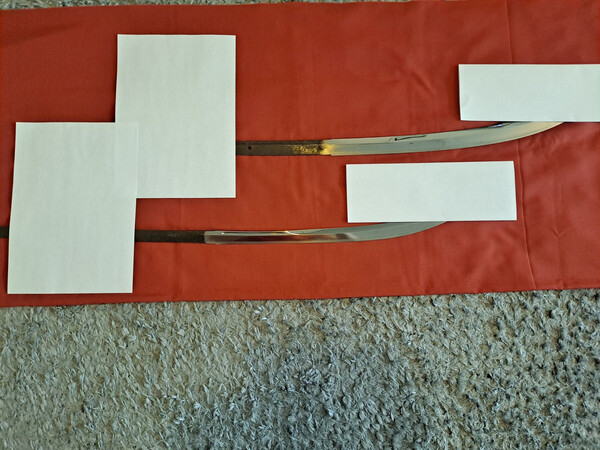

Jacques Posted April 20 Report Posted April 20 I found these 2 naginata the first one is by Nagamitsu (Kamakura Bizen) the second one is by Kagemitsu (Kamakura Bizen) it is obvious that if you practice a naoshi on these naginata the boshi will disappear (Same for all the examples I already shared) Quote

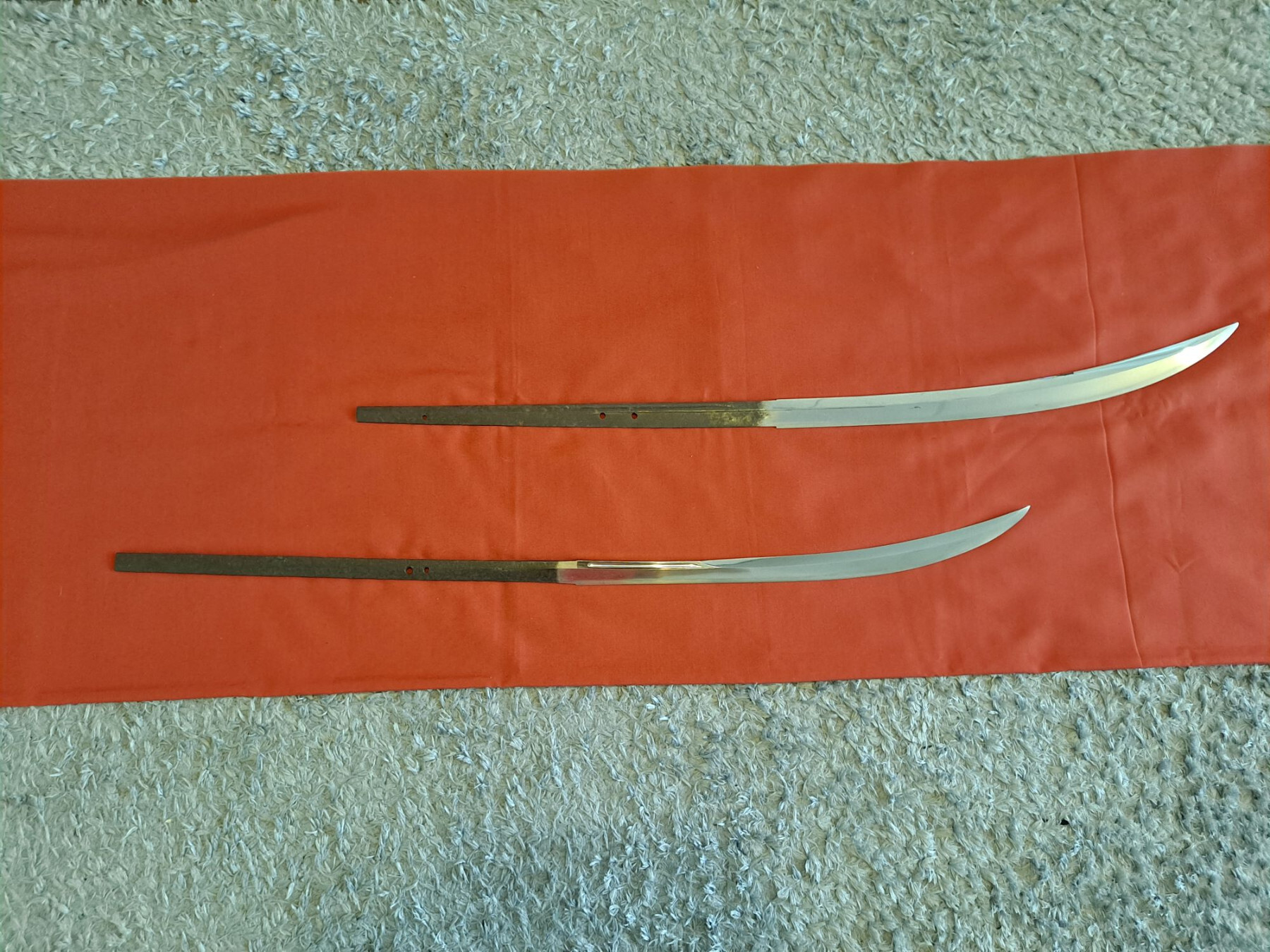

Jussi Ekholm Posted April 20 Report Posted April 20 I am fortunate to have 2 Nanbokuchō naginata Yoshikage is ubu and the Ko-Uda attributed one has been shortened in my opinion by about 20 cm but it is still judged as naginata by NBTHK. As we were discussing about naoshi earlier and what naginata would be good candidates for successful process I don't think either of the two I have would be very good end products as swords. Both of these have quite late curvature so it might not be ideal for repurposing. Also the physical size of these might make these bit awkward to be used as wakizashi. The Ko-Uda one is currently very tip heavy even with the still long tang, I believe originally it has been quite large weapon in overall. Of course the heavy weight makes it tough to me to figure out how it would be as a wakizashi size item. I am not a swordsman so I cannot give great insight on that. Of course as both of these are shaped as they are I feel the kaeri would be lost if wanting to make an usable short sword shape. The lower Yoshikage is smaller in size. It is actually very similar in size to the Ryō Hisanobu naginata in composite image above. Of course it is almost 100 years younger 1308 - 1389. While it might look to be easy to repurpose on the above picture as it would make a small wakizashi, I show the below pictures to give the idea of the 3D visualization that I was talking about earlier. As you can see it is around 10mm at nakago mune, and around 1mm at cutting portion mune. The items need reshaping in many different parts in order to create a good end result. So if made into a wakizashi it cannot have such a thick nakago in overall and it will have to be reduced a lot in thickness. Really I am not qualified to give insight on how these should be altered I think swordsmiths and polishers would be the best ones to answer. Then people practicing sword arts could give their view on how the altered naginata will feel when used as a sword in comparison to swords that were made as swords to begin with. 4 Quote
Natichu Posted April 20 Report Posted April 20 4 hours ago, Jacques said: I found these 2 naginata the first one is by Nagamitsu (Kamakura Bizen) the second one is by Kagemitsu (Kamakura Bizen) it is obvious that if you practice a naoshi on these naginata the boshi will disappear (Same for all the examples I already shared) @Jacques, I don't think anyone above is arguing against the idea that in many, if not most, cases the naoshi process will mean the kaeri is lost. The rule of thumb is likely that one identifying feature of a naginata-naoshi is the fact the boshi is yakizume. However, what I think is being pointed out is this is not inevitable or universal, as there are examples showing exceptions to the rule. That is, blades that have been determined to be naginata-naoshi by a panel of experts with the blade in hand showing an (admittedly) small kaeri. Can I tell you what the process is that leads to this? Not in any meaningful way (we're both well aware of my very limited knowledge base), though my hypothesis would be this is likely possible based in the exact shape and geometry of the original blade, which could vary significantly while still being a naginata. But I would certainly defer to the opinion of the experts with blade in hand in saying clearly it is possible. 1 Quote
