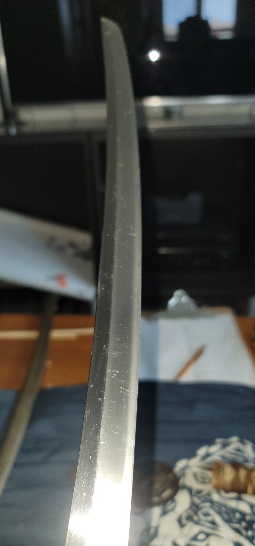

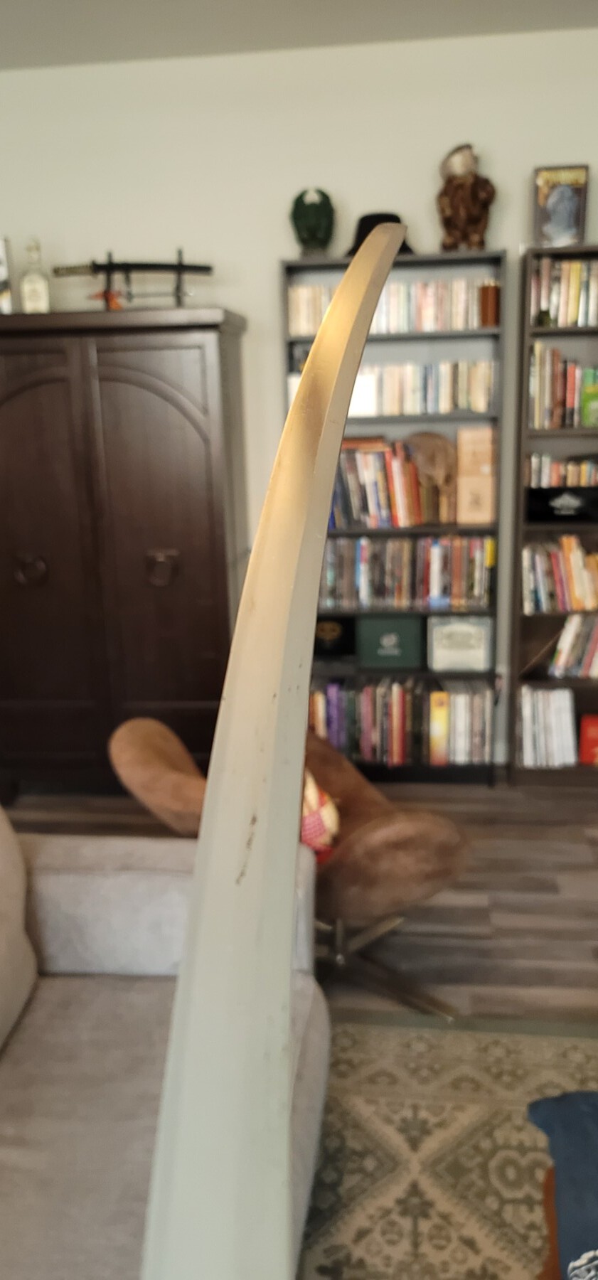

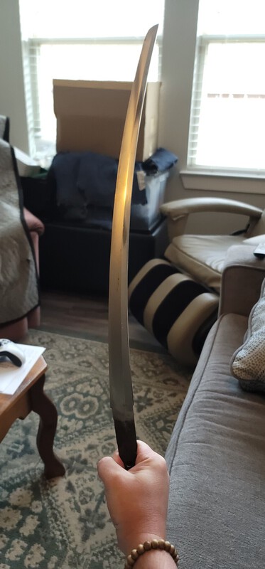

Lf opinions on this. It's hard to see any activity in the hamon or hada, what I can see is listed in the photo of my notes.
I'm thinking osuriage koto probably late kamakura early nambokucho, but I'm not an expert. Any other opinions, school or smith?20250330_123112.thumb.jpg.e0f6d2b52afac055b8baedec9a8ae221.jpg20250330_123631.thumb.jpg.56abea5ceb86728cd3ea28b40b880c5c.jpg

It is very hard to judge this blade based on the images given. You need to find a source of light and point it at an angle that does not immediately reflect off the surface.

I can try but it's way out of polish. Like I mentioned it's hard to see any activity even in person. Like I noted on the paper, it looks like a komaru boshi, itame hada and it's got pretty decent fumbari.
This belongs to a half Japanese freind who inherited it from his grandfather. He's wanting to know more about it as it came to his possession with no backstory or documentation. Any guesses or rough estimations are welcome.
Taking pictures of nihonto during daylight does not work. Evening, confined lightsource, blade on the table, camera and light source positioned for maximum effect.
As of now sugata looks like Muromachi uchigatana. With such curvature to be Kamakura you basically have to aim for kodachi... that does not look like a perfect match.
Its a style which unfortunately exceptionally hard to judge. Even in hands and in good polish.
If you want to be super-optimistic, pursue Kamakura Rai Kunitoshi kodachi option. I don't believe that's the case, but...
Otherwise its Muromachi uchi-gatana. Can be a variety of schools, we don't see jigane unfortunately and that's the main distinguishing factor... Ryokai, Fuyuhiro. Mihara would probably have longer kaeri or altogether different boshi, Enju tends to be quite different in Muromachi and also boshi, Zenjo is possible though not the most typical. At times Kaga can also be considered.
Lots of options and not much difference since mumei Muromachi pieces in 80% of cases are judged with thinking "its more or less the same".
I agree, I don't personally see evidence of suriage with the provided images. Looks a little machi-okuri, though.
My kantei still needs some work, but your swords sugata and kissaki remind me a lot of a wakizashi that I have from around the early 1500s.
My best guess would be Muromachi.
