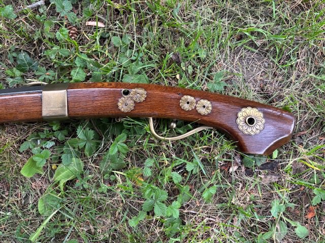

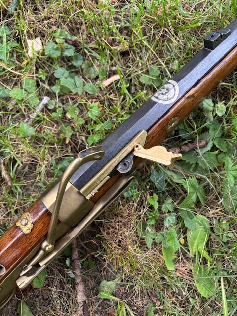

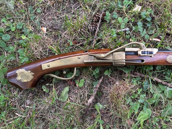

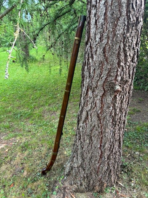

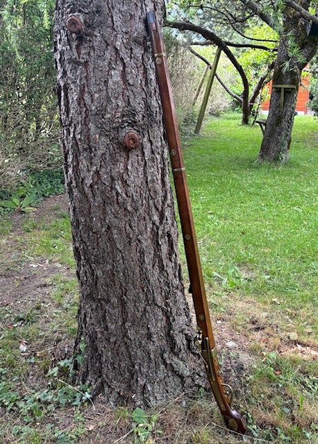

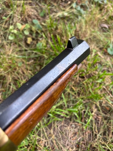

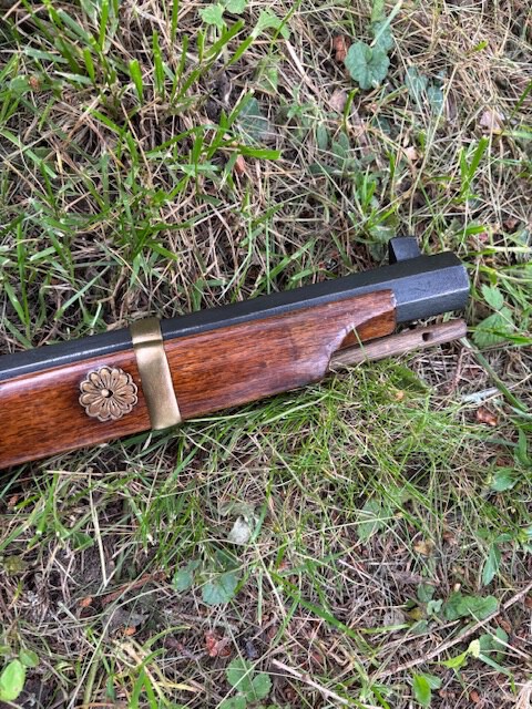

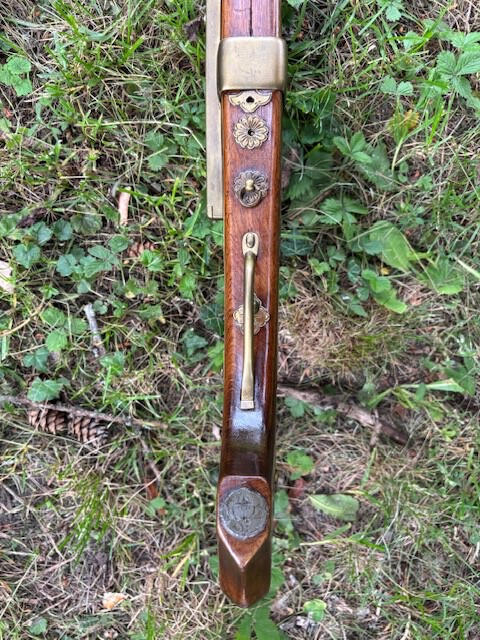

Fabian23 Posted June 1, 2025 Author Report Posted June 1, 2025 Folks, the project is 99.9% complete. I applied a few layers of cold blue to the barrel which has turned a very pleasing dark bluish grey, like a faded blue which fits the overall patina of the piece very well. During the process I discovered that there is a silver(?) bead on the rear of the front sight, which is a nice touch. The barrel is pinned with whittled down bamboo BBQ skewers. The lock is now also tuned to catch the cock safely and it snaps down gently but swiftly upon release. All I need to still do is source a new rod since the original snapped at some point and is missing about 3”. I may take a few shots with it eventually. 5 Quote
Fabian23 Posted June 16, 2025 Author Report Posted June 16, 2025 Took it to the 50m range today using what components I had at hand. .450" lead round ball Doubled up .34mm patches, the outer one greased. Guestimated load of 50gr Swiss 2 BP (FFFg) Once I figured out the average point of aim it was reasonably easy to hold the black. Certainly accurate enough to pick a specific target out of a crowd. Once the match is burning well the lock is very fast and reliable. Recoil is a short tug on the cheek, not painful at all. Next I shall seek out slightly larger musket balls so that I can just use one patch. The powder load seems about right for 50m and may switch to a coarser grain. 1 3 Quote
