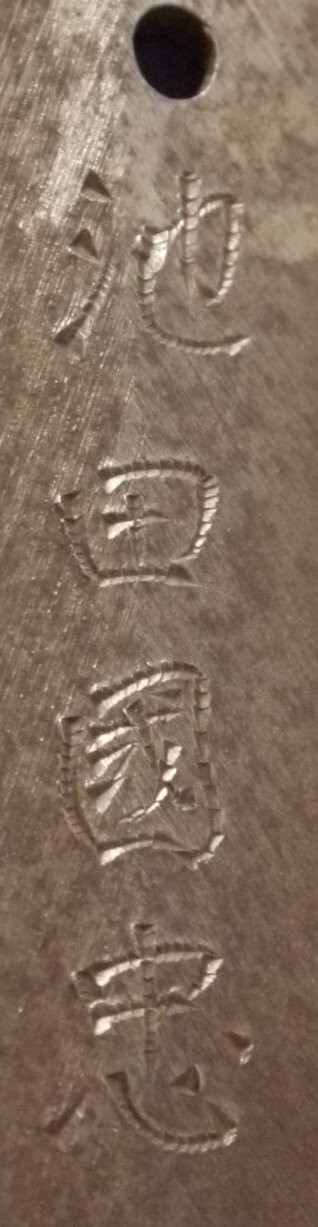

Suci Posted October 13, 2024 Report Posted October 13, 2024 Is anyone able to help me confirm or otherwise this is signed "kuni sada" please? Thank you Suci Quote
Ray Singer Posted October 13, 2024 Report Posted October 13, 2024 The smith is Kunitada. https://www.google.com/search?q="ikeda+Kunitada"&oq="ikeda+Kunitada"+&gs_lcrp=EgZjaHJvbWUyBggAEEUYOTIHCAEQIRiPAjIHCAIQIRiPAtIBCDg3MDVqMWo0qAIOsAIB&client=ms-android-google&sourceid=chrome-mobile&ie=UTF-8 1 Quote

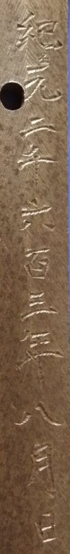

Suci Posted October 13, 2024 Author Report Posted October 13, 2024 Thank you Ray There are no stamps next to the signature; is that a sign the blade is better quality please? Is the date also August 1943? 1 Quote
Ray Singer Posted October 13, 2024 Report Posted October 13, 2024 Yes, that is the date and this appears to be a gendaito (a traditionally made Japanese sword from that time period). Quote

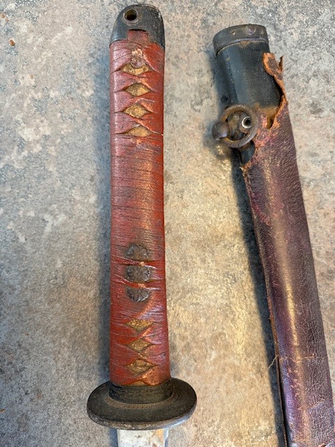

Suci Posted October 13, 2024 Author Report Posted October 13, 2024 Bless you, thanks again Ray. One last by the by question. The blade was secured in the grip by two steel bolts (that had seized), not pegs. Is that normal? Likely Japanese done or the British soldier that brought it home? We had to ask a friend to drill the bolts out and am glad now that we did. Quote
Ray Singer Posted October 13, 2024 Report Posted October 13, 2024 Please show photos. Type 3 gunto koshirae had two screws. Both the normal mekugi-ana and a second shinobi-ana at the bottom. Those screws are rare and desirable. If you have photos of the mounting and the screws or bolts that were previously there, please share here in the post Quote
Suci Posted October 13, 2024 Author Report Posted October 13, 2024 Hello Ray. Oh, or rather "Oh no"; the bolts got binned, the nuts are still there behind the ito (can not photo the smaller one as secure behind the ito). Rare? Should I go through the garbage to see if I can find the smaller bolt? They were basically non-descript flat head screw bolts. The nuts were / are different to what you normally see. Quote

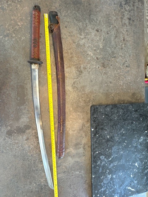

Conway Posted October 13, 2024 Report Posted October 13, 2024 Did the screw look like this? Can you post a picture of your sword? Quote
Suci Posted October 13, 2024 Author Report Posted October 13, 2024 6 hours ago, Conway S said: Did the screw look like this? Can you post a picture of your sword? Yes, slightly rounded top. I did not see the whole bolts as a friend actually drilled out the big one and threw away the smaller one. Quote

Ray Singer Posted October 13, 2024 Report Posted October 13, 2024 Before we go any further into this, I would still like to see a photograph of the mounting so that we know if we are dealing with a type 3 koshirae. 2 Quote
Suci Posted October 14, 2024 Author Report Posted October 14, 2024 Photos before drilling the bolt out 1 Quote
Ray Singer Posted October 14, 2024 Report Posted October 14, 2024 That is indeed a Type 3 koshirae, and as discussed earlier this is the type where screws are a standard element of the mounting. 1 Quote
Bruce Pennington Posted October 14, 2024 Report Posted October 14, 2024 That bottom one definitely looks like the head was messed up. Might have had to drill it to remove it. But original. If you can't find replacements, many of these are found with bamboo mekugi, and some with a mix of both, so it won't hurt the originality if you decide to replace them with bamboo. Also, I only have 1 other Kunitada on file with stamps. Can you check the nakago mune for Na stamps, please? The other was posted by @Itomagoi, also an August 1943. Quote
