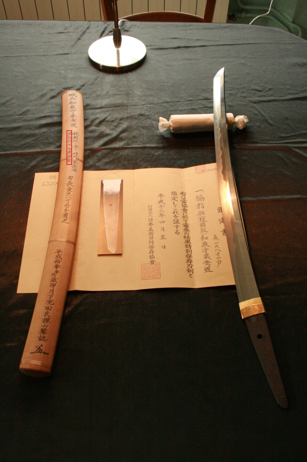

Jacques D. Posted September 12 Report Share Posted September 12 Quote where does the Rai Kinmichi sayagaki say that it is with excellent workmanship? 典型作而出来傑矣 left column 1 Quote Link to comment Share on other sites More sharing options...
Gakusee Posted September 12 Report Share Posted September 12 Got it, thanks! Quote Link to comment Share on other sites More sharing options...
