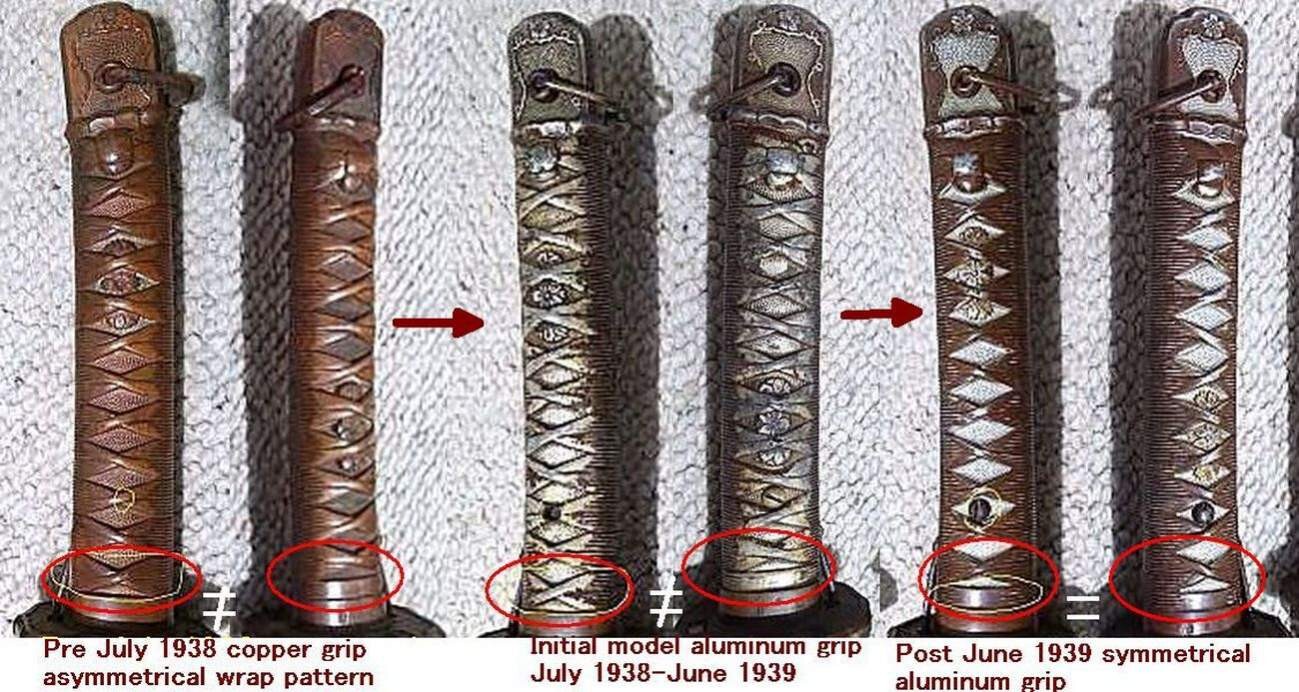

Bruce Pennington Posted April 30, 2024 Report Posted April 30, 2024 Adding photos for those new, coming into the topic From Stegel: I just realized the second photo, middle image, shows production of these from July '38 - June '39. So, knowing how many 95s the industry was making per year would tell us something. 1 Quote

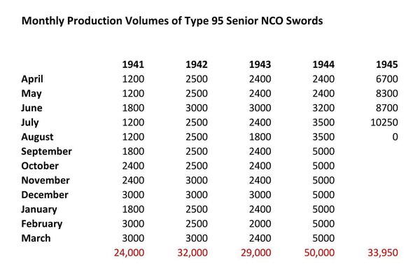

Bruce Pennington Posted April 30, 2024 Report Posted April 30, 2024 The only production chart I have is from 1941-1945 If 1200 is a fair number for previous years, then that should be our estimate for these. Thomas, or Erns has a good idea of the ending copper number, 6700ish?, so if we have a know highest number for the version 1 tsuka ..... 1 Quote

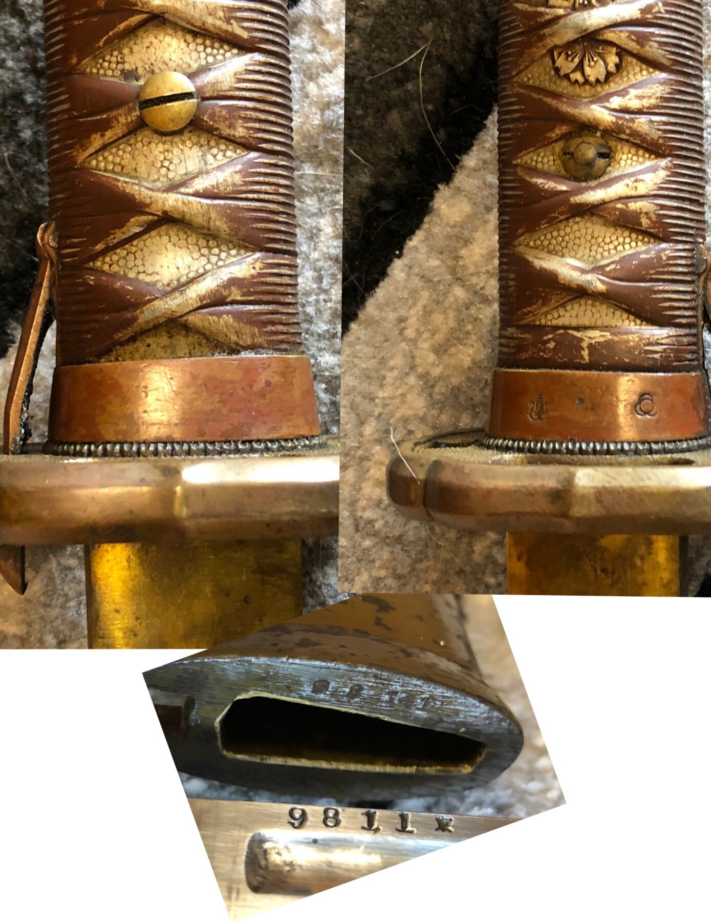

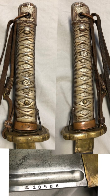

Bruce Pennington Posted April 30, 2024 Report Posted April 30, 2024 I've had 2, serial numbers 9811 and 10506. 1 Quote
Banton989 Posted April 30, 2024 Author Report Posted April 30, 2024 35 minutes ago, Bruce Pennington said: I've had 2, serial numbers 9811 and 10506. 9811 I would count, 10506 is another sub variant I think where they adjusted the ito. Mines 8650 so thats 1161 possible so far? Will do more digging for examples. Quote
Banton989 Posted April 30, 2024 Author Report Posted April 30, 2024 48 minutes ago, Bruce Pennington said: The only production chart I have is from 1941-1945 If 1200 is a fair number for previous years, then that should be our estimate for these. Thomas, or Erns has a good idea of the ending copper number, 6700ish?, so if we have a know highest number for the version 1 tsuka ..... It's 1200 for the month on average isn't it? 24,000 for 1941. I think the number for these is way lower than that though. Production must have ramped up as plans progressed for war? Quote

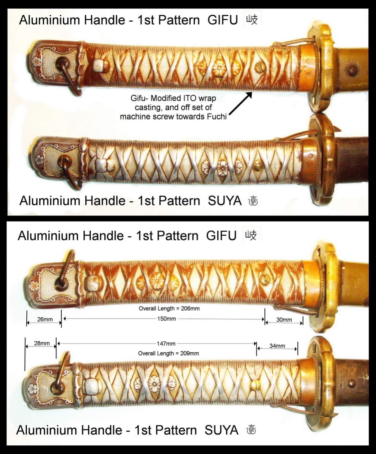

Bruce Pennington Posted April 30, 2024 Report Posted April 30, 2024 15 minutes ago, Banton989 said: 10506 is another sub variant I think where they adjusted the ito It's the Gifu variant of the idea. You can see it in the top photo of Stegel's diagrams. I wish he, or Steve Shamsy, were here. They could clear it all up. But I do think you are right that the years prior to '41 had slightly lower production numbers. 1 Quote

Kiipu Posted April 30, 2024 Report Posted April 30, 2024 The Suya serial number range for asymmetrical hilts is 6787東 to 9811東. Stegel is the only one who can narrow it down further. 1 Quote
