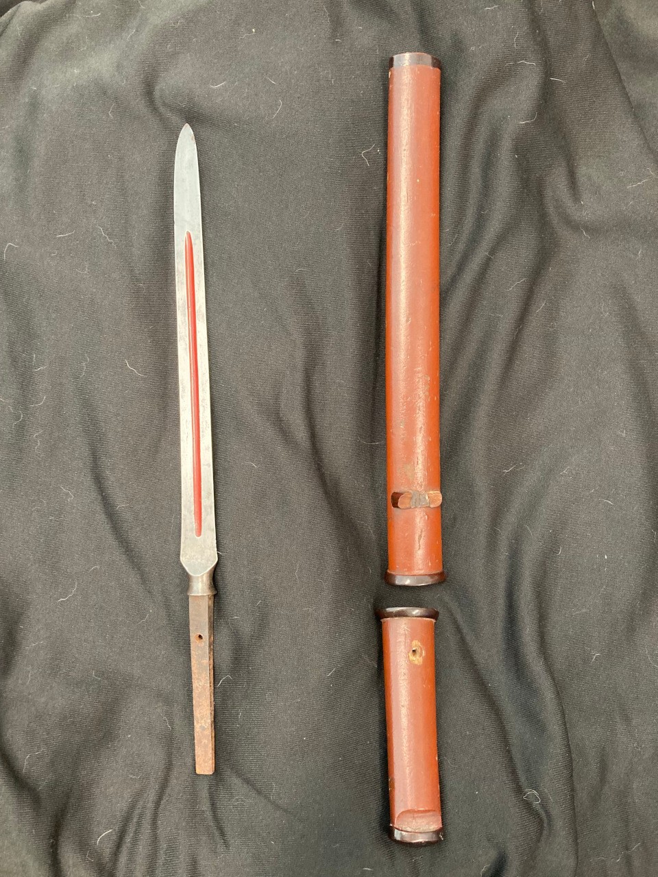

tbonesullivan Posted July 17, 2023 Report Posted July 17, 2023 This came in labeled simply as "Japanese Armor Piercing Dagger", and was mounted in tanto style koshirae. The blade is that of a Sankaku yari, but the tang is quite a bit shorter than I usually see on a yari, and does appear to have had the end of the tang cut off. It's got a Bo'Hi with Red urushi, which I'm used to seeing on pole arms. I checked close up and the blade definitely has lamination lines and such. I guess the question is, is this a normal type of alteration that was done? Is this what could be done if the tang ever broke? Is there an "official" name for this type of weapon? Any help would be greatly appreciated! 1 Quote
b.hennick Posted July 17, 2023 Report Posted July 17, 2023 Yes the yari has been shortened and used as a tanto. They are fairly common. 1 1 Quote
tbonesullivan Posted July 17, 2023 Author Report Posted July 17, 2023 43 minutes ago, b.hennick said: Yes the yari has been shortened and used as a tanto. They are fairly common. Thanks! Do you know if there is any Japanese term for this type of alteration? Quote

Bugyotsuji Posted July 18, 2023 Report Posted July 18, 2023 Uncommon, a hybrid creature, probably designed as a one-off for a spare spearhead, logically and grammatically as above it should be ‘Yari-tantō’, (as a type of Tantō) but I am not sure if this has ever been ‘officially’ decided by anyone. If you called it a Tantō-yari on the other hand, it would be describing a type of yari, (which it is not) but even so, you’d be in the right ballpark and people would probably guess your meaning. Quote
b.hennick Posted July 23, 2023 Report Posted July 23, 2023 Cut down - - suriage, O suriage is used when so much has been cut off that no signature shows Quote
