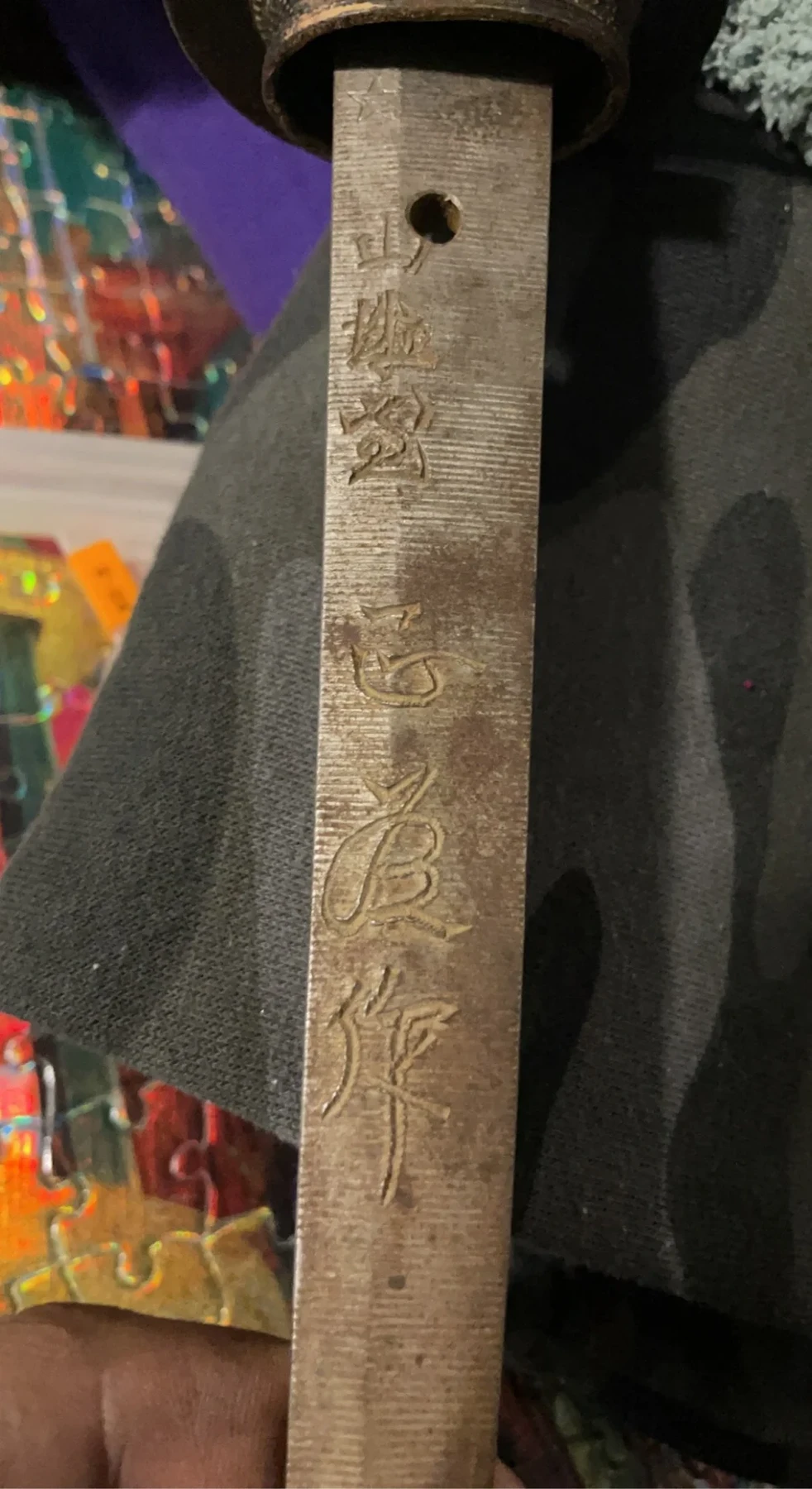

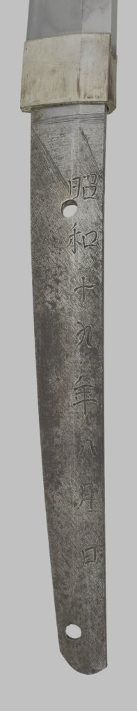

HI guys, me again!  I used Brian's chart for kanji and found the "Sane" - 眞, and seems like tha second is michi - 道, but I don't see a Sanemichi in Sesko, nor on the RJT list, as this is a star-stamped blade.  Can you straighten me out please?

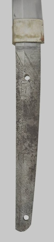

Dan, good find!  I thought it was the same blade, too, but on closer look, the star on the old thread actually overlaps the top of the first kanji, where this one doesn't touch.  Same guy, though, and it looks like it's "Masamichi".  Japaneseswordindex RJT list has a "Morita Masamichi" listed, unfortunately, no oshigata on him.

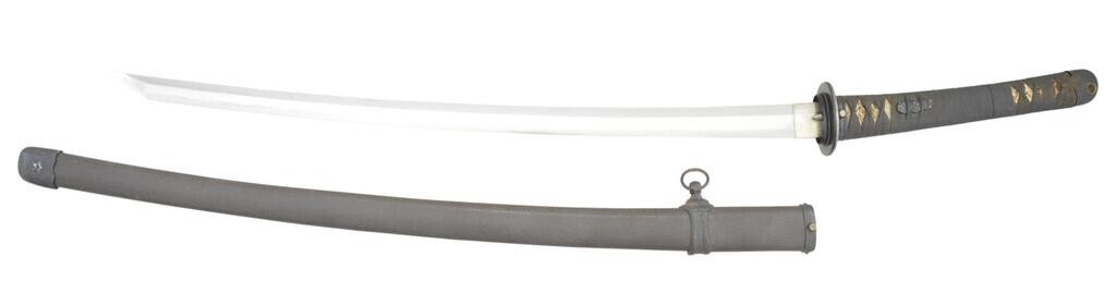

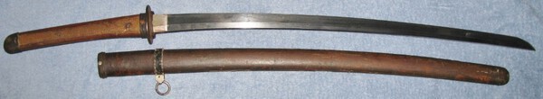

Different fittings too:
Mark's
This one from the Poulin Auction

He is Masamichi, connected to the Kato family (Masakuni's student), like said before, most likely Tanabe Tsunayoshi using a different mei for the RJT program.
