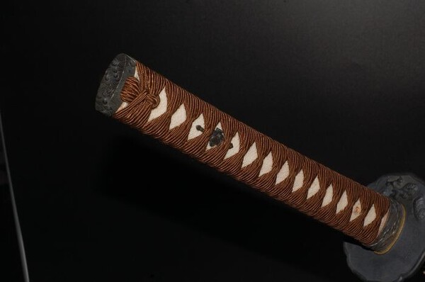

Hello Guys
New to collecting swords.
I just bought my first katana, from a big collector guy.
Do you guys know who / were / when it was made.
I would really appreciate any info.
Thank you
/Dave
Hmmm. I'm not so sure this reminds me of a shinsakuto.
Anyone else?
Could this be a Komonjo special? (a guy who lists swords on eBay that are usually not what they seem at first)

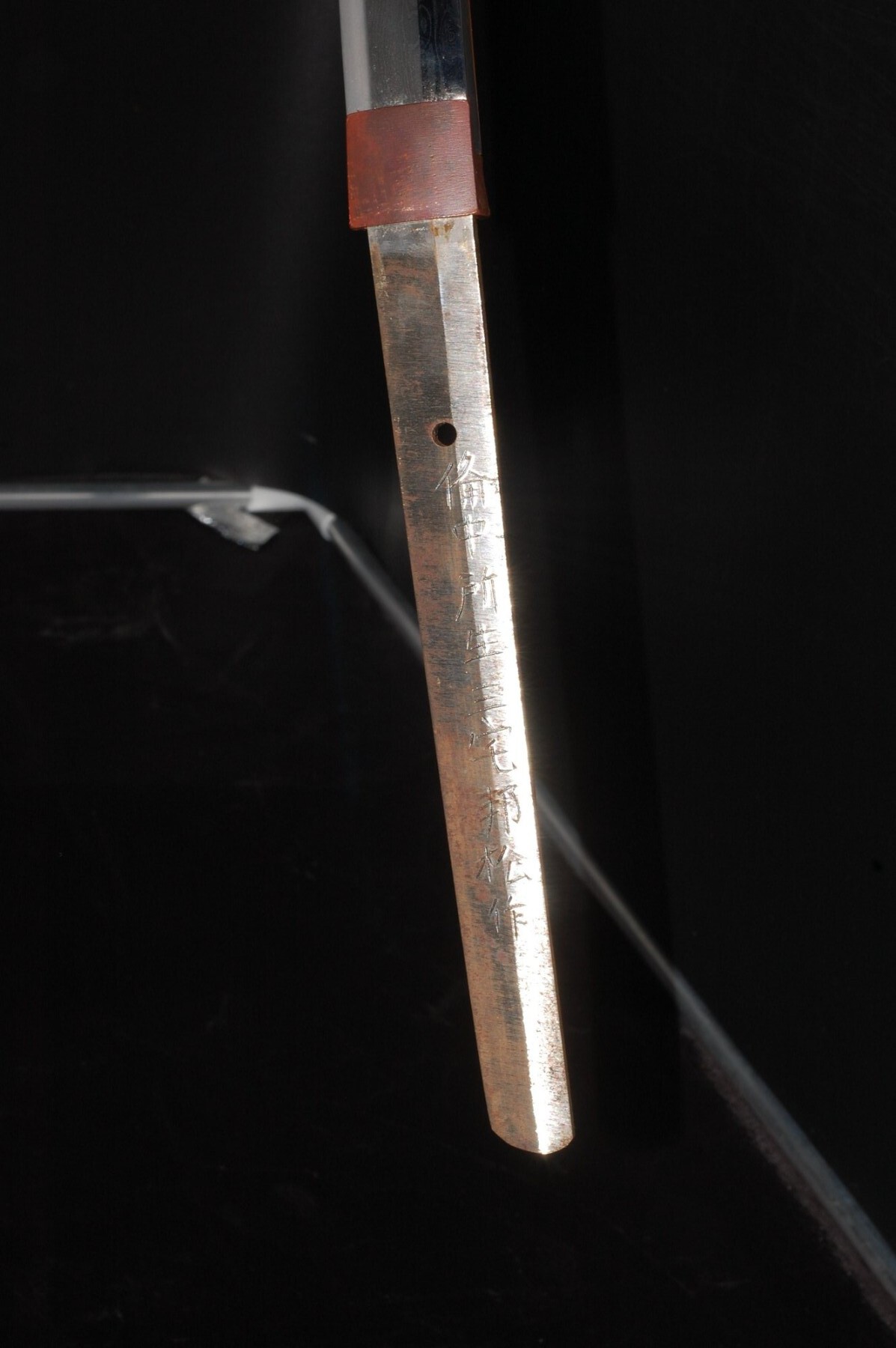

I got this from the seller.
"BICHU SHOJO MYAKI KUNITSUGU SAKU" is the signature it was given from my Japanese dealer so i cant know exactly because i dont know read kanjis, there are very dificult because they can mean different thinks.

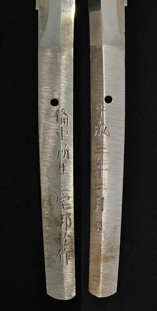

I found this picture from an auction 2 years ago.
Its a katana made by Miyake Kunimatsu.
Hmm, not same like on my sword ??
Not possible to say from the pics given. Even the nakago jiri is different. Who the Japanese seller was also plays a part.
This stuff is flooding the market from sellers like komonjo etc. I just can't say.

This is the sword made by Miyake Kunimatsu.
The seller told me he think it was made pre ww2.

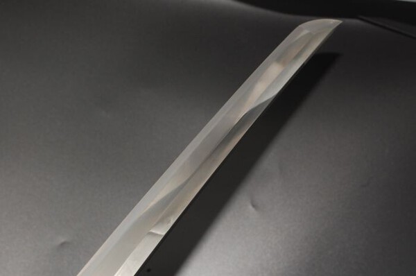

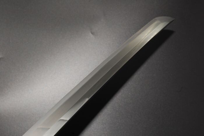

As Brian says, impossible to say anything meaningful about the blade with these images. Where you buy a sword and who you buy it from can give you reassurance or it can set off many alarms. Apparently this came from a “big collector guy” but the story he has given you contains a lot of misleading uncertainties. To my eyes based on these images the fittings and tsuka Ito etc look brand new.
According to the info on this smith that you have found he was born in 1944 and didn’t get his licence until 1989 so what the seller told you is rubbish. He could not have made it before 1940-45….and it certainly doesn’t look that old.
The story doesn’t really stack up……but that doesn’t necessarily mean it’s “bad” . It could (hopefully) be a shinsakuto (modern sword) by this smith. Has it got a date on the other side of the nakago?
Can you give this forum clear images of the detail in the kissaki, the hamon and the hada?…..then you will learn much more.

Looks like one of those komonjo blades. If I'm not mistaken it's a shinsakuto and any legit shinsakuto must be signed and dated to my understanding. The fact that it isn't dated is a red flag. The habaki and all the fittings look komonjo like.

On 11/1/2022 at 11:46 PM, SteveM said:
備中所生三宅邦松
Bitchū shosei Miyake Kunimatsu
Modern swordsmith.
I just noticed, there is one kanji missing.
The last one is missing.
