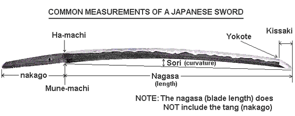

Welcome to NMB!  You have a legitimate Type 98 Japanese officer sword.  I personally believe the blade, though, is something older.  The 3-tiered machi (those notches where the nakago (tang) meets the cutting blade) shows the blade was reshaped 2 times after it was made.  The nakago is also longer than standard, so the blade shows promise as something interesting.  You might benefit from posting some full-length photos of the bare blade and some basic measurements:
