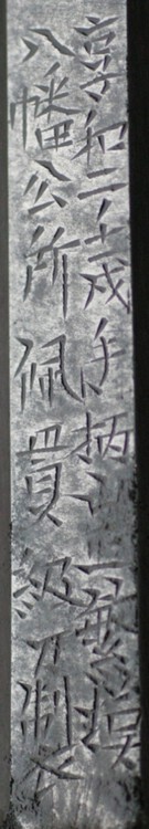

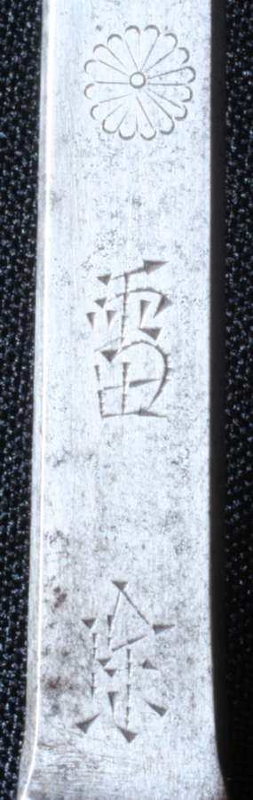

Some time ago I bought my second umabari and noticed that the inscriptions in the handle are the same as in my first one (apart from the way they are inscribed, deeper and chisel strokes visible opposed to engraved lightly). Meanwhile I saw another piece on the internet and you guessed it, the same text again! Furthermore I see that the inscriptions on the blade section are also the same over and over (a flower an two kanji), except on my first one which i was told is signed by a Tegarayama Masashige and dated 1802. I 'm going to ask a lot;
1. I hear the two kanji on the blades are "kaminari yoke", meaning "against /escape from thunder". Is that correct?
2. What does the signature of masashige read exactly, in kanji and romanji? And is it possible to validate if this is legit or gimei? there is much less space than on a fullsize nakago so i can imagine signing is difficult.
3. What does the poem/text on the handles read, again in kanji and romanji? I guess it is a famous verse if every umabari i come across has it :D

As Brian says, the mei inscription may be only a decoration. Anyway, the mei reads as follows. However, some readings for some kanji might be wrong.
享和二壬戌手柄山正繁捩 (Kyowa ni Mizunoe-Inu, Tegarayama Masashige hineri,)
八幡公所佩貫級刀製 (Hachiman-ko shohai no Kankyu-to o tsukuru)
- In Kyowa 2nd year (1802), Tegarayama Masashige worked out and made a Kankyu-to which had been borne by Hachiman-ko.
[back ground]
Hachiman-ko (八幡公) seems to refer to Minamoto no Yoshiie (源義家(1039-1106): http://en.wikipedia.org/wiki/Minamoto_no_Yoshiie ). When Daimyo Matsudaira Sadanobu (松平定信(1759-1829): http://en.wikipedia.org/wiki/Matsudaira_Sadanobu ) found that such a Kankyu-to had been used by Hachiman-ko, he had Tegarayama Masashige reproducing the Kankyu-to.
Gentlemen, thank you for your feedback and the elaborate translation :bowdown:
I agree, an attribution to such a high ranking owner can only be ..ehhmm, well,.. optimistic, decorative or as Brian put it patriottic.
To complete your view of the pieces I made some photographs of the hamons, a little bit of the hada can be seen. But I must admit this is difficult to capture on such small pieces without a proper macro lense. I made a collage of some different blade sections and angles, please don't laugh at my Photostudio 2000 skills :glee:
