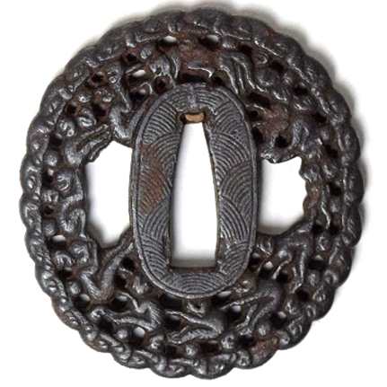

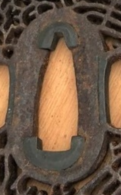

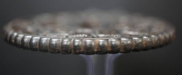

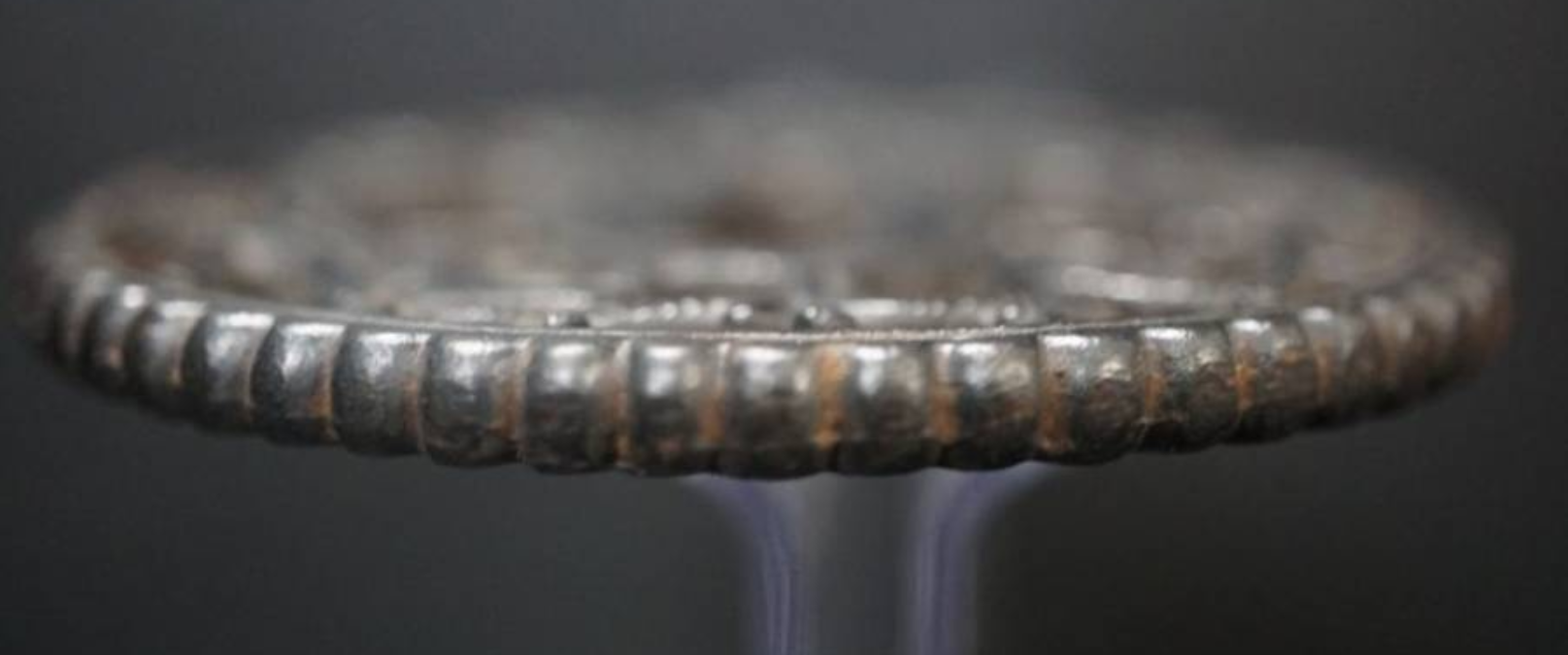

Definitely :thumbsup: you can see a clear "seem" running along the midline of the mimi.
And it certainly appears to have enough age to be from sometime in the 1800's.
Again though, Nanban-style tsuba are less reliable sources for this quest, because the country of origin can't always be certain: Japan, China, all over South-East Asia ("Monsoon-Asia"), and the Dutch East India Company was even having them produced as far West as Sri-Lanka.

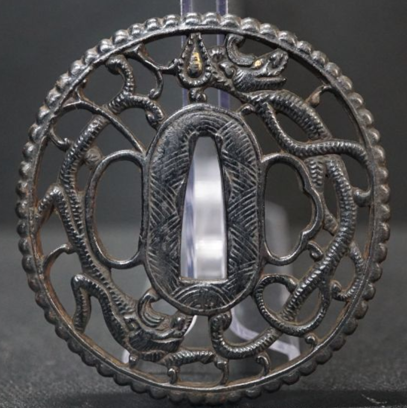

Coincidentally, here's the same one in better condition, complete with gold highlights (up for auction right now):
image.thumb.png.1dff312840ae80d449253e5c19ae1c84.pngimage.thumb.png.d1b014e042ce592e6cfa0b921f5faaec.png
Same seem along the mimi.
I also post this one because it has that "waxy-look" to the surface finish that I mentioned earlier.
There are also a bunch of Japanese-style tsuba with different motifs that have this same "look", but are not in the Nanban-style.
I suspect that they could have all been produced by the same source, or at the very least, with the same casting technique.

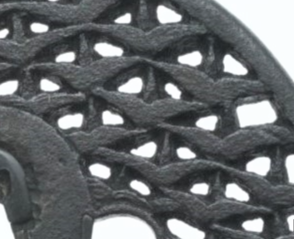

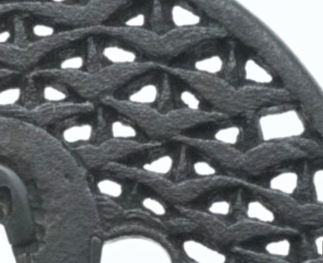

Dan, I think this one would certainly qualify as a shiiremono copy of an earlier Tadatoki piece form the Akasaka school (no idea which generation though).
Regarding this tsuba:
-It's definitely not up to the same standard as the typical papered Akasaka.
-All of the surface edges of the birds are roughly textured and don't appear to be chiseled.
-The mimi and seppa-dai all appear to have the same "porous" look to the them, pretty much everywhere.
-There's even a bunch of "voids" in the vertical walls outlining the birds (once you increase the brightness of the image)
so definitely cast-iron.

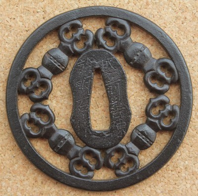

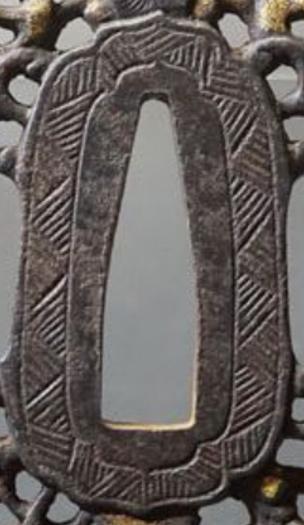

Coincidentally, I recently saw a Daigoro school "bundles of branches" tsuba that had very similar shakudo sekigane inserts at the top and bottom of the nakago-ana and sides of the seppa-dai.
Interestingly, the seller even clearly described it as "junk", yet it still sold for around 32,000 yen!!!
This Daigoro one had a lot more hand-work done to flatten out all the insides of the "sukashi".
This kind of sekigane is not common at all so it's possible that both tsuba were made by the same producer and this could be one of their identifying characteristics.
There's even some similarity in the hitsu shapes themselves.
Again, not the type of tsuba a lower level samurai or merchant could afford an original of, so it seems to be another solid candidate for a late Edo period, cast-iron, shiiremono tsuba.
And, it "fooled" today's collectors who have digital zoom capability, so back in the day, it would certainly look like an original when mounted on a sword and viewed from a distance.

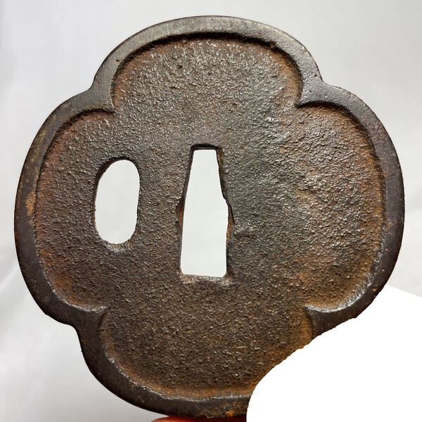

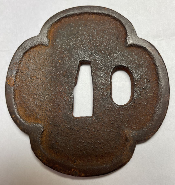

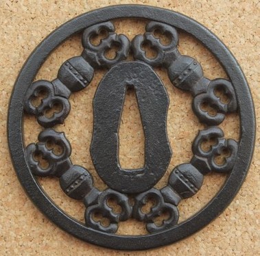

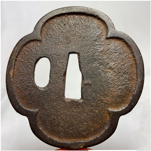

Well here's an interesting example that I haven't seen before:
It's a completely utilitarian cast-iron tsuba, and not a copy of some fancy high end tsuba.
So, one would have to assume this was not made to sell to foreigners, and was intended for domestic use.
I erased the seller's fingers from the bottom right of the image.
image.thumb.png.8aa14d0764859fa56d91dc36d0ef609a.pngcast.thumb.jpg.26880c9119e6ed2e3ca1308bad49b342.jpg

 Heianjo-style was established in Yamashiro (Kyoto Pref.). It is mainly made of iron with brass inlay. Its design was simply family crest or arabesque patterns in the beginning. However, after that, they made different shapes of Tsuba and started using gold, silver, or copper for inlaying.
 This Tsuba is recognized by The Society for Preservation of Japanese Art Swords, which is known as NBTHK.”
“Authentication PaperNBTHK Hozon Certificate”
 “NBTHK, also known as Nihon Bijutsu Touken Hozon Kyokai (the Society for the Preservation of the Japan Art Sword), is one of the oldest Japanese sword appraising organizations in modern-day Japan. They authenticated the Tsuba on Aug 27th in the first year of Reiwa (2019). They appraised it as Hozon Tousougu, the Tsuba worth preserving for Japanese society.”
With respect,
Dan
Relying on images alone, can make the identification of cast-iron very difficult. But I can see why you might single this one out.
Even though this one is "Heianjo-style", there's a whole group of Heianjo plates that have purposefully rough-textured surfaces that were worked by hand (and possibly some sort of chemical treatment as well to create all the pitting and "flaked"-look... just a hypothesis). So this one should not be counted as "cast-iron". They are recognized as being proper forged plates.
btw, the added ring on a mimi is a "fukurin" not a "hukurin"... could just be one of those pronunciation/translation issues of going from Japanese to English..

Hi!
Thanks, Glen, for your evaluation of the tsuba.  I looked at many more pictures of Heianjo-style since you let me know that “there's a whole group of Heianjo plates that have purposefully rough-textured surfaces that were worked by hand (and possibly some sort of chemical treatment as well to create all the pitting and "flaked"-look... just a hypothesis). So this one should not be counted as "cast-iron". They are recognized as being proper forged plates.”
What I saw was as you stated.  There are vary many of the Heianjo group that have a rough texture to them.  But from what I can tell (just by looking at pictures) is that although they have a rough textured plate, the kozuka hitsu ana and kogai hitsu ana are pretty much smooth, clean, and appear to have been “worked”.
On the “Heianjo style” tsuba in my previous post, the kozuka hitsu ana defiantly appears to have a “lumpy” type surface inside of it.  Also, the Nakago ana appears to have an unfinished look to it.  That is what I observed (but hey I wear glasses, so my eyesight is not that great)!  But as you stated in your post (and thanks for researching that area) we can’t rely on carbon dating to find out how old tsuba are, so I will just have to wait until someone finds a cheap way to do non-invasive testing to determine the metal used.  And since that may take several years to develop (and I may not even “be around” anymore to see that done!!) I will just move forward with checking out pictures of papered possible cast iron tsuba and seeing what turns up!
The research continues!  Onward!
With respect,
Dan
I think unlikely the occurrence of iron casted tsuba in Edo times, but their production should be as early as the early Meiji period. Here below a surely casted tsuba from the Powerhouse Museum in Sydney, collected by the Reverend Julian Tenison-Woods in 1886 (unless a faulty record from the museum).

Hi all!
So up for your viewing pleasure today we have a set of daisho tsuba.  Yes, two tsuba to view.  Too much fun!
The tsuba appear to have been hand worked to varying degrees.  But the tsuba plates (particularly the one on the left) appear as if they could have been cast.  What is interesting is the mimi of the tsuba.  The one on the left in the pictures appears to have more of a straight (casting?) line on the mimi.  And the motif appears that it could have been cast along with the plate.  I believe that it is actually the older of the two tsuba.  The tsuba displayed on the right could also be cast iron (or maybe the wavy type of line on the mimi was engraved?), but I am pretty sure the small depressions on the plate were hand crafted, and not a result of a casting process.  The motif also appears to be hand worked.
My opinions and thoughts are that the tsuba on the left has the appearance of being cast iron.  The tsuba on the right probably not cast.
I checked out information on the school, and etching was involved.  So, maybe that contributes to a “cast iron look”?
“The founder, Jakushi I (Kizayemon), of Nagasaki in Hizen, was originally a painter, chiefly of Chinese scenery in the manner of the later Ch’in Dynasty, who later translated his graphic work into metal. The miniature landscapes characteristic of his style are produced by an initial etching of the iron ground, which is then finished with chisel-work and enlivened with figures and other details in minute incrustation of the soft metals or in nunome overlay of gold graduated in thickness so as to resemble washes of the precious metal. Another favourite subject is the dragon amid clouds, boldly conceived in the Chinese manner.”
Anyway, an interesting pair!!  And another possible example of a papered cast iron tsuba.
