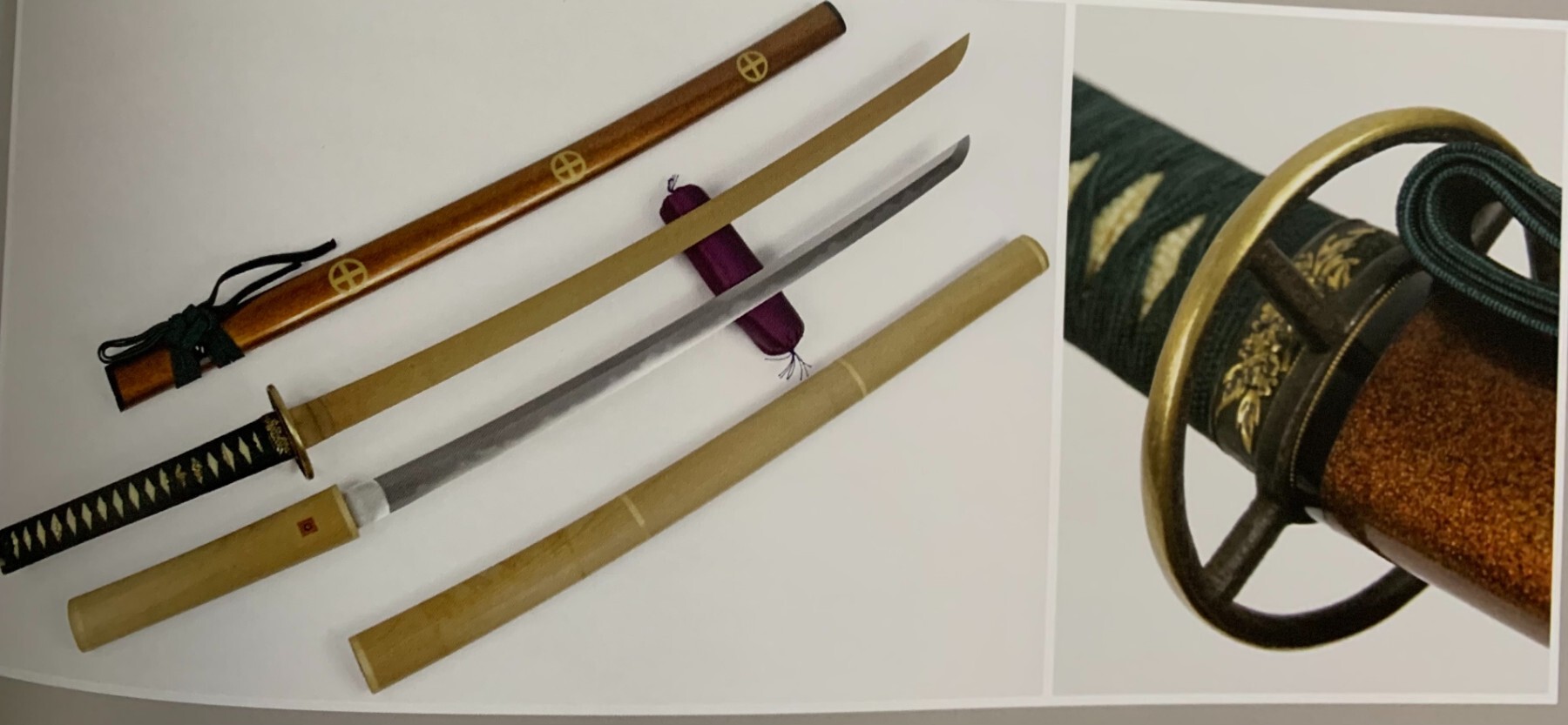

Paz Posted January 7, 2022 Report Posted January 7, 2022 Hi all. I have a question regarding mon and family emblems on swords. I recently viewed a few swords and one late muromachi period sword had the kamei family crest on the koshiare ( particularly fuchi). If a sword koshiare or saya, has a family emblem belonging to a daimyo. Can we assume that the sword was made for, owened by that particular family ? Even if the family domain was some distance away from where the sword was made. Or is it a case that a blade was put into shirasaya and then acquired at a much later date. And then given fittings with no regards to family crests (such as meiji period or end of edo period) Thank you. Quote

Paz Posted January 9, 2022 Author Report Posted January 9, 2022 I was referring this particular mon , again it might be just there as a decorative. Quote
Bugyotsuji Posted January 9, 2022 Report Posted January 9, 2022 That is a proper Mon in gold, which is also decorative in itself. Consider Meyui, yottsume, yottsume-yui. Yours has a twist, so 'Sumitate' or 'standing on one corner'. https://ja.wikipedia.org/wiki/目結紋 Quote
Paz Posted January 9, 2022 Author Report Posted January 9, 2022 5 hours ago, Bugyotsuji said: That is a proper Mon in gold, which it is also decorative in itself. Consider Meyui, yottsume, yottsume-yui. Yours has a twist, so 'Sumitate' or 'standing on one corner'. https://ja.wikipedia.org/wiki/目結紋 That's very interesting. Just read up on the the okuyama family. Am I right in saying that the fuchi emblem on this sword (meyui) was influenced. Or was the sword actually given to them ? The sword is koto , late muromachi period 1530s. Quote
Toryu2020 Posted January 10, 2022 Report Posted January 10, 2022 Paz - I think the best you can say is there may be some relation - given the quality of what we can see, it may (and its a big IF) it may have been someone who served the family that used this mon. Over two hundred and fifty years there would have been dozens of branch families and retainer families given permission to use the mon - sometimes it is on "parade" items used for sankin kotai - seriously without other corroborating information it is just a nice mon... -t 1 Quote
Paz Posted January 12, 2022 Author Report Posted January 12, 2022 On 1/10/2022 at 5:32 PM, Toryu2020 said: Paz - I think the best you can say is there may be some relation - given the quality of what we can see, it may (and its a big IF) it may have been someone who served the family that used this mon. Over two hundred and fifty years there would have been dozens of branch families and retainer families given permission to use the mon - sometimes it is on "parade" items used for sankin kotai - seriously without other corroborating information it is just a nice mon... -t Thomas, I think this will remain a mystery and anyone's guess. Even the dealer did not go into detail regarding the use of the mon and who may have used it. There is another question I do wish to pose , and rather than create a separate thread il ask here. This particular piece comes with a imperial army saya , which is early meiji late edo. (Not ww2). You can tell from the hook on saya and that it is not lacquered. We're koto or late muromachi swords later mounted in new imperial saya ? Does this mean that the sword was in shirasaya or the original saya destroyed. As this particular piece has koto blade, with koshiare which is also koto period. But an imperial army saya. Thanks Quote
