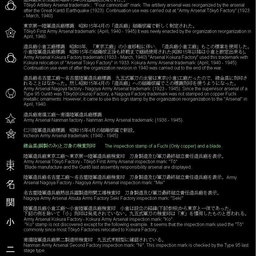

Proposal that we pin Type 95 Arsenal stamps. The other stamp thread seems aimed at Gendaito
Stole this from another site, but that was stolen from somewhere else (so, I don't know who to credit), but this is good info on type 95 markings (Please delete if inappropriate):

Corry,
That chart comes from Ohmura's site:  http://ohmura-study.net/794.html
I have it as a permanent bookmark on my browser.  Brian my have some better suggestions, but I'm not sure having it pinned here at NMB is any easier to access that a link to Ohmura's site.  I have real examples of the stamps in my Stamps of the Japanese Sword booklet.  And I've started (need to finish) uploading those examples on Brian's Gallery pages here:  https://www.militaria.co.za/nmb/gallery/category/3-arsenal-stamps/
But I agree, prowling through 26 pages of the Arsenal Stamps thread for a single stamp is not the best way to find a particular stamp you're looking for.
