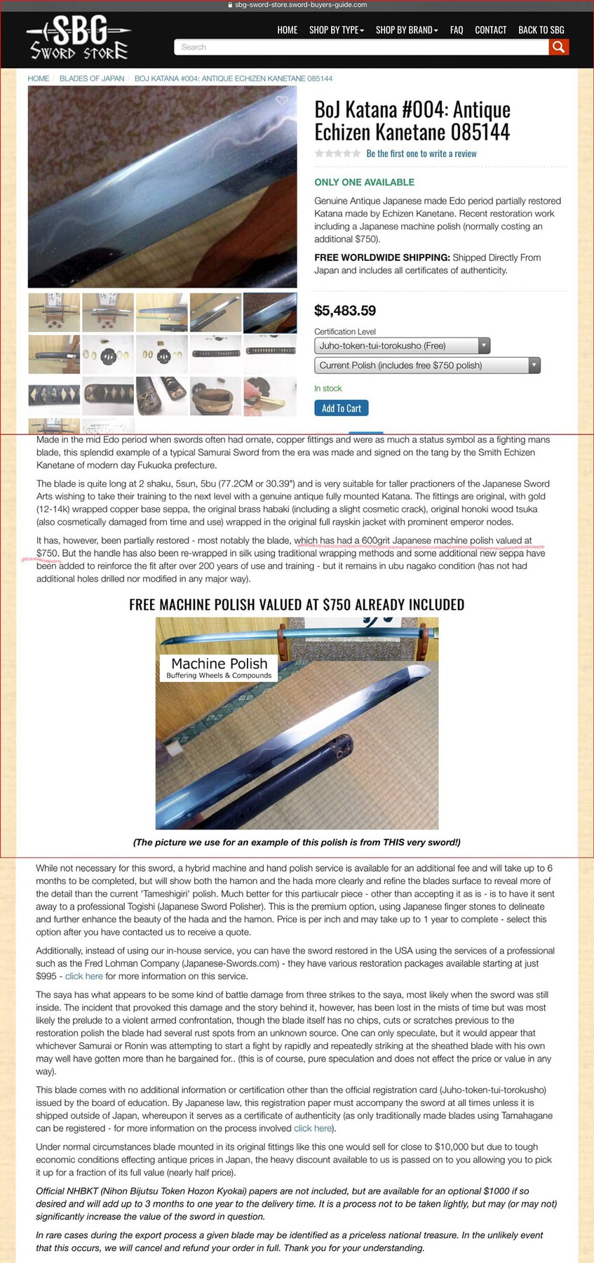

Then I found out they sandpaper polish their nihonto. Like this (formerly) nice hefty looking blade: in their own words it was in reasonable polish, had a very minor inactive surface rust problem and instead of using a less destructive way of removing, they took a 600 grit sandpaper machine and gave it a “polish” and called that a free restoration. It gets worse since all their other swords are trying to upsell the buyer into buying sandpaper machine polishes or machine-hybrid polishes (acid using I think).
They are telling people that trust them to pay them top dollar for sandpapering their antiques, that it will improve them. It just seems shady and like something that will forever put off new people from the hobby when they buy one of their blades and realize the “restoration” did irreversible damage and loss of value. Also, thanks to presenting themselves as experts many people will now think you restore antique swords with sandpaper and acid.
Here is another example of how every antique sword they are trying to sell has two levels of "restoration" they are trying to upsell people into buying: a 750$, 600 grit sandpaper buffing, and a sandpaper buffing plus acid bath for twice the price. It seems that despite being a new project, they’ve already sold at least half a dozen swords. Their archives don’t mention if they sandpapered what they sold but I would not be surprised if people, who paid them quite a premium over market, decided to do what they thought was the responsible thing by getting it a machine/hybrid polish.

I agree, it would be fair game, and completely supportable by these screenshots to note that they sell over priced, oft misattributed/described swords and cause severe damage to their wares by sandpaper polishing and urge their customers to buy their amateur polish, all while concealing the loss of value such “restorations” do to their wares. I probably will leave a review on reseller, with my SBG screenshots as evidence if it lets me, but I suppose the trusting fans will outweigh me.
