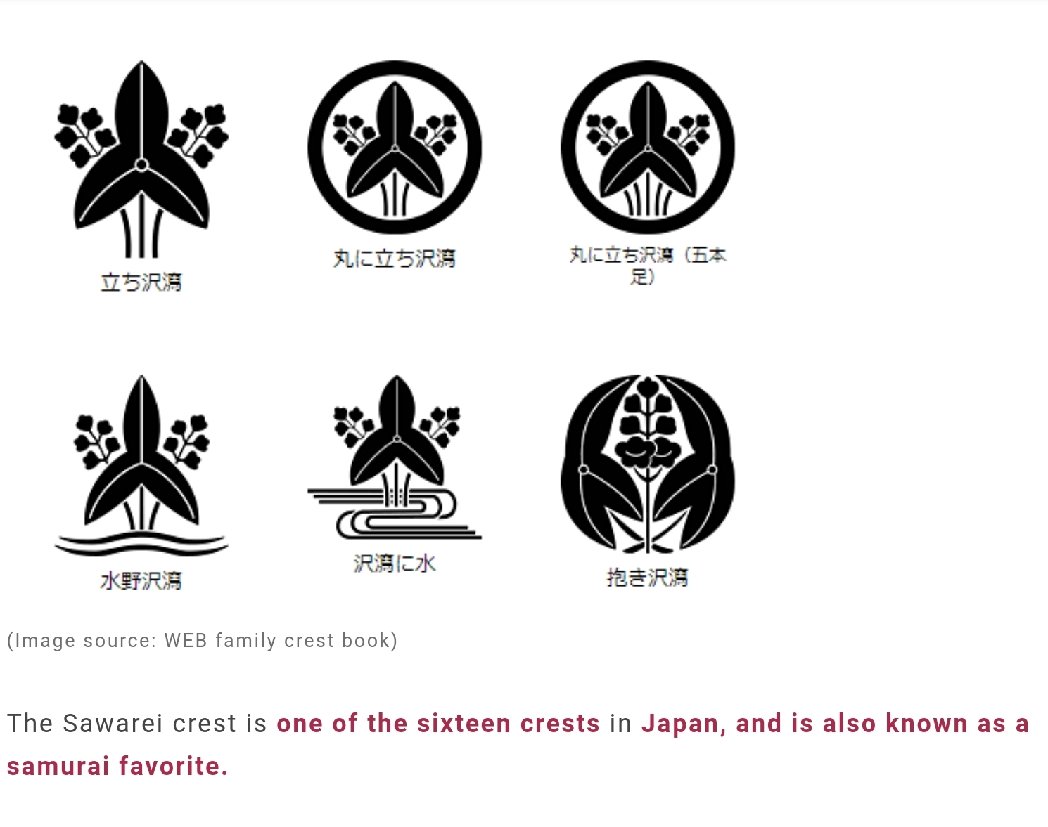

Bruce Pennington Posted July 9, 2020 Report Posted July 9, 2020 Here's your crest! Sawarei: (thanks to Piers!) 1 Quote
