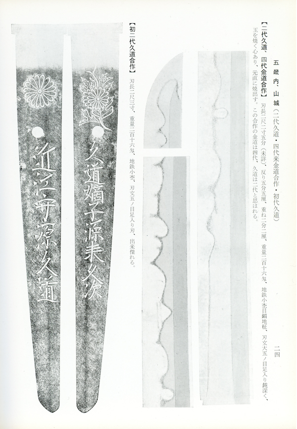

Hi,
here you go, an oshigata to compare it to. This one from the Shinto-shu by Shibata
[attachment=0]Omi no kami Hisamichi.jpg[/attachment]
obviously the one on the left is the one to look at ;)
Nice first and second generation Hisamichi jointly made work.
Yikes :? I'm confused. Are you all taking about my sword or the one in the image Ford posted? Thanks, in advance, for straightening me out!
Also, Ford you get an "A" for effort however, I'm sure WE ALL want to see a picture of you doing that headstand :D
Antelope
Anne,
In this case they are talking about the one in the control sample posted. It is a joint work, whereas yours is (hopefully) by the one in the left side of the pic (each smith signed one side of that example sword)
