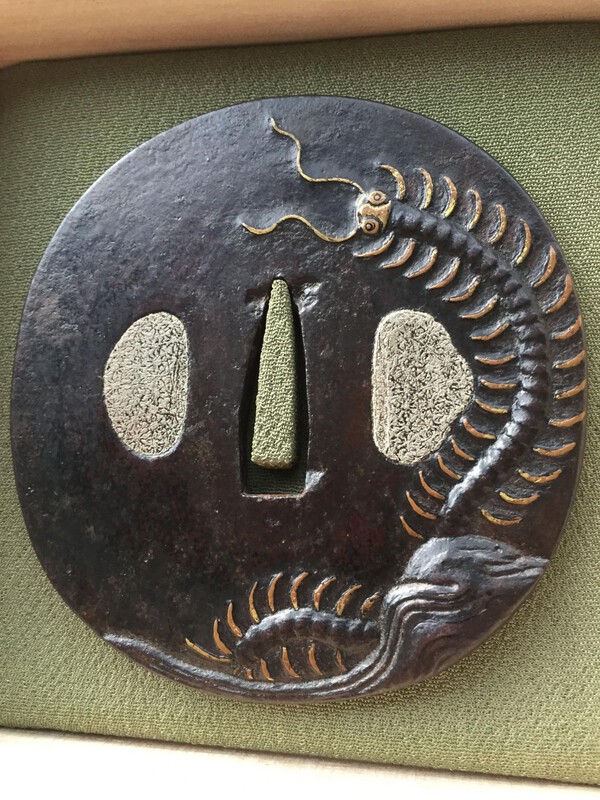

I stopped collecting  dote mimi "katchushi" guards  (which used to be common and cheap) in part because of tsuba like the one that was at the top of this thread. It is a nice looking antique, but it looks fresh and more embellished that I liked as "armorsmiths'" work. Ultimately, I began to wonder if they might not be "OLD" (i.e. pre-Edo) tsuba that had been freshened up and embellished with zogan that matched the tastes of the 19th century.

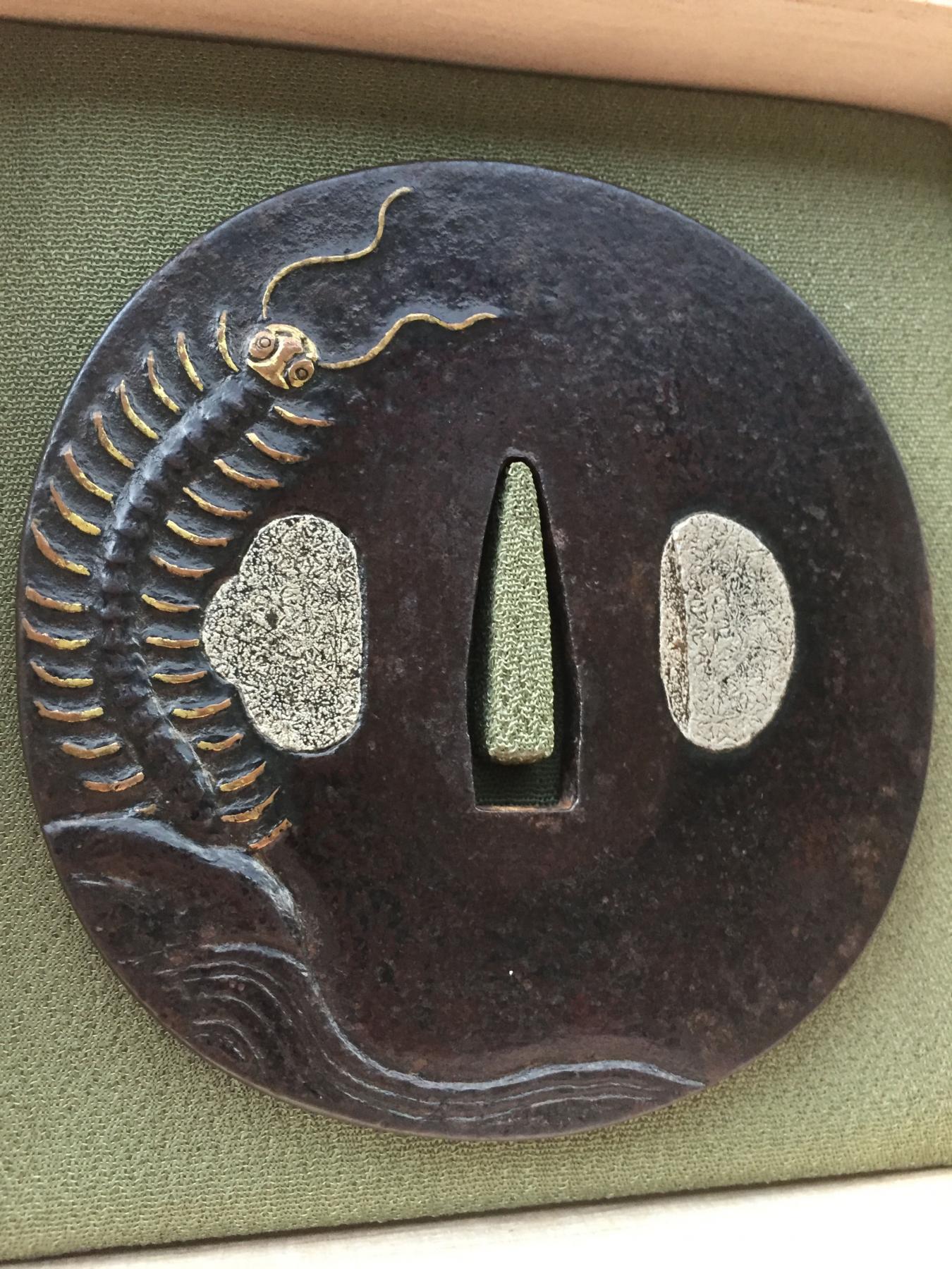

The tsuba you mention as dote mimi "katchushi" was purchased at Hartman Rare Art in New York. It has a collection accession number. I understand that both pieces of circumstantial evidence (old reputable dealer and collector's mark) may lead us into the woods, but still I would prefer to think that it is an old and nice piece. What I like the most is that one antenna of the bug is inlaid and the other is carved out, and that which is carved and which is inlaid alternates on the face and the reverse.

Sergei, Peter. The color looks so goldish "new". Is that from pictures or is it the real looking color of that tsuba.
Sergei,
Looks like missing inlay and not an intentional design element.  As for Hartman, I would edit your description to simply read....Hartman Rare Art, New York, an older dealer.

... one antenna of the bug is inlaid and the other is carved out, and that which is carved and which is inlaid alternates on the face and the reverse.
Which, for me, is an idication that this was done intentionally. What are the odds of the entire inlay coming off on reversed elements on both sides of the tsuba? The lighting is probably off, but to me it looks like the real deal.
Btw, I would describe the rim as uchikaeshi-mimi, not dote-mimi - and both are seen on many types of tsuba, not only katchū-shi.

Considering the number and nature of the inlaid elements....comfortably within the realm of possibility.
Cheers,
p.s.- If it is an intentional design choice, which is not impossible, it is IMO an ineffectual one.
Just to clarify, dote-mimi and uchikaeshi-mimi can both apply, since the first term simply describes the rising of the border, the second term refers to the way the border was obtained (but in this tsuba the rised border could have been obtained by a tomogane-fukurin - 共金覆輪, i.e. a fukurin made of the same iron).

Sergei,
I think Chris had already answered your inquiry correctly.  Unfortunately,  it appears to be a fake produced by an amateur hand using modern commercial plate. Sorry.
