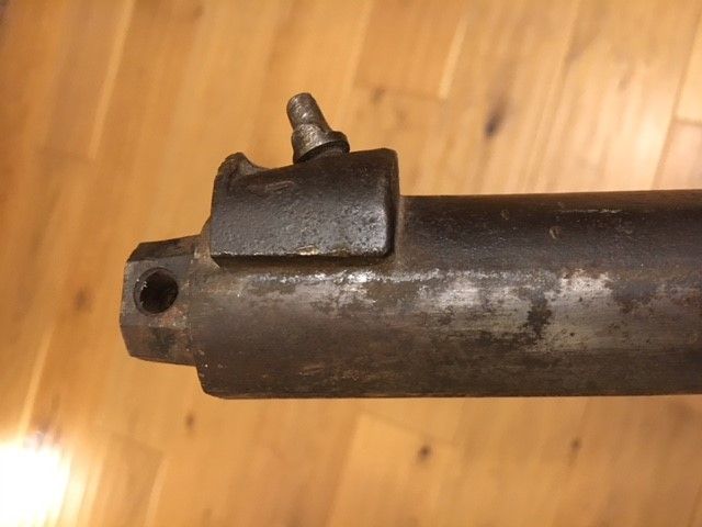

Looks like you did well.  At first sight I thought this was a conversion from matchlock to percussion but I would have expected to see a cut out in the woodwork at the lock side where the original pan and cover would have been.  The barrel and stock certainly look Japanese and I'm sure someone will chime in with a translation of the kanji and disassembly instructions for you.
Is the percussion nipple right in the centre of the breech plug?

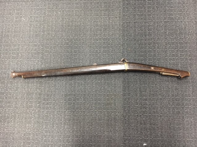

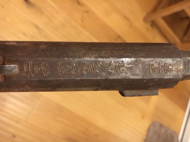

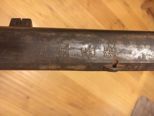

I have carefully removed the barrel and below are the resulting photos...
Many thanks ! Jon

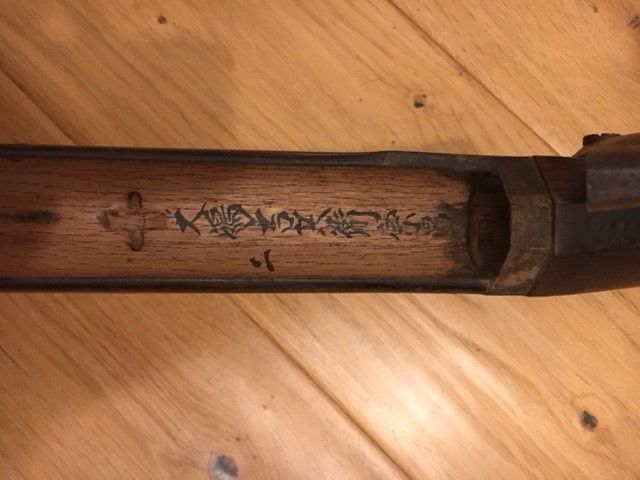

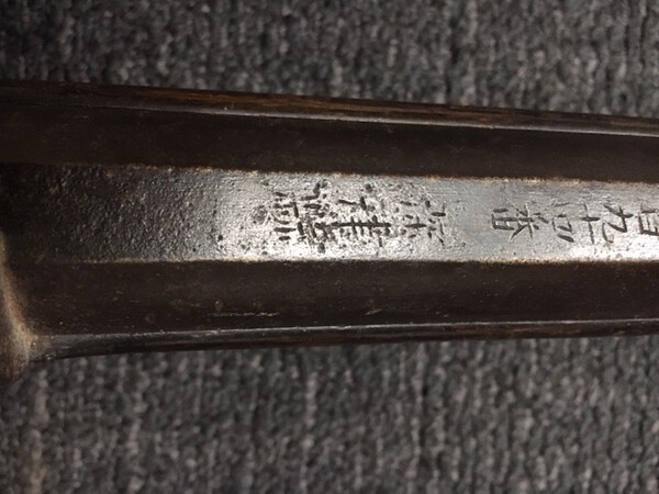

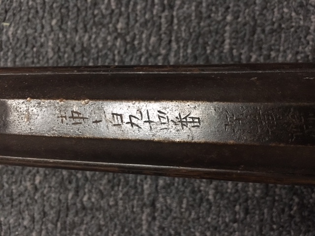

The Ink brushwriting with the name of the stockmaker is nicely written, clear and easy to read, as is the name of the Kunitomo barrel maker and the type of barrel construction. Let us know if you want to have a go at decoding it, or if you would prefer one of us to help out.

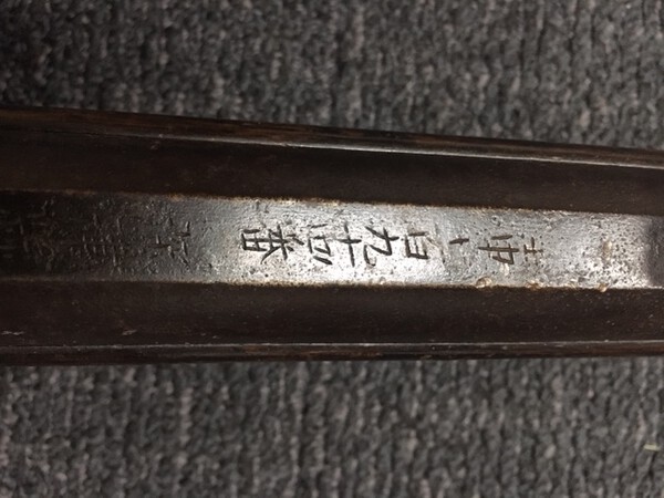

Oh, and the Jinshin Bango along the top of the barrel!
Great deal by the way, a steal indeed.

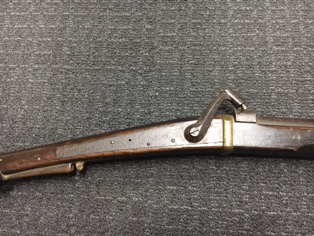

Piers, I suspected it is a conversion from matchlock to percussion. But there is also evidence to the contrary. Can't make up my mind. What are your thoughts?
As Geraint points out above, there is no cut-out for any original matchlock pan.
I suppose the gun could have had a complete new stock made with the new powerful percussion lock, and the barrel alone could be original...?

Well,there is so much to say that by the time I have typed it all someone else may have done the work! :laughing:
Keeping it short, the gunsmith is Kunitomo Hikohachiro Juto, and Kunitomo was perhaps the most famous gunsmithing area in Japan. The long elephant trunk shape of the butt tells us that it is in the Ogino-Ryu style of gunnery, and we know that there was a relationship between Kunitomo and this school.
Although the gun looks 'new', this gunsmith was working way back in Keicho. The western percussion system was not introduced to Japan till the late 1820s or 1830s at the earliest, but my feeling is the work on this native gun and the blend and balance with traditional gun styles is so good that it must be later, perhaps the 1850s or 1860s.
二重巻張 these four characters ni-ju makibari tell you the barrel was strengthened with a double helix twist of steel bands. To be boasting of double seems a bit early to me when most were later being forged with a three-twist finish. (?)
So, was this an old but good condition barrel that was put to new use?
The stockmaker is Oshima Kichibei Munemasa who worked in the late Edo Period.
The gun was finally registered in 'Fukatsu Ken', (later Oda Ken, now part of Bitchu, Okayama Ken, originally incorporated 1869) in the Jinshin roundup of 1872.

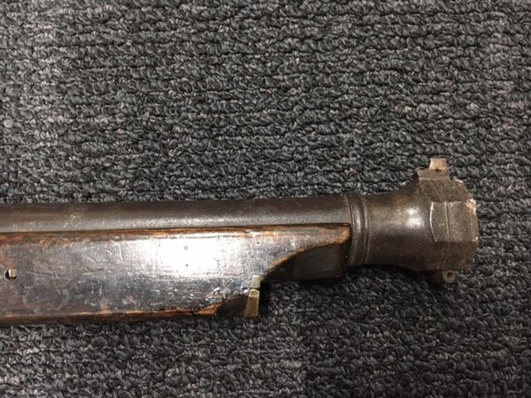

PS The ring under the muzzle suggests it must have had an attached swivel metal ramrod, for quick loading, a later feature.
Note that it does not have a thumb flange on the hammer for easy pull-back, which could mean some kind of intermediate between serpentine and western hammer, taking the gun a little backwards towards the 1840s...?

Jon,  Piers,  This example, using copper percussion caps, almost certainly post dates those guns that were devised by Katai Kyosuke to use detonating pellets. That type is fully described by Ron Watson on this Board http://www.militaria.co.za/nmb/page/articles.html/_/articles/a-very-rare-teppo-pill-lock-r11. An absolutely similar gun is illustrated in Tairas Sawata's book and I bought yet another for the Royal Armouries Museum's collection. These sophisticated guns had a swivel ramrod, of the type Jon's had, a magazine that dispensed the detonating pellets as well as a lever on the outside of the lockplate that allowed the hammer to be cocked with the right thumb whilst still holding the stock.
Since Perry didn't open Japan until 1853, I would suggest Jon's gun, in its present form, dates towards the end of that decade when percussion caps became available in Japan.

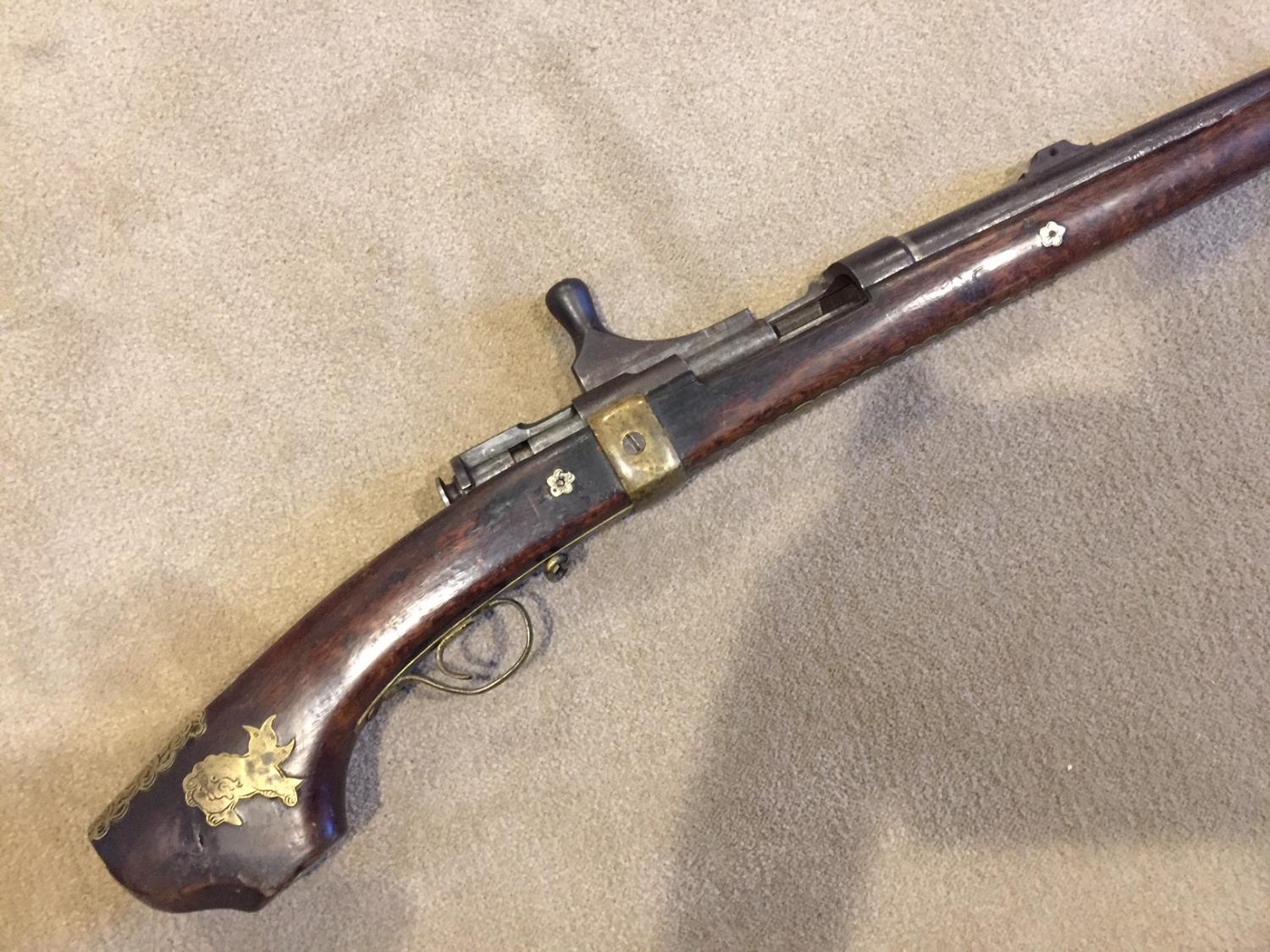

A Sakai conversion, an interesting object in its own right, missing some of the inlay, but largely in good condition. Notice how the top of the butt has been shaved off so the action can slide backwards.
DR. Galeno, late of San Rafael Ca. used to have a gun with a form of snider breech. His was not a conversion but had been made with that system. As I remember the stock furniture was nickel plated - but that may have been done later.
