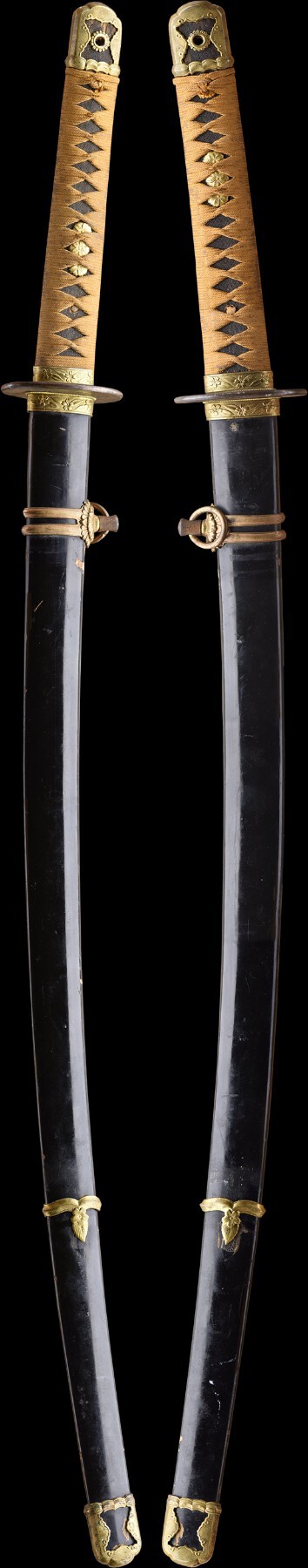

@Conway S I'm hoping for a shot or 2 of the full package.  I like to keep am overall shot along with the nakago and blade.  Sometimes the rig is fully standard, but sometimes there are variations, like having more navy fittings than standard.
Question for  @Conway S does the nakago measure 8 7/8 inches ? The reason for asking is to establish a common characteristic .these type of swords with the flat cut tang appear to have longer originally and then cut to RJT spec length leaving 8mm+- for finishing
 A common trait for end war/postwar U.S. PX bought souvenir swords.imo

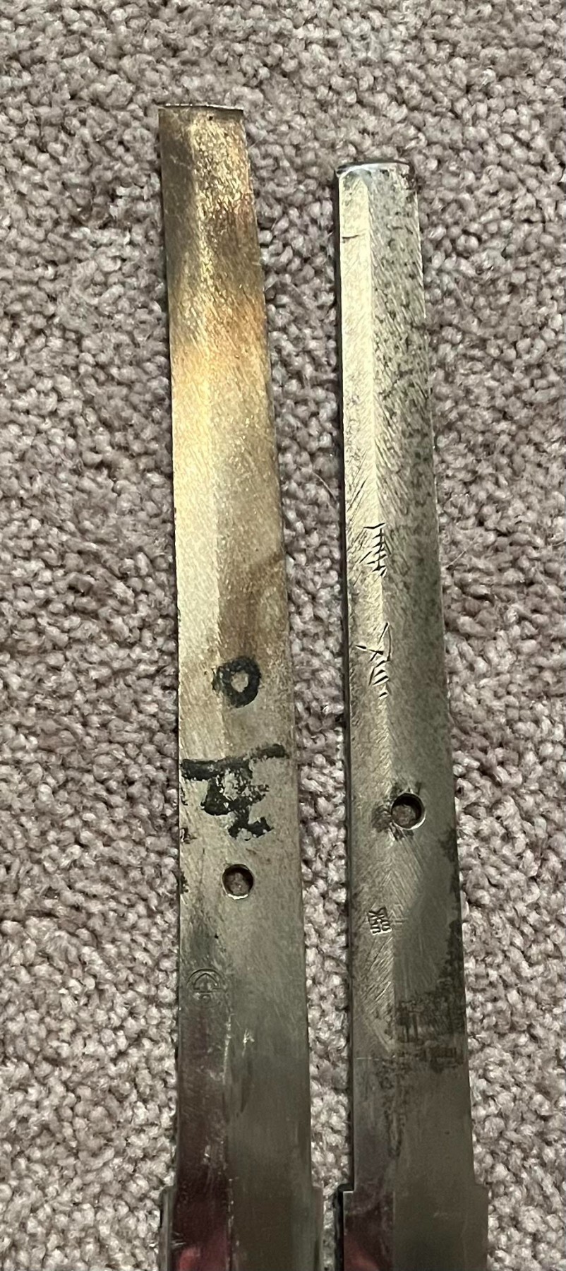

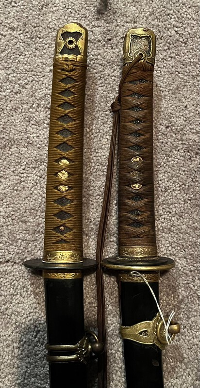

I compared my souvenir with my 1943 Yoshishige kaigunto.  The souvenir nakago was longer than the kaigunto but narrower.
Souvenir: L - 57.15cm  W - 6.55cm
Kaigunto: L - 56com    W - 7.70cm

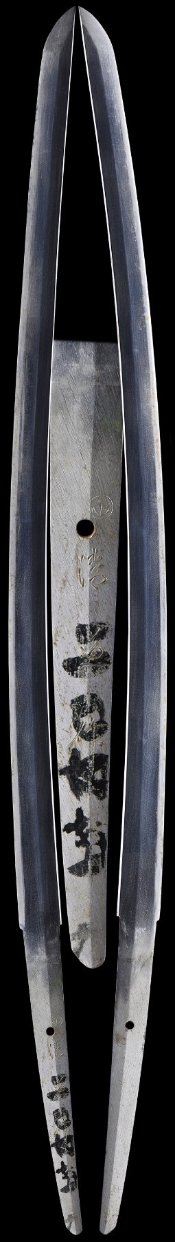

Found two interesting swords that sold a very long time ago on Live Auctioneers. Unfortunately there is only one photo available for the first. If it's hard to read, the tag looks like it says 高山清平.
Conway
Here is the second. To my eye it is the long Takayama-to mei including the polisher. Starting with third character down looks like 高山刀。The pictures are very small on Live Auctioneers so I cannot get a larger picture that is more clear.
Conway
Hey, Bruce can you tell me the nakago length of your souvenir sword with kiri flatcut please. ?and also the takayama to in order to establish a chart for comparisons
These are the nakago measurements
Souvenir: L - 224mm  W - 6.55cm
Kaigunto: L - 213mm    W - 7.70cm
Man, I’m really bad at metrics! I had that messed up, but after talking to John, I got the link right. Still not sure if I have The width right.
