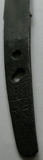

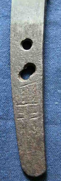

Dear All,
Some time ago I have acquired an interesting tanto, presumably a koto piece. It is signed Kuniyuki, most likely gimei. Still, I have been told that it exhibits the characteristics of a Rai school work.
Here are some pics, sorry for the quality:
http://gallery.me.com/mariuszk/100365
I would ask you for your opinion - is it koto? Is it Rai? What is it?
I like it, but I am not an expert. Your opinions will highly apreciated.
Best regards
I am doing this from memory so might be wrong but impressions from your pictures are as follows:
1. It is a very good looking Tanto. However the exagerated curve in the Nakago tends to be associated with slightly later Rai Smiths such as Kunitoshi and Ryokai rather than Kuniyuki who was very early Rai (I think the founder).
2.One indicator of Rai work is Rai-hada which are patches of dark grainless steel in the the jigane. I cant see any indication of this in your blade.
3. Typical hada is tight ko-itame with some masame running through it. I'm not sure but I think your blade shows this.
4. A strong indicator of Rai work is Nie in both hamon and particularly in the hada where it can form nie-utsuri. This can be hard to see and very hard to photograph but once you get the light right it hits you in the eye. The habuchi should also be bright.
As said above this is a good looking blade and I think you did well at the price. It has strong Yamashiro characteristics in terms of shape hamon and hada.
It appears to be of the period (mid Kamakura-ish) and overall an attractive work.
hope this helps, when I get back to some books I will look through to confirm the points about the shape and if different will come back to you.
regards
Paul B

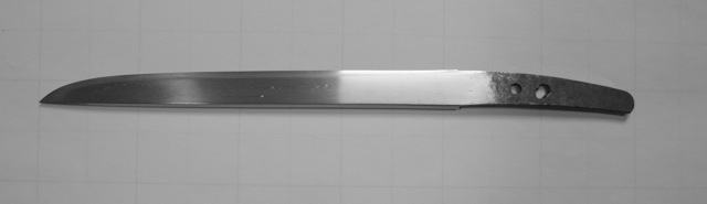

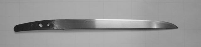

For those of you, who don't like to open endless webpages here are some pics of the tanto. Sorry, I should have done it in ther first place...
sorry something I missed. The boshi appears to be O-maru which is rare in rai work (more typically ko-maru) The enju school in Higo developed out of the Rai school and their work is very similar, one of the main distinguishing features that differentiates their work from Rai is that they produced O-maru boshi.
It might be worth looking at Enju work to see if there are any other indicators.
In Rai and Ryokai, one would look for tighter more qualitative jigane and hada with not so much running masame. One would also see mitsumune more commonly and this one looks like Iori from the images.
However it does show Yamashiro influence so that, along with shape and the with the other characteristics would lead possibly to very late Ryokai work after the school moved to Bungo province becoming "Chikushi" (or also Tsukushi) Ryokai.
Thanks, Ted :-)
It is mitsu mune. It is indeed itame hada with masame running through it. To my untrained eyes the hada does look tight, but I may be mistaken. I shall have to produce some high resolution pictures. I can see no utsuri (not that I would recognise it if I saw it).
I see also two/three spots of darker, grainless steel (not shingane, though ;-) They are small. One is on the omote, two on the ura side.
BTW, the boshi is hakikake and the hamon is very thin and very bright indeed. It consists of ko-nie. there is no ara-nie, whatsoever.
Now, that is a puzzle (at least for me ;-)
Best regards
I don't think there are any signed Kuniyuki tanto just off the top of my head. Stuff from that period is rare to non-existent. You see them popping up in the beginning of the late Kamakura, after this smith's period.
How long is the blade?
It's hard to get a good handle on the sugata because you're shooting down with the tanto pointed away from you. Stand with the blade going across your body and it won't distort because the average difference in distance of each part to the camera is smaller.
Machi was moved up 3/4 of an inch I guess, the bottom holes are probably original.
I think the yasurime should be kiri, can't make them out.
Rai hada is just core steel showing through because the blades tend to be thin skinned. I have owned three swords by Rai Kunitoshi and Niji Kunitoshi. None showed any Rai hada.
Hada of a Rai piece is generally fine and beautiful, top quality. Lots of ware showing through on your piece. The hamon on a well made suguba Rai piece should be very even and expect a turnback that may be medium to fairly long.
See:
http://www.sho-shin.com/sanji2.jpg
In particular your hamon flares through the boshi, and is different on both sides. Looks like lots of hakikake in there.
Consider the overall shape of masame turning up through the kissaki, this is the source of the underlying structure of the hakikake.
The hamon is pretty deep, moreso than a Rai blade would be I think.
All told what I am looking at makes me think of a Yamato blade rather than a Yamashiro blade. If the style were closer to Rai the faker would likely have put a Rai Kunitoshi mei on it. I think when going to an older smith in this line before the school evened out its form they are going for the fudge factor of having no examples to compare to, and that the older style of Rai shows features in the hada and hamon more similar to this. Just guessing.
As Ted points out could be one of the descending schools from Rai that loses some of the standard form and some of the skill, and some of these pick up some Yamato I think. Would have to look at the books.
I think it is a legit old tanto that is worth having the mei removed and sent for papers. Furisode nakago is supposed to nail it fairly close to or in the Kamakura period.

The two most famous Kuniyuki (Kyo Rai and Yamato Taema) can be excluded by the signature as well as Echizen Rai Kuniyuki and Mino Senjuin Kuniyuki. There have been some more smiths working under this name during Koto-period, but they are of no particular interest. Since the nakago is shaped in a form typical for Rai Kunitoshi and tries to appear like a Rai tanto, the mei is most probably gimei.
reinhard
