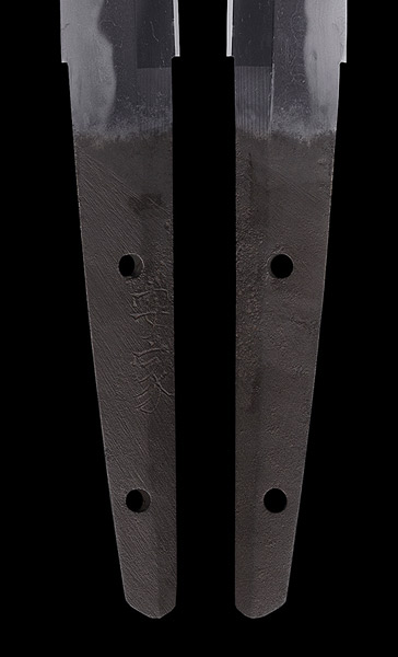

Martin Posted September 6, 2007 Report Posted September 6, 2007 In order not to hijack another thread I decided to open a new one :D ... this would lead me to believe it was originally a Gendaito mounted in the 1944 pattern mounts? Brian Hi, I also have a sword that has a second Mekugi-Ana. It´s a Kambun-Shinto piece and I wondered why a Wakizashi (Nagasa: 54,2 cm) should have a second Mekugi-Ana... Is this an indication that it was mounted as a Gunto during the war times? Thanks for any enlightening answers cheers, Quote

Brian Posted September 6, 2007 Report Posted September 6, 2007 Martin, Looks like it is in a nice polish. To be honest, I have no idea why the second mekugo ana. It looks to me to be ubu nakago, and I doubt it was mounted in the 1944 pattern Gunto mounts. One of those exceptions that proves there is no absolute rule? Brian Quote
takakage Posted September 6, 2007 Report Posted September 6, 2007 2 mekugi ana, i don't know for this blade, due to the yasuri mei, is it yasuiye of yasusada shinto school ? Quote
Martin Posted September 6, 2007 Author Report Posted September 6, 2007 2 mekugi ana, i don't know for this blade, due to the yasuri mei, is it yasuiye of yasusada shinto school ? Exactly Patrick, that is what the NBTHK stated in the Origami (Yasuiye from Bushu) ;o) Do you know more about this smith as he does not appear in any of my books except Hawleys... I thought a second Mekugi-Ana was only made for long and heavy blades... best, Quote
takakage Posted September 6, 2007 Report Posted September 6, 2007 sorry Martin, i haven't got any oshigata of this smith........... regards Quote

Stephen V Posted September 6, 2007 Report Posted September 6, 2007 Hello Martin Well my Eikyo-Bizen wakizashi has three mekugi-ana for some reason. This is a light blade and has a Nagasa of only just under 50cm so weight would not have been an issue here. I've had some feedback from a restoration agent that this feature (along with a slightly shaved tang) might prevent it from achieving a Tokubetsu Hozon origami once it is ready for submission. Probably just clouding the issue here. :? Did a crop and rotate SC Quote
Jacques Posted September 16, 2007 Report Posted September 16, 2007 Hi, one oshigata of Bushû no ju Yasuie it seems to be light difference on the second kanji (ie 家) . There is also a difference on the mune, Yasusada school mune is a high iori mune your's seems low, and the start of the hamon is not clear (like a suriage blade). Another ubu nakago with 3 mekugi-ana: Naminohira Yasutsune - Meiwa sichi (1770) I also don't know why. Quote
