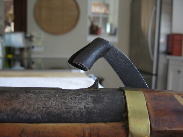

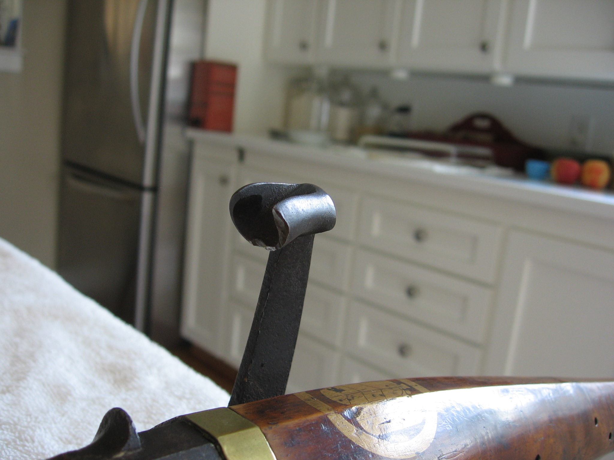

Here are better pictures of the hammer/serpentine. I agree that the the double conversion theory is very attractive. Does Occam's razor come into play here?

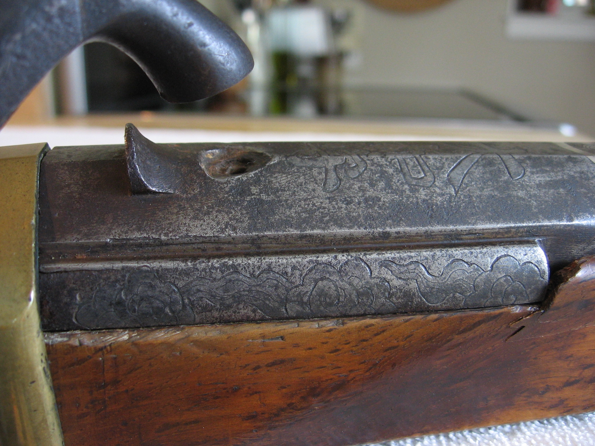

A couple of other observations: The side plate that could possibly be covering up the previous pan/side touch-hole, has the same decoration as the lock plate, hammer, and rest of the gun. The tapered slot in the end of the hammer appears to be very professionally accomplished.
I regularly shoot a flintlock longrifle that has silver inlays. There is a silver oval "thumb piece" inlay on the top of the wrist of my rifle, and it doesn't have the same appearance or color as the three feather inlay on the top of the barrel of this gun. I can't help but think the kamon is something other than sterling silver.
Again, many thanks for the fabulous insight and information.
George
Dear George,

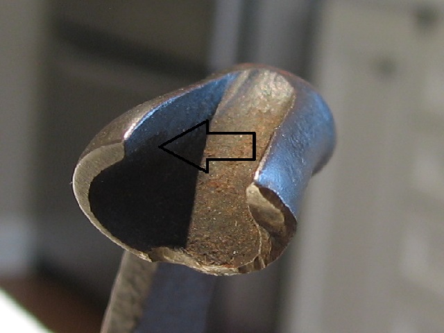

Back on Nov. 8, 2014 ... I posted : " Given the probable rarity of PERCUSSION CAPS in late Edo Japan, ... perhaps the gunsmith wisely allowed for the gun to be easily converted back to MATCHLOCK by making a hammer that would in an emergency allow for the insertion of a match by removal of the hammer insert and removal of the percussion nipple. Time and black powder erosion ( the opening is obviously eroded ) would have removed evidence of threading. Whether or not the nipple has broken off ( my opinion ) or has been purposely been removed and the gun operated post percussion as once again a matchlock we shall never know and it matters little. "
I feel somewhat vindicated ;) , as your last photograph is definitive proof that the gunsmith originally made the hammer ( serpentine ) exactly as I described above. Note in the photograph attached below ... the arrow pointing to the slot in the head of the hammer that allowed for the percussion INSERT to be placed and/or removed to allow for the gun to be operated as a percussion cap or as a matchlock at the TIME OF MANUFACTURE.
This George was a very accomplished gunsmith and you created with your original post a most interesting discussion. I am not sure that the principal of Occam's Razor would apply here as I'm not sure who came up with the fewest assumptions ?? Never the less, ... I think you were well served by all of us trying and eventually solving the riddle.
... Ron Watson
