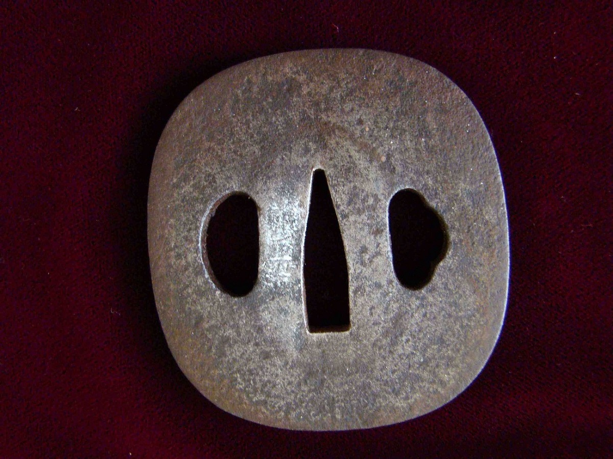

Took off the tsuka, & found mei on both sides (need help & am going to post on the approp. forum), a hard to read mei on the steel tsuba, copper seppa's a plain copper habaki, & nice looking (to me) fuchi/kashira. The saya was covered with a totally had it leather wrap, under which was a layer of what looks like white silk which was lacquered gloss black. I was able to slide out the wooden saya & it came apart revealing ....... grease.

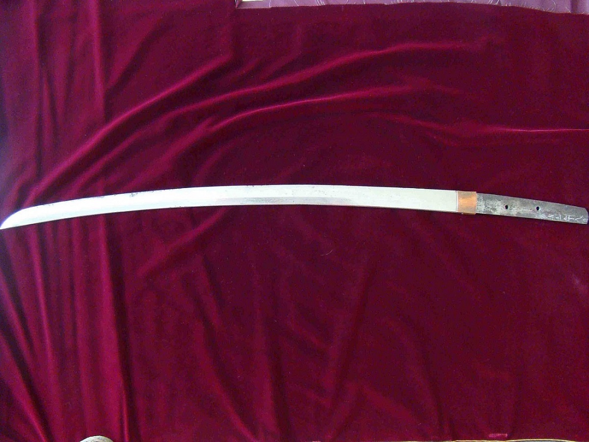

Hi Ken.

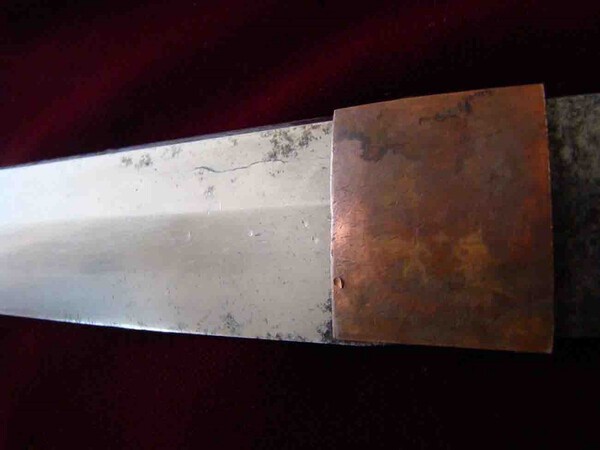

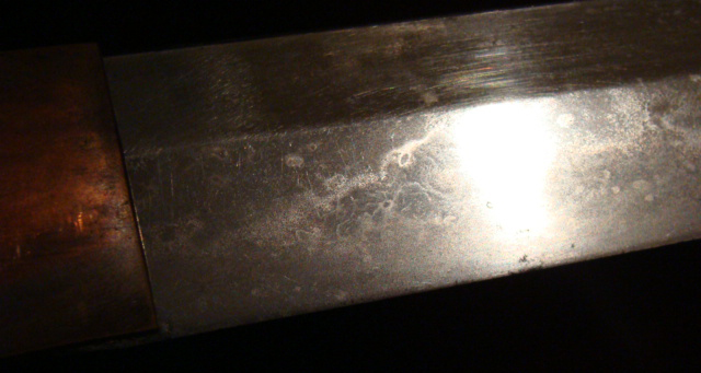

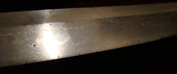

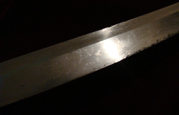

Welcome to NMB. Not all flaws are fatal, I can see at least some grain openings so far but not much else. The ones to beware of are hagiri which ususally are hard to spot but are cracks, often very thin, extending from the edge into the blade. I can't see any but then the photos are not going to show them. Can I suggest at least a shot of the full nakago, both sides, with the habaki removed?

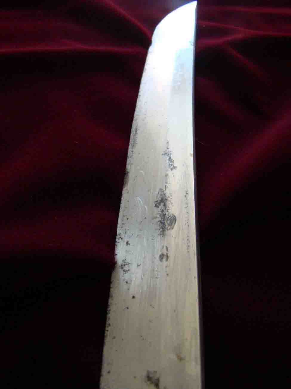

In hand can you see the hamon all the way around the boshi? It looks as though it might be quite wide and there is a possibility that the blade is not past hope. How about some images of the mounts in the tosogu section?

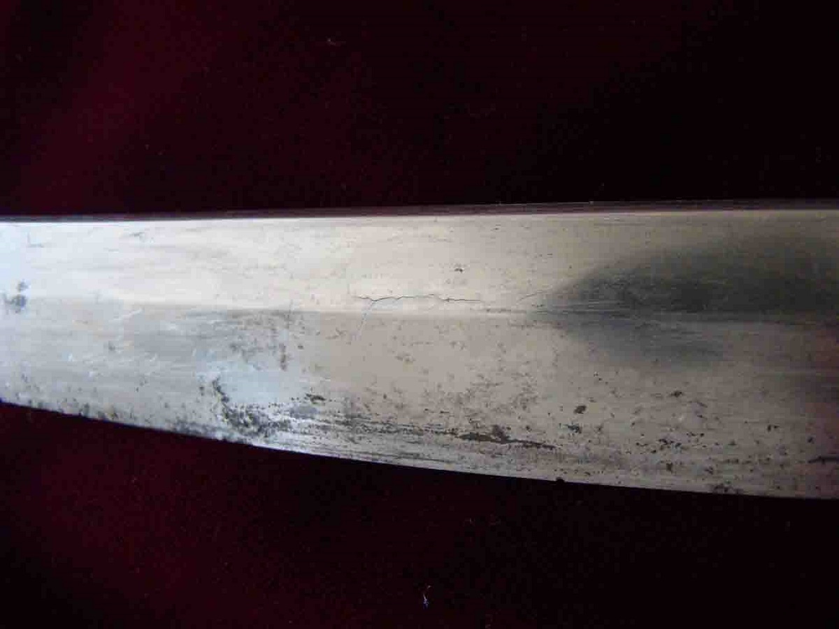

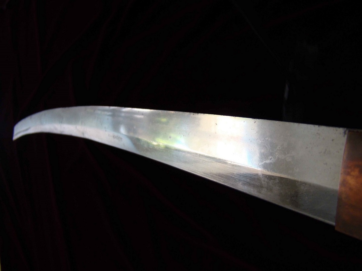

Still working on the Mei. As the nakago has two holes, does it look like the mei runs off the end (Suriage)?

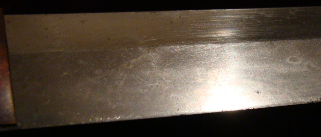

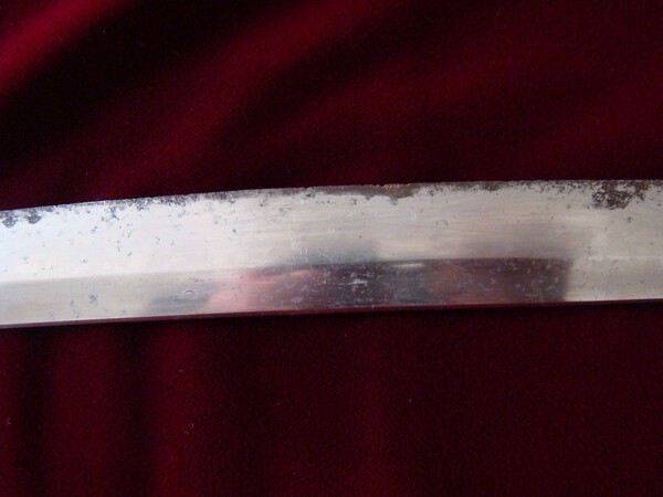

Also I thought the hamon was a bit odd. In places it seems to go above the shinogi, is this a swordsmith error, or could
it be deliberate. I've tried to post some pics, but the blade surface is pretty scratched.

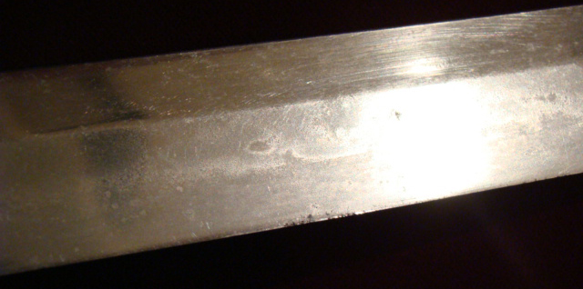

I don't think its tired.
Without seeing the mei or even nakago color, it looks like its later than koto, say shinshinto or something...
For such age, such horrendous ware are probably bad enough to prevent further investing in the sword. Some are quite close to hamon...

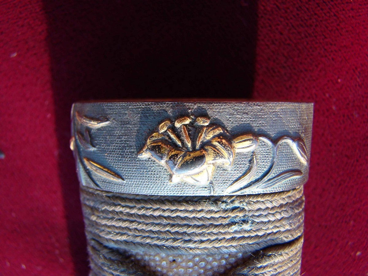

What the heck? I'll take a shot. I like the koshira but it looks like it was cobbled together. I could be, and often am, wrong but doesn't look like a set. Other than it looks well cut I can't really say anything about the mei. It does look suriage so it's possible it was cut down for WWII. Now to the blade... man! It has suffered that's for sure. Looks like it was used to hack down a shed or something. I doubt if it's worth anything in this condition and polishing would be a huge, expensive risk. Unless the mei is real and from a really good smith the odds of a collector wanting it is small. If you only paid a couple hundred for it *shrug* not really much downside. I look forward to seeing what the mei says. And reserve the right to change my opinion at any time. :D

Lots of what appear to be kitae-ware in this blade which are more consistent with kazu-uchi-mono Sukesada of late Koto than Shinto Sukesada...

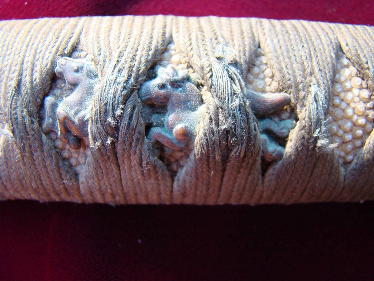

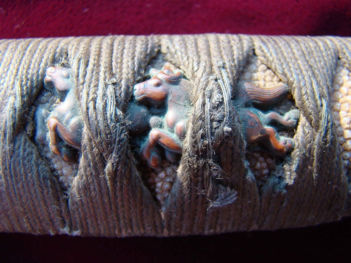

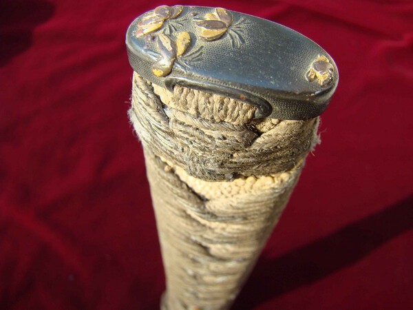

I have just noticed, & am surprised no-one else has pointed out the tsuka with menuki are in tachi style, ha facing down.
Why would this sword maybe???? 1658'ish have what appears very old tsuka in that style?
Ken,
It does not show clearly on the pictures :) fittings are Katana style.
Is it pictures or no but the nakago edge strongly curved inside as if to form a new hamachi.
seems somebody did some adding bits and odds on this tsuka, but needs to have a picture of the saya. Is it a tachi one? In this case the tsuka was rewrapped tachi style or the guy made a mistake in mounting the menuki. Difficult to have an idea as long as we have no overall picture of the koshirae. Is the Kashira mounted correctly?
