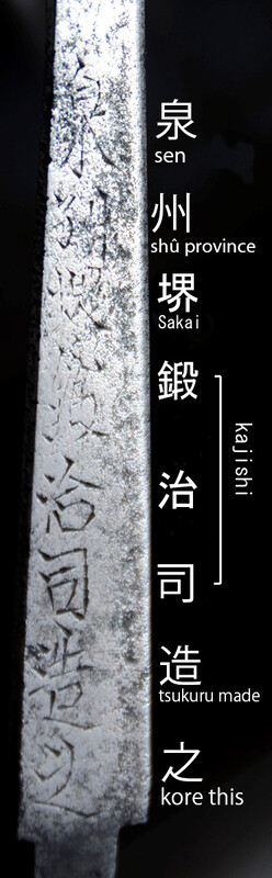

Hey guys,
I have this kogatana that came with a koshirae set. Morita-san graciously translated the inscription as: 泉州 堺 鍛治司 造 之 (senshû sakai kajishi tsukuru kore).
I researched this inscription and arrived at: ... in Sakai city in Senshû (Izumi) province made this.
鍛治司 gave me some issues. This can be read as kajishi, but also kanuchi tsukasa. Kanuchi tsukasa translating to “Smith’s office”, with some references adding a note as to the imperial smith’s office with this name circa 7th to 10th century in the Ritsuryō system of ancient Japan. Also to note that kanuchi was most of the time written with 冶 instead of 治. 鍛治 is aparently an archaic form of kanuchi?
I have found similar inscriptions like these on kogatana on the web, however they were written with saku instead of tsukuru, which isn’t quite the same...
So anyway: any ideas what this inscription means? Were these kogatana “mass produced” by the smiths office of Sakai, or was there indeed something imperial involved? Sakai was a big city back in the days with it’s important port and knife/sword/gun making industry. Has anyone come across one of these before?
Greets,
Robby

Under the administrative code of the ritsuryō 律令 system, the kajishi 鍛治司 was the "smithery bureau". But that's about Nara period, I don't know if it was used later on. Also, (no) tsukasa 司 was a court rank. FWIW ... :cry:

and  are different.
so, I think,
泉州 Sen-shu (Izumi no kuni province/Southern part of Osaka)
堺鍛 Sakai Kaji (smith of Sakai city)
治司 Harushi(ji) Smith name
造之 Tsukuru/kore (kore wo tsukuru)/ Made by
Made by Haruji the smith of Sakai in Senshu...
